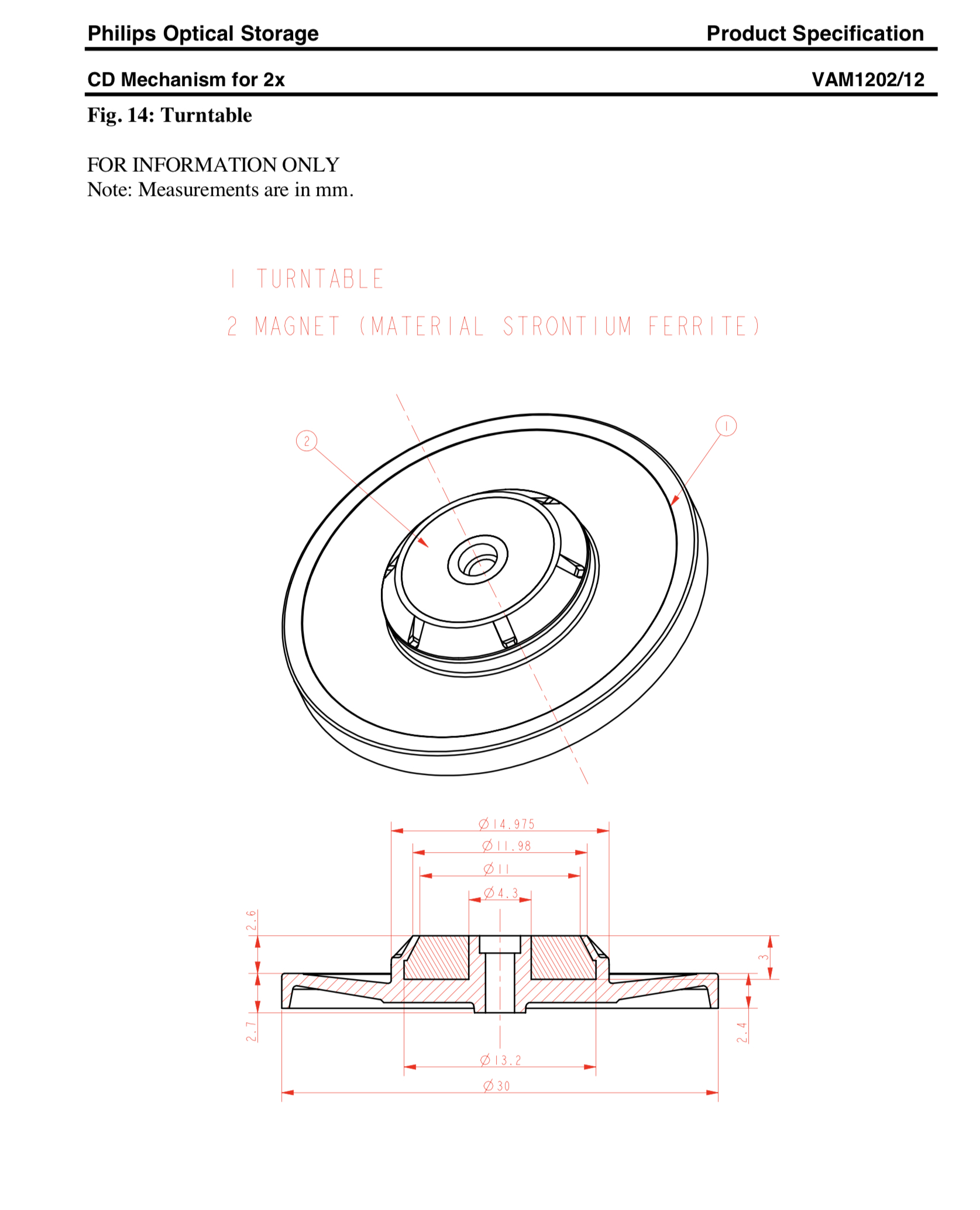

This shouldn´t happen, as Philips as disctables have strict guidelines.
So if it really was a VAM1202, maybe the magnet in the disctable is missing?
It's a long time ago now but I seem to remember back in the day when I was changing these for a living there was a point that Philips when supplying the Traverse Mech as a Spare part supplied a new Clamper as the design of the platter changed.
Maybe you have an 'original' Clamper and the new Mech (original Philips or chinese copy?) is of the new design?
Maybe look for a new-ish Player, broken on ebay, which may have the new design Clamper?
