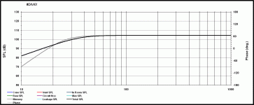

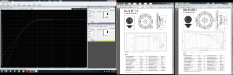

I just did some sims in winISD
Pink Trace : 2 x 8” SB23NRXS45-8 in parallel.
- 120 Liter Vented
- f3 ~ 32 Hz
Yellow Trace : 1 x 12” SB34NRX75-6
- 100 Liter Sealed
- f3 ~ 35 Hz
The 8's dont want to play nice in a sealed box unfortunately.

Just looking through the Visaton range now and doing some sims.

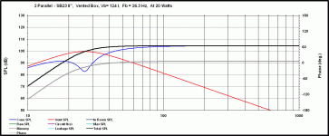

the 8" is good, but to be brief, the 12 will give her what she wants and probably more with the right amps.
another option is ucd400 from hypex, as they recently became very affordable 🙂.
the 8" need at least 80L to play low. the sim showing dual sb23 in a 125L. u'll need less watts to get the same SPL, but the thing is the A7 is lower sens than the dual 8, so at the end u'll need to pad it down, its still a good thing though to have more on bass.
It still seems like a much more elegant solution to use the SB34 and go passive...
