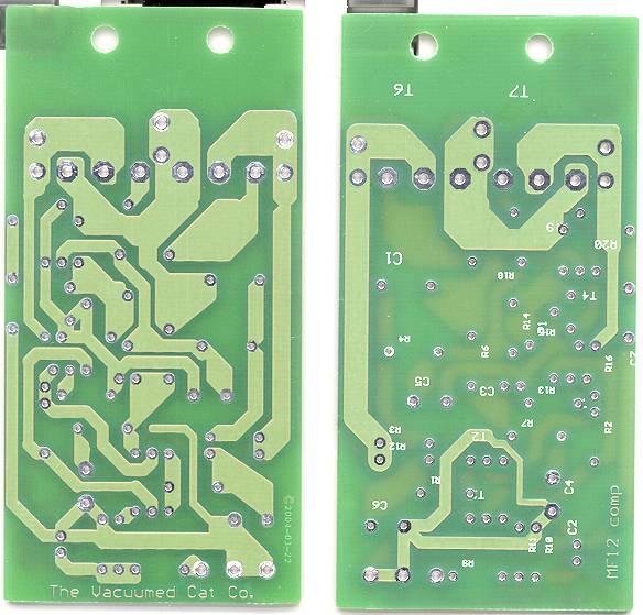

Boards complementary mf12
New Boards in, one pair in the mail to Brian.

Theese boards are available for Diyérs who would like to use professional quality plated throug boards. Boards are 70u cu.
I´ve no comercial interest in this, i´ve paid 60 SEK per board, roughly 8 US. I´ll send a pair to anyone interested, if receiver wish i´ts ok to send reimbursement, or something fun.

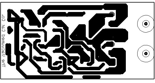

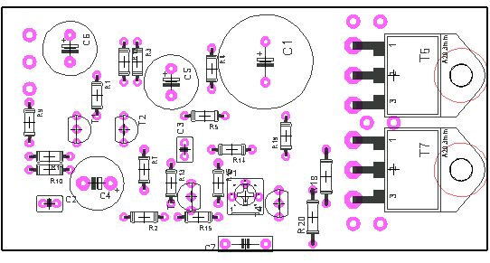

Hi!
Inspired by these discussion I made a small single sided PCB layout for MF12. You may download the layout from:
http://www.diyaudio.com/forums/showthread.php?s=&threadid=134&highlight=citation+12
