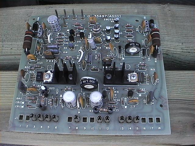

I have an old sitation sixteen now.
I only cant find the ic your talking aboud on the driver board. My serial on the driverboard is 00133497(assy)
At powering up and shutting off my speakers move in and out slowly .( maybe the relay doesnt work ?? )
One channel has a 200 mv offset the 1 M ohm pot seems ok
anny aditional info on this type off driverboard ?

You either have a Citation 16 II, or the driver board from a 16 II, which uses discrete circuitry instead of the opamp.

rofl, discrete circuitry???? lol, then what's that little metal can (AKA op amp) in the board at the input??
It appears that they elected to use a different style of package for their opamp in this design, and the transistors are sinked, (mine are not.)
I'm in the process of modifying my boards to be entirely descrete though, which might be a nice improvement since I could remove a lot of the RF filtering around it.
Anyway, definitely that little can with eight pins would be your opamp in this board. It probably works in exactly the same was as mine.
(CORRECTION) It seems I was having a bit too much fun eating my foot there. At a second look at the picture, I realize that the can is simply a dual transistor. Which would make the amp discrete.
Sorry for the confused mess. lol

the can is a 2N2916
45V Vce, 0.03A Ic, 60MHz NPN bipolar transistor

I have a old song here whit a offset . When i change volume you can see my speakers go in or out to correct the offset giffen by the input .. hmm
Maybe it also has to do sompting whit my error . The feedback loop isnt seen by the driver pcb
or is the feedback loop somthing completly diverend compared to the zerro 1 M ohm pot ?

Hi mischa,
You have DC across your volume control. Check the caps either feeding the control or to the input of the amp stage.

the 200 milivolt offset is always there .
speaker or amp doesnt get warm from it . The offset pushes the speaker 1 mm out al the time .. so that one has a smaller X-max 🙂

"First iam goint to check all connections and put in some new xlr,s and speaker binding posts. then ill try again"
I don't think any of that will change the DC off-set.
I think either your diff pair is bad, or the cap in the feedback loop is going shorted.

Hi mischa,
I agree with djk. Don't change those things out until you solve this other problem. The feedback cap going leaky would do this, as would a bad diff. pair. I still think you need to check the input coupling caps. One really sounds like it's leaky. If you disconnect them and the offset drops you have found your problem.
