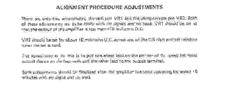

Citation Sixteen DC offset woes
I have recently developed a problem with my C16 amp,the model with the IC input stage. I noticed the VU lamp flickering on one channel at idle.
I've tried a new ua739, replaced the nonpolarized 10uF caps and switched the channel A and B boards. the problem travels with the B driver board.
I have VR 1 cranked all the way to the negative 10 volt rail and the DC offset won't go below 990 mV.
I suspect it may be one of the ceramic caps in the feedback network around the opamp. But what a pain to troubleshoot.
Anyone got wisdom to share?

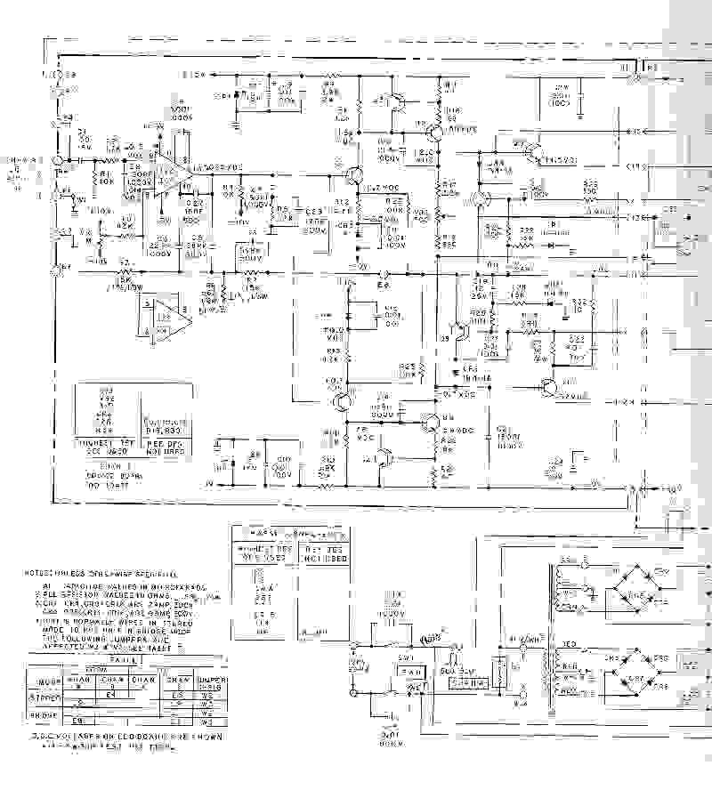

Solution to my bias problem
After studying the schematic and plotting the test points on the driver board layout drawing, I quickly found that the voltage on the emitter of Q1 was around 0.4 volt. The other four places I could measure this same voltage, Q2 and Q1/Q2 on the other board were at 0.7 volt. Guess I got a leaky Q1.
I got a handful of MPSU10s and 60s off eBay and measured the hFE. I took a U10 with a hFE of 74 and a U60 that measured 76 and stuck them in. (These puppies are going for $8.25 - $10.25 each.)
Perfect! The null current was easy to set to 9.5 mA and bias settled right down to the same value. Background noise is indistinguishable, even my wife can't hear anything! If you have the luxury, match the hFE of these babies and replace them in pairs.

Driver board schematic
Does anyone have the driver board schematic for the Citation 16a, the one without the Opamp ic? I cant adjust my null below 0.127v on one channel and below 0.082 on the other.

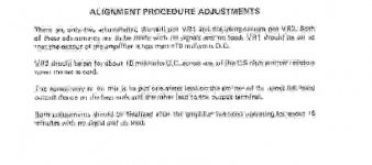

Citation 16a not able to adjust null
I found the drawing and replaced r10 and r26 because they are out of tolerance now I am at -.124 and -.040 mv respectively. I notice the voltage on one of the driver boards is -10.5 and +9.1 witch would explain the null pulled to the -. I gess I will replace the zeners cr3 and cr4 when I find them. Let me know if you think I am on the right track.
