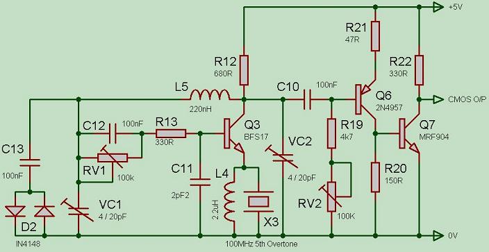

Many thanks for the buffer circuit; I took the liberty to redraw and combine the XO & Buffer the circuits. Do you have a description of the adjustment function of the various Pots?
Does anyone have modern SMD transistor replacements for the following devices (lower noise would be preferable) - The MRF is already very low noise: -
2N4957 PNP

Schematics seems OK to me. Note that the cheap BFS17 (Philips) I used is mine. Matthys' original is a MMT3960.... Couldn't find its characteristics on the web, so I'm not sure BFS17 is the right choice here, but it works... NF of BFS17 is not quite nice (6dB/250MHz if memory serves)
Tried to find equivalent BJTs in SMD, but very very hard to find something with NF as low as 1.5dB without having megabucks... Seems to me that Philips BFR92 (NPN) and BFT92 (PNP) could be a good choice...
By the way, I'm not sure nice NFs and nice linear chars are mandatory for the buffer. Wideband switching BJTs should be enough here. I have the PNP PMBT3640 from Philips in mind, or the MMBT3640 from OnSemi. Fairchild's MMBTH81 too... Dunno...
Adjustments in the XO are not obvious, but the L5/VC1 is dimensioned to operate just above resonance (Matthys dixit), and provides a phase shift of 120°. The C11 cap plus the resistor (R13 + VR1 (50K, not 100K)) adds a 60° phase lag, and finally the BJT adds a phase reversal (180°), closing the 360° loop... The "output" variable cap VC2 is used to tune out the shunting effect of L5 on R12 (load resistor).
Practically, I just tuned the adjustments to have the max amplitude at the right frequency...
And IMHO, RV2 is just a threshold level adjustment...
Last note from Matthys (hope you have your book soon, it'll all make clear), Q3's Hfe must be high (100) for the circuit to work. I know the BFS17 I used has a min Hfe of 60, but it worked...

Hi Cheff,
Cheers for the info, your right its not really clear what’s going on – especially with VC2 and RV1.
I searched the net, and found some interesting devices from Infineon. Planning to try the BFG235, it’s a low noise 2.7dB @ 60mA, 2W Transistor. “Large transistors with high Ic max used at low currents have best 1/f performance” – SIEMENS App Note #23
I guess the 1/f noise of the resistors will be the biggest noise source at LF in the buffer circuit – its kind of a balancing act between resistor noise and transistor Ic current – transistor noise increases as Ic increases.
I’ve also tried to find data on the MMT3960 with no luck, also tried MMT3960A, MMBT3960, MMBT3960A, 2N3960 & 2N3960A – but all too no avail. I did find a data sheet on the 2N3960 from Semicoa Semiconductors - but has only the bare basic information.
So I guess it will be Plug & Play Time....
Decided against the simple MC100LVEL14 due to, and I quote from EuroQuartz “Crystal theory” technical notes: -
“Cascade logic circuits, may show an appreciable lagging phase shift at the operating frequency. Even worse, is that in some circuits due to many non-linear active stages within these amplifiers, the lag is not constant over the operating cycle. The result is poor short-term stability or jitter.”
Well there you have it – I’m certainly not taking the risk! If the MC100LVEL14 had a simple internal path maybe, but there’s a selector in the path as well…

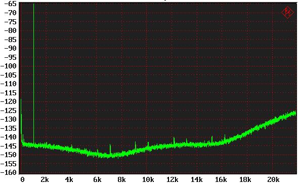

An update on the TI5015 modulator - I’ve improved the master Clock to the modulator, which as a result has lower the noise floor. By observing the 3 “humps” on the noise floor - you can clearly see that TI has adjusted the Poles and Zeros of their noise shaper to spread the feedback power over the audio band. This explains the excellent 19KHz / 20KHz 3rd order IMD @ -115dB – better then any amplifier - Analogue or Digital that I’ve measured. :headshot:
Dynamic range Awtd is now 114dB and THD @ 1KHz 0dB is 0.00004% - all this at 384KHz PWMFs – very impressive! :superman:
I found that a good test of the clock phase noise performance is to observe the Single Ended noise floor with the modulator Muted – i.e. with a 50:50 output Duty Cycle. While this will not reveal any clock modulation due to cross coupling while the modulator is operating, it does give an indication of the basic phase noise performance of the clock.
Due to the poor stop band rejection of this modulator – I recommend anyone who wishes to implement it, to up-sample to 200KHz with TI’s 4192 SRC, and thereby gain the advantage of the 4192’s 140dB+ stop band rejection.
Below is a 16K FFT @ -60dB Ref. 0dB – with the improved clock – notice the three “humps” on the noise floor.

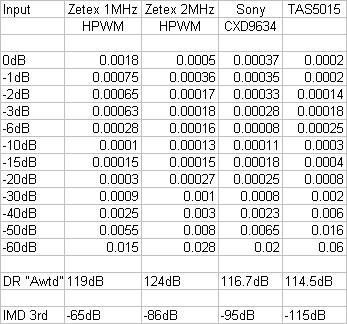

Thanks for all the info.
Just a quick posting, of THD, Dynamic Range "Awtd" and 19KHz / 20KHz 3rd Order IMD results of 3 Modulators.
The Zetex 2MHz HPWM Dynamic Range result is limited by Phase Noise, the others might be about 1dB to 2dB worst due to Poor Phase noise performance of LVDS TX / RX I used on my Eval Bd.

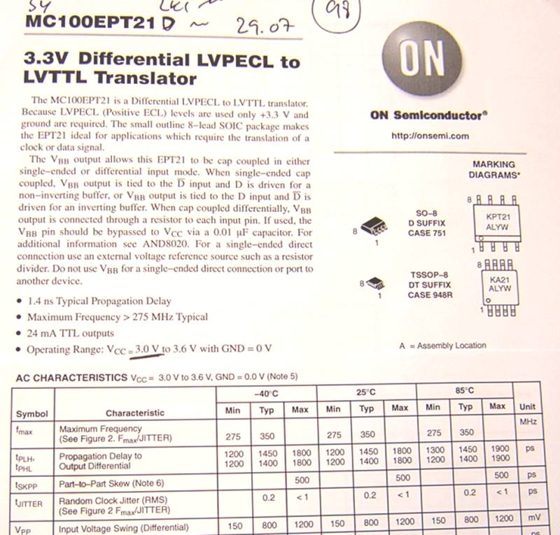

Another way of ....
... converting the sine wave signal from a crystal oscillator, to square waves, that can be transferred jitter free to a digital circuit.
The MC100EPT21 is a (balanced) PECL to TTL converter, or in other words a balanced comparator that converts a small analog signal to a square wave output.
Look at the jitter data, and speed ..... :)

Never did like using a comparator for XO -> TTL, they suck.
I think a clipped transistor circuit is better however this looks
V good. Do they do a 5V TTL version?
Terry
