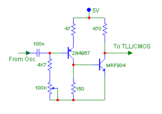

Still will need good Buffer Amp –any ideas – pointers – CIRCUITS! Anyone?

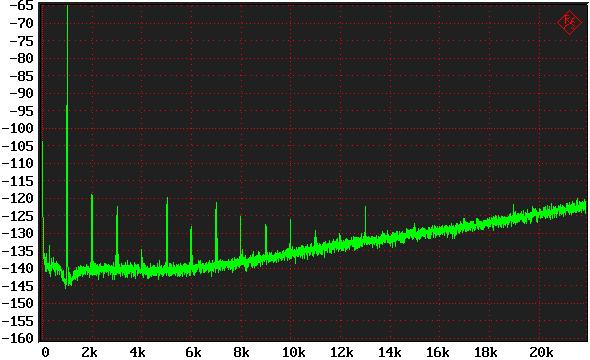

The measurements where performed using an R&S UPD5 Audio Analyser in 16K FFT mode, which results in a FFT Bin size of 2.93Hz. In this mode, the noise floor of the analyser is about –155dB (Ref to full scale 0dB input). The Zetex measurements are analyser Noise Floor limited at lower frequencies.
The outputs of both modulators have been re-latched to an External Master Clock, 2048Fs for TI and 768Fs for Zetex. The outputs from the latches are then buffered and LPF - then feed balanced to the UPD.
Despite the LPF, both the UPD and Audio Precision system II’s have a great deal of problem with “RF noisy” input signals – this is reason I posted the Thread “AES17 filter schematic” asking for circuit diagrams.
Audio Precision sells an AES17 filter set – for around $1700! I have there AUX-0025 Switching Amplifier Measurement filter, but this is only of limited use without the AES17 filters, as it only really start to work above 200KHz and is designed for sub 2Ohm input impenaces – from Output stages.
With the Re-latched TI5015, I already achieve THD @ 1KHz of 0.0002% at 0dB see FFT below - Ref. 0dB (the fundamental is notched by about 30dB by the UPD). The higher noise floor on this 0dB FFT compared to the earlier –60dB is due to the UPD.

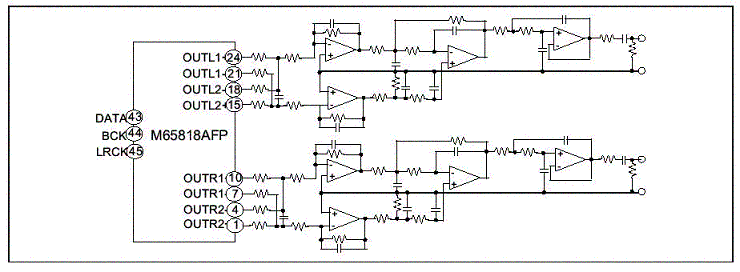

Hi John,
If residual response of your setup (with no signal at input) does not show any LF noise then I can only help by posting link to Tripath Application note 4 that has schematics for low pass filter they use when evaluating their designs.
Alternatively, this is the picture of filter used by Renesas when characterizing M65817AFP.

Hi All,
Thanks for the latest information. I have characterized the CXD9634 / M65817 under the same conditions as the TI / Zetex. It’s a good modulator, better then the Zetex, but not quite as good as the TI. It has a THD @ 0dB of 0.00037% and an Awtd DR of 117dB. It has a very good –30dB THD result of 0.0008%. 19Khz / 20KHz IMD 3rd order is poorer then the TI @ about –85dB (sorry for the earlier result of –105dB).
One thing to note, if used in default power up mode (no Micro) then the gain is set to –5dB. I found no mention of this in the data sheet. I also used AC dither “A” as the others had an impact on SNR. I also found it to be the best in THD terms – but I didn’t check the IMD results….
The filter schematic shown is from the Mitsubishi data sheet, shame they don’t publish component values or any frequency response curves.

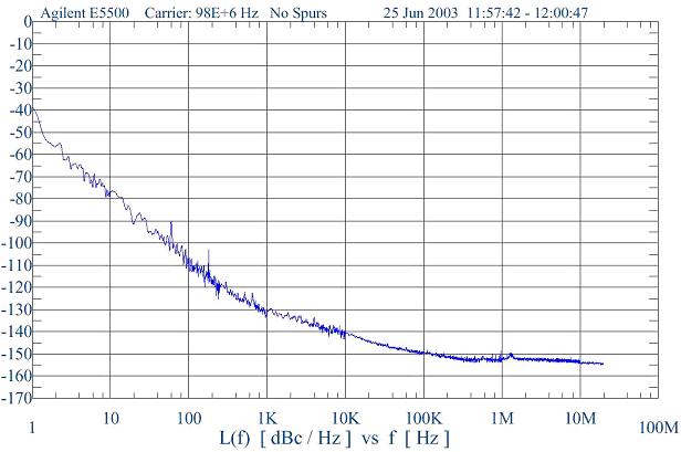

Found a device that looks promising, the P661 Family from PhaseLink Corporation. It has a phase jitter of <0.25pS (12KHz to 20MHz) & an RMS period jitter of <2pS (less then 1 AC logic gate!)
Spoke with the designer tonight, and we believe that there’s a fair chance of reducing the 10Hz Phase noise. Possible contribution to the phase plot could be from the RF Synthesizer used in the test set-up (very likely) and the PSU (also very likely).
Also an option to use a 5th overtone Crystal with its sharper Q.
If this device performance can be improved at 10Hz, then it looks like the ideal device as it easily meets my budget targets, and comes in CMOS and PECL flavours.
Anyone able to beat this?
Below the Phase Plot of the P661 @ 98MHz

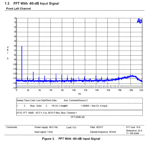

Hi John,
I am sorry I can't help otherwise, but there is a picture from TAS5076-5182 Evaluation Board Application Report . As you can see, they show no LF noise, and the same is with all the measurements that TI posted in their literature for other modulators. They use off board clock in their evaluation module, multiplied by internal PLL. They seem to use "TI Input PC-Board" (no specification given) as clock source. As they seem to measure 20Hz-20kHz, does that mean that your noise is below 20Hz?

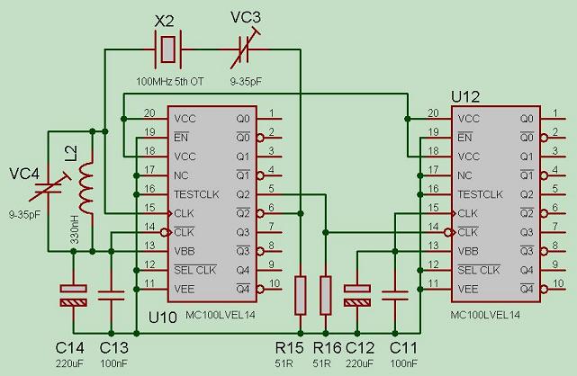

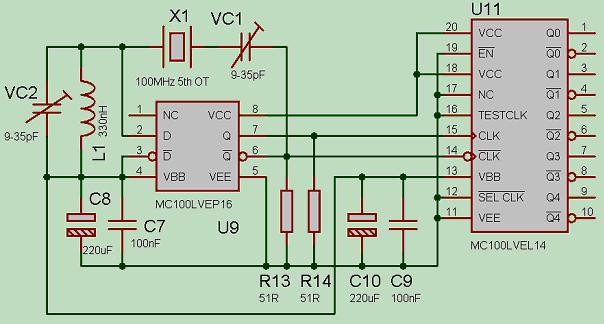

Unless I can find better, this is the circuit I plan to use for the first version of my 100MHz CLK (as I don’t expect to see Matthys book for at least a week). Its based on a circuit from Euroquartz – App note “Oscillator Circuits”
The newer Motorola PECL families claim typical cycle - cycle jitter of 0.2pS. I have no idea what this equates to in PK-PK RMS terms?
I’ve connected both VBB's together, in the hope of making any noise on these internal Ref. Nodes Common-Mode. Until I construct the Oscillator, I have no idea if this a good idea, and what the noise the Noise Spectrum looks like.
It based upon a standard Pierce Oscillator. Its claim that because neither side of the Crystal is referenced to Ground, that the Pierce Oscillator has higher Phase Noise then other Oscillator types (SaRonix App Note “Basic XO Design”). Can anyone Pls. shed some light as to why this might be the case?
Hi Jaka,
The 140dB DR (claimed) modulator is not the TI TAS5508 – they only quote 100dB. Thanks for the link; I was not aware of this device.
If you compare the FFT plots, you will see that the TI’s LF noise floor is only -134dB, where as my TI5015 NF results are about –142dB – about 8dB better. In addition, the TI has bad distortion at –60dB (its almost as bad as my 115W 8R results!), where as with my –60dB, there are no visible distortion spurie.
On the TI FFT you can clearly see the Roll-off starting at 20KHz due to the AES17 filter – anybody have a circuit Pls?
The TI 5015 internal Digital Filter has poor Stop-Band rejection. One advantage of using a good SRC is that they normally have better then –140dB stop band rejection – this might be the main sonic advantage of “Over-Sampling” DAC’s using SRC in CD players. To save on silicon area, most integrated DAC’s these days have very poor Stop Band rejection.
I would recommend running the TI at 200KHz using the TI SRC4192 (to prevent aliasing products with SRC never operate them at an exact multiple of Fs).

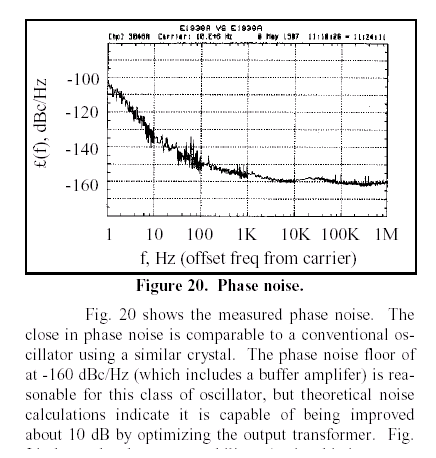

i'm no xtal osc expert but some time ago i ran across this which might be of interest:
http://www.karlquist.com/97bri.pdf
i believe this is a 10 MHz "SC" cut xtal, if not relevant then at least the refs might help
another, perhaps unrelated topic to explore is "inverted mesa" crystals, though the technology may be commonplace nowadays - vacuum and Al electrodes also contribute to high Q

Modified my earlier Clock circuit, by reducing the number of gates in the signal path. The oscillator is now based around the 1:5 clock distribution IC, guess you can’t get simpler then that. As Phase noise is additive, I hoping that by reducing the number of IC’s in the path - will result in lower phase noise.
The MC100LVEP16 might be a better oscillator then the MC100LVEP14, but as the MC100LVEP14 would still be in the signal path – would it matter? With the new circuit, at least any noise contribution from the MC100LVEP16 is eliminated. The outputs from the first XO MC100LVEP14 are feed to the Primary Latches (lowest phase noise) & the outputs from the second are feed to the Pre-Latches & system.

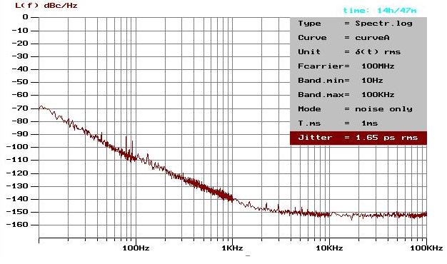

Well, as a start I was thinking of ordering 20K Pcs per year, any Crystal manufactures interested: - 100MHz 3rd of 5th overtone SC crystal?
Here’s the phase noise of a commercial Overtone design - Low jitter 100MHz XO module, worrying to such poor results at LF offsets.

Dunno if it's still relevant, but I just came back upon Matthy's papers I have on EC XO. Here is the buffer he proposes. I haven't checked for the availability of the BJTs used, but we can sure find replacement parts. I haven't tested it, so don't know how it measures in real life...
Just a quote from Matthys about this XO :
"And at 100MHz, the crystal's in circuit Q is 84% of the crystal's internal Q. These are relatively high in-circuit Qs, which should give good short term frequency stability, and they do. The short term stability of these circuits measured 0.1 ppm, at the limit of available measuring equipment. This stability is better than that of any other harmonic circuit tested."
(That was in 1987...)
Just my
Just my
