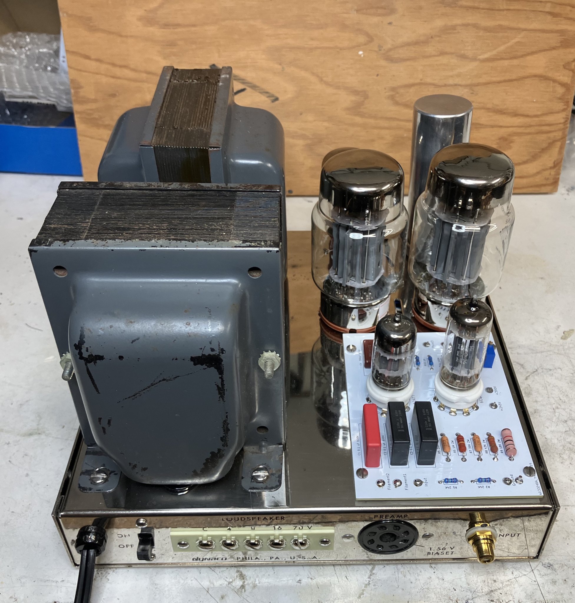

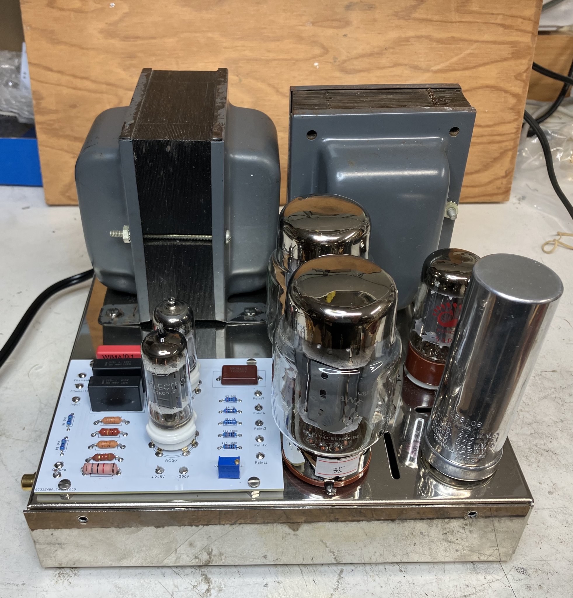

Anyway, as you can see from the pictures, the first of the two amplifiers is together and looking very pretty indeed, scratched and scuffed transformer endbells notwithstanding.

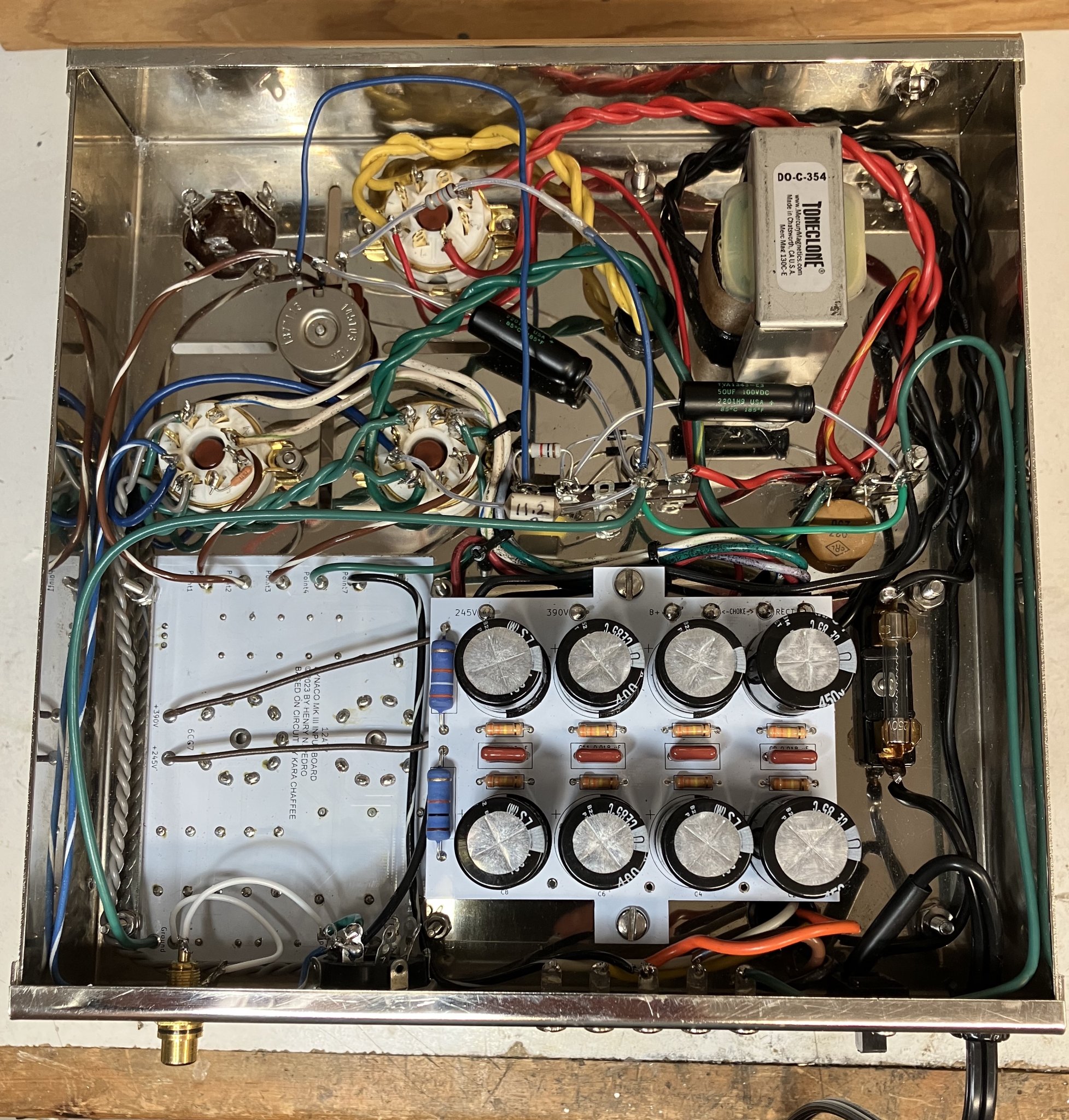

Initial testing went as follows - the initial power up was uneventful. Nothing went pop and the tubes warmed up as expected. Voltages came up and were near the nominal values. At first. But as it continued to warm up the B+ voltage settled in at 551V instead of 480V as it should be according to the schematic. The KT88s could go to their expected bias point of 1.56V at the bias resistor or 70 ish milliamps per tube.
The problem is that this is way too hot. The plate voltages were way over 525V and this puts the tubes into motorboating oscillation, way too much gain and early distortion.
I can turn the bias down to say 0.6V at the bias resistor or 2.5 mA per tube and the amp settles down a little (and starts to sound a bit better) but this isn't where the design points are. Not to mention that because it's an unregulated supply, things need to be just right voltage-wise and since the B+ is to high, the input and phase splitter tubes are also running too hot.
So I did a little probing and there's a 4.3V drop across the choke, which has a 62.7 ohm resistance, so that works out to 68.58 mA running through the choke at idle. And the supply is 71V on the hot side. So I want to drop 71V to get it down to 48V.
Some quick ohm's law figuring on the calculator says if I stick a 1035 ohm resistor in line with the choke I should be able to drop 71 volts at the 68.58 mA it's delivering. But dropping 71V across a resistor at 68 mA is 4.8 watts, so I'd need at least a 5W resistor or better.
Does this make sense to you guys? Would putting a 1K 10W resistor, say, before the choke do what I need it to do?

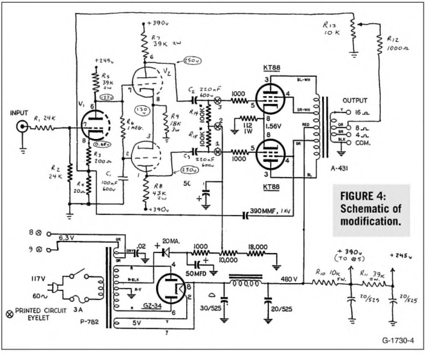

Are you certain you don't have the overall phasing causing positive feedback? The boards I recently used for my Mk2's required crossing over the phase inverter stage to the opposite output tubes since there are a different number of stages in the circuit than the original. I had some funny things happening like you are until I realized this. You can be certain by measuring the output voltage using a known input voltage and then opening the global feedback. If the output voltage goes up then you have negative feedback. In my case I saw the output voltage drop when opening the feedback so I figured the feedback was the wrong polarity. I also had trouble getting a stable and correct bias current.
It would help if we knew the schematic.

I settled on reducing the stage 1 capacitance - from 41 uF to 34 uF and that dropped the voltage a little, allowing the use of a smaller in-line resistor (see my post above)
