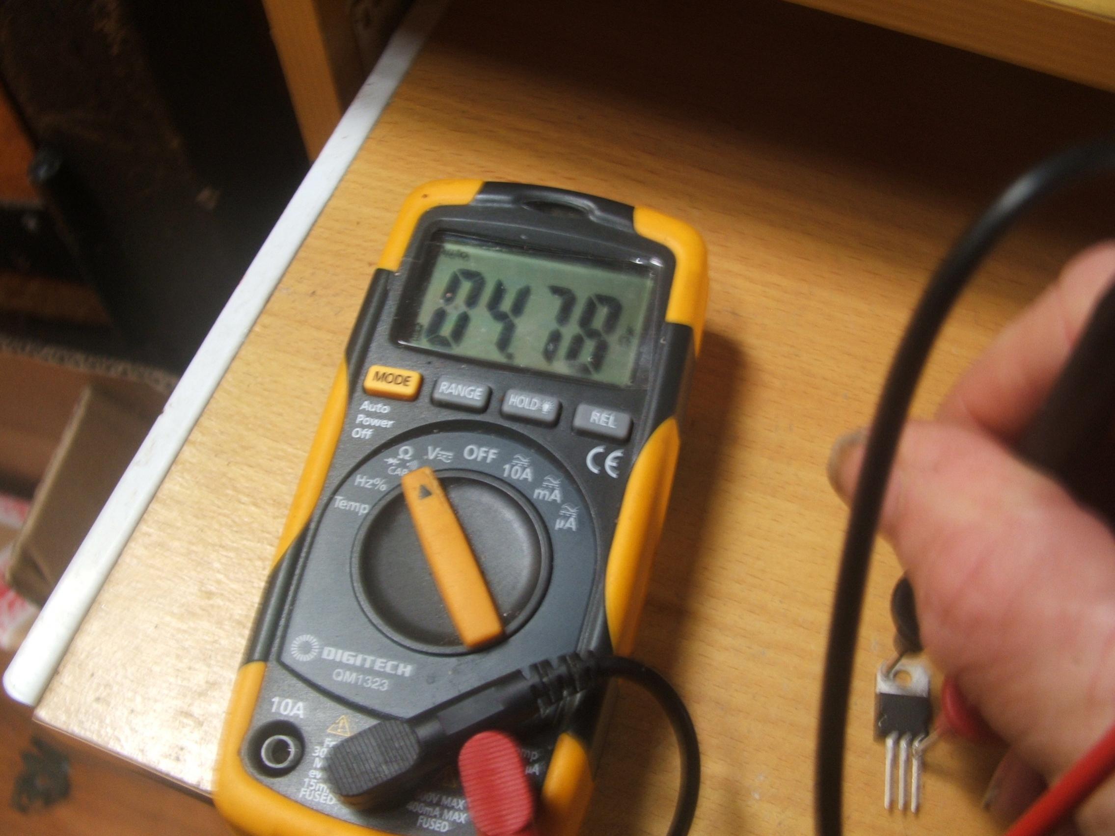

For the readers benefit a 78XX has a internal fixed resistance between its output and ground. See image
The 78xx device has extremely good low output impedance to easily drive that resistive load , however the resistance between anode and cathode is still there, it does not magically disappear because the output impedance of the device has ability to easily drive it , hence remains as a added parallel resistance across the anode and cathode, when used per Post 127's schematic. The 78xx must preference its own internal resistance, in this case as a load of 10.4ma - instead of the more sensitive LDR .
Instead if we remove such parallels including capacitors and potentiometers
a audio purpose LDR improves its ability as an attenuator immensely.
Just listen to one vs the other - its quite apparent.
No. To the extent that your explanation is intelligible, it is wrong. The output impedance of the regulator is it's "resistance to ground". But again, a red herring since none of this is meaningful for a simple LED control.

Oh my. The 7805 is a constant voltage source with an outout impedance of about .008 Ohms. You do the math, I'm sure you can figure out how to manage current less than 2mA through an LED and a series resistor. People do it every day. And, again, I ask for your measurements of signals passed through the LDR (the resistor, not the LED) controlled by a voltage regulator and potentiometer vs your magical circuit. Show us a difference.

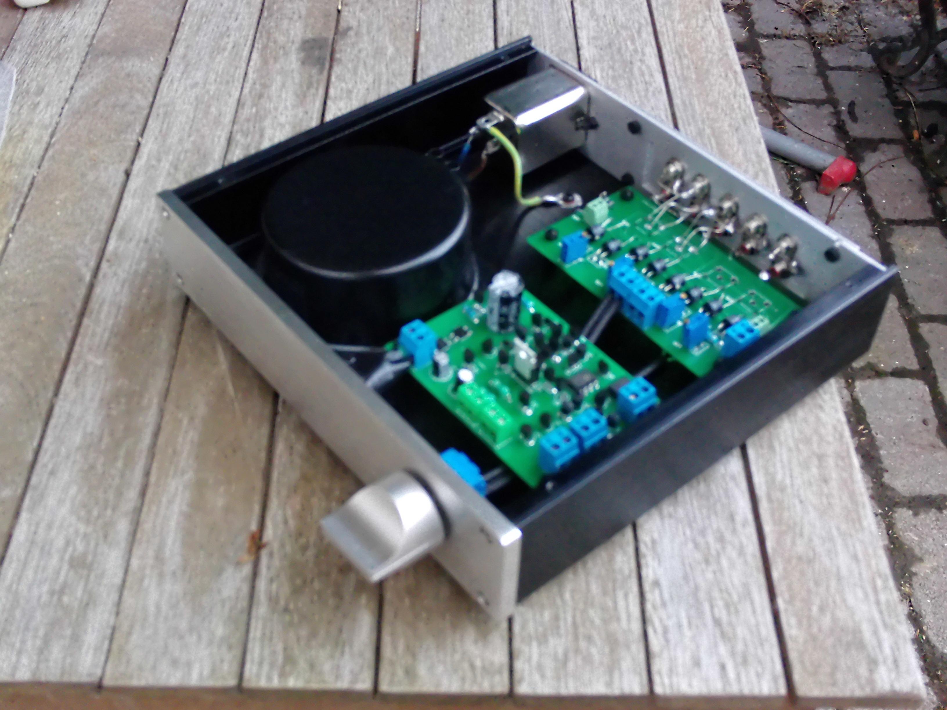

I too look forward to the difference being shown. Its not a magical circuit, it
has just been patiently developed to provide the best audio possible from the NSL32SR3 using a current source and current sink.
You are welcome to hear in the mean time -the difference it can make.
This internal resistance which you are fixated about is in parallel with the much much lower output impedance of the 78xx regulator so can be ignored. It does not appear in parallel with the anode and cathode of the LED because there is a huge variable resistor in series with it. So you are fixating on something which is utterly and totally irrelevant to how the LED is driven. Why you persist in this is a mystery. Unclear to me whether you are genuinely seriously confused about basic electronics or merely trying to blow smoke in the eyes of potential customers.
If you understood electronics you would know that you don't need a current source and a current sink, even if CCS drive was superior as you claim. So which of your two is working as a CCS and which is on the end stop and working as poor voltage source?
