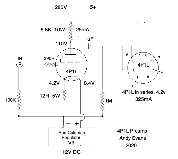

Andy, can you point me to the thread with the schematic that I can use as a starting point for the dht?

https://www.diyaudio.com/community/threads/4p1l-dht-line-stage.190857/page-93#post-7233397Andy, can you point me to the thread with the schematic that I can use as a starting point for the dht?
Here's a typical schematic. Look closely at it - it's in what's known as "filament bias". The filament supply goes through the cathode resistor, which is why it's small. You will need a pair of economically priced V9 filament regs from Rod Coleman at Lyrima. He will supply all the build details you need and answer any questions including heatsinks. The filament supply is separate for each valve, so 2 supplies needed which are floating. You could use a 12+12V transformer at 25VA or 30VA for instance, then dropper resistors to get to 12V each valve. Many people have built this kind of line stage in filament bias, which has become the favoured method for DHTs because it has no cathode bypass cap. Output impedance should be around 1.5K. 4P1Ls are cheap and available, mostly from ex-Soviet European countries.

I do have the class D modules already. It's the Orchard Audio Starkrimson ultra. From your DHT adventures, which would be most suitable for "tube buffer" or just couple db of gain? Also, not too microphonic, and affordable? I read that the 4P1L is very microphonic, and have you found that to be true?
The 4P1L can be somewhat microphonic, but not "very microphonic". It needs a solid non-resonant enclosure. I used 4mm aluminium top plates. Others have used damping. It's something that can be controlled with the right kind of attention.

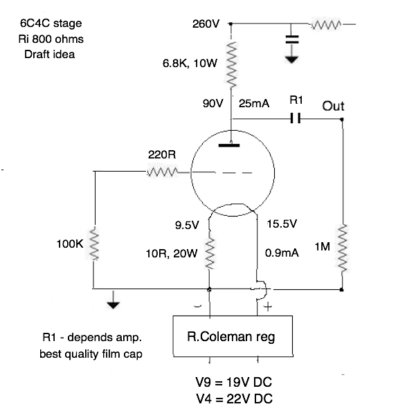

If it were me I would use a 6C4C in filament bias. That's a Russian 6B4G, a 6.3V version of a 2a3. Again, Rod Coleman V9 regs. This is a very good sounding valve made by Svetlana. It will sound better than a 4P1L but not by a huge amount. It requires an overkill construction with a large heatsink for the regs and the cathode resistors will get very hot and need to be mounted on top of the chassis. A 2a3 could be used with a cathode bypass cap, but if it were me I would use filament bias because it sounds cleaner. I attach a schematic, but this is a more advanced build. Worth it in my opinion. But the choice will be up to you. There are many simpler designs, like the 4P1L for one.

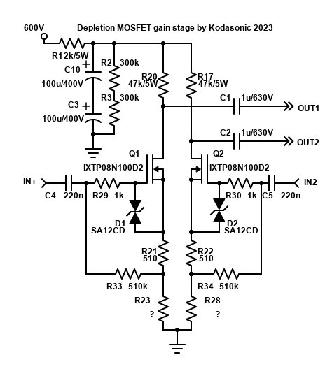

The only reason I've never done "measurements" is I've been to lazy to set up REW... I figure if the scope shows a clean sinewave at 100V, at 5V it'll be just fine. Nobody seems to design a solid state stage with that much headroom even though I've done it with IXTP08N100D2 depletion MOSFETs...
EDIT: Here's what I came up with... gain is ~ 60 with R23, R28 = 0R. Gain is ~6 with R23, R28 = 2k7

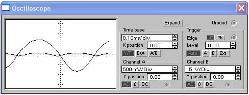

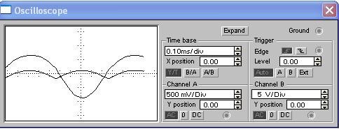

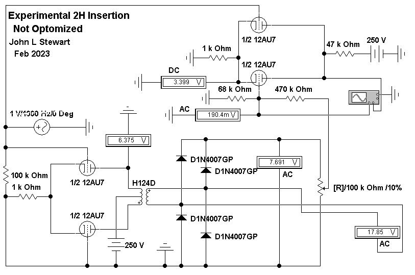

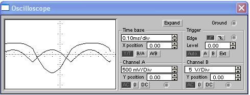

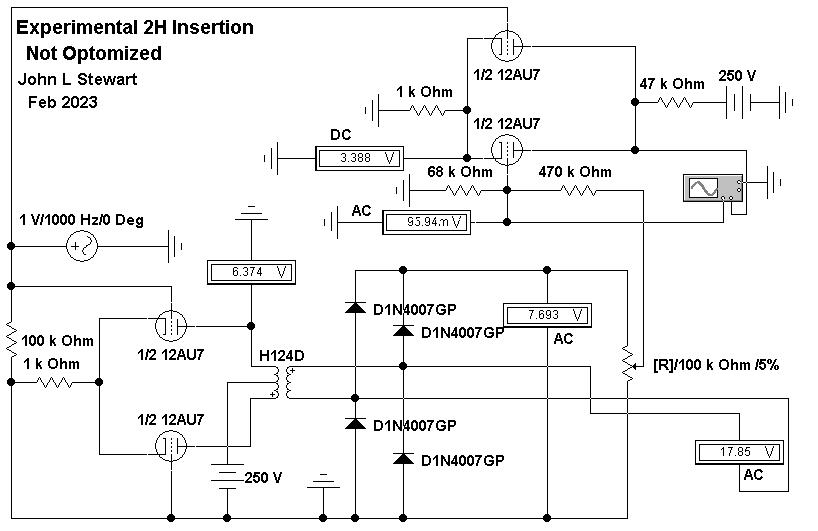

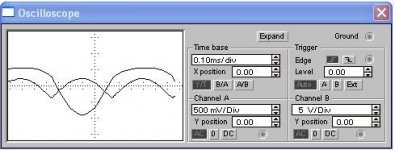

I've read the many discussions of the 2H thing over many years.
At some point I thought someone might build a circuit to quantify what is happening. Today I figured time to try something.
I'm not now or have ever been a critical listener. Now at 90 my left ear is shot. Biking at -10C didn't help that at all.
No more biking, to dangerous here anyway.
As I put this flight of imagination together I'm listening to Frank Sinatra during WW2 on the local Jazz station.
And quite a bit of Burt Bacharach tonite. I like Bach & Rock. Anything but C&W!
The cct mixes the clean signal with various amounts of a 2H signal generated by a side channel.
The signal also includes a spectrum of even order harmonics (4H, 6H, Etc) , just as toobz do.
This thing is not optimized but does demonstrate how adding 2H deforms the original.
The scope traces are keyed to the various schematics.
All something to think about. Others here may want to try something.

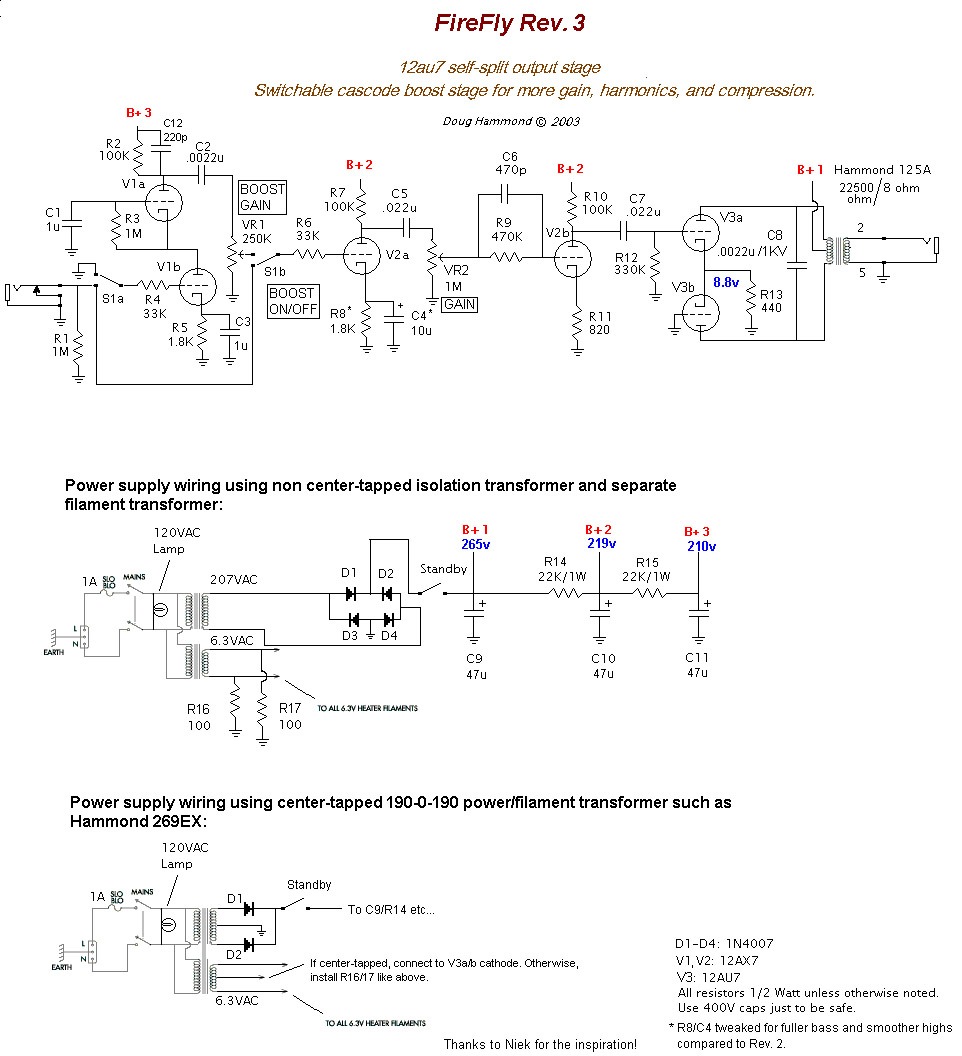

I've included two other examples of growing your own 2H, etc. Doug Hammond's 'Firefly" is a guitar pedal.
The other effort is a bit strange, the designer has gone as far as using a SS tail on his driver. Why bother, just leave the R tail,
that way more 2H. But then the PP output stage cancels most of that anyway! 😱
