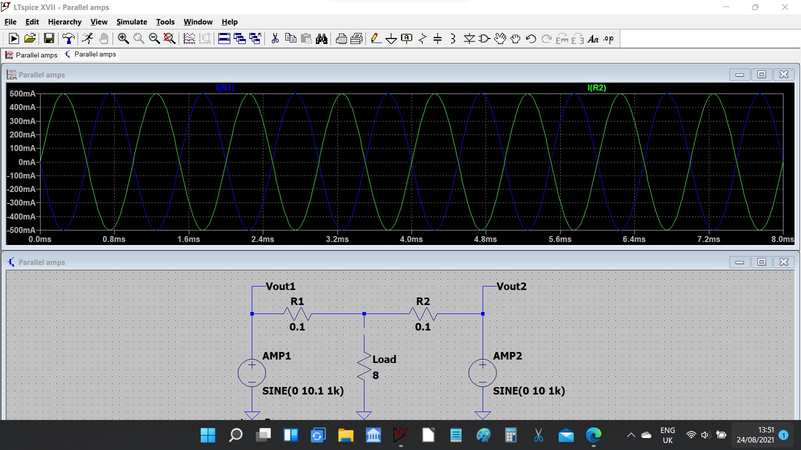

Look at this simulation.
Two identical amplifiers (NO load attached) and we are looking at the current flowing between them. The output is a 10v peak sine. NO circulating current flows because both are identical.

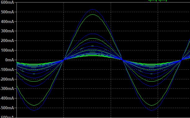

Second image has 0.1 volt difference in output between the two amps. Now look at the circulating current as the amps 'fight' each other.
Look at the scale in the first image. Femto amps. There is no measurable current flow because both are perfectly matched.

This is what the sim shows for a selection of resistors from 1-10 ohm using a 10v signal with 10% error:
So 10 ohms seems to be quite effective.

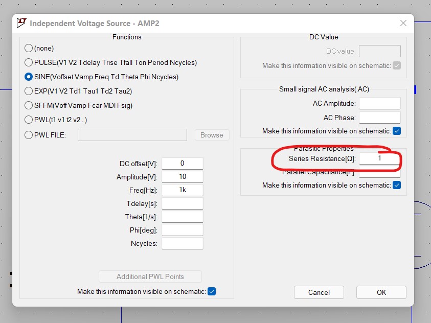

Remember that an unknown is the output impedance of the actual amplifiers themselves. The sims are' perfect' voltage sources unless you add a little resistance.
