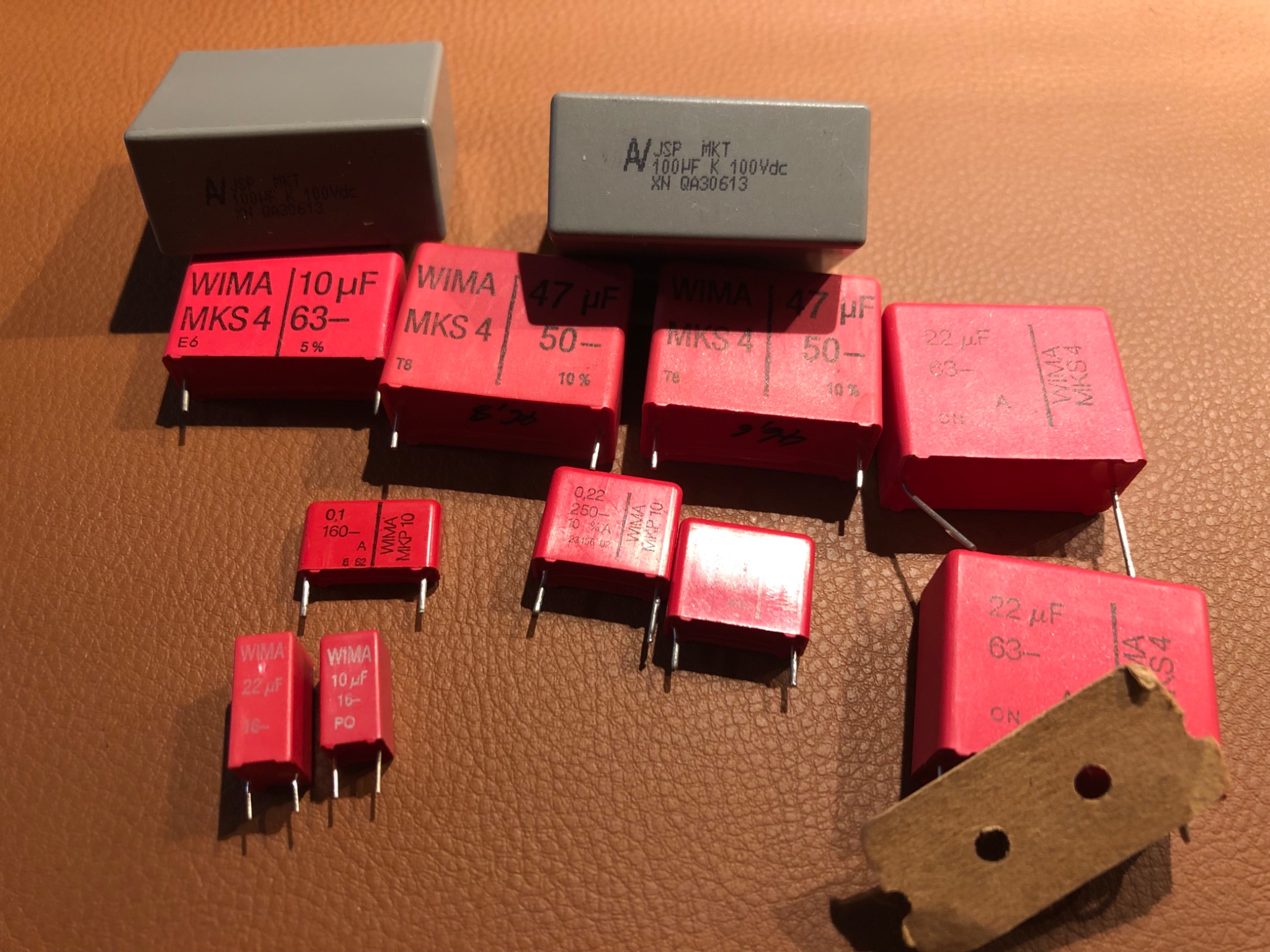

When I was in my late 20's and early 30's with some friends we build all kinds of amps. At that time we all had perfect hearing. The input/ DC blocking capacitor was quite a theme at that time. We agreed on one amp version and did all kinds of tests. We had already learned quite a few things. With audio testing, a quick change of the DUT's is important, if you need 30 seconds to change wires, subtile differences are already gone from your memory.
We all agreed the cheap electrolytics sounded inacceptable. To cut it short, in the end we decided that a 100V Wima MKS was the most convincing capacitor. Something like a base line we all could agree on. Some exotic parts sounded just as good, maybe a little different, but some motor capacitor, half the size of the audio PCB looked a little odd.
So if you are undecided, get a real WIMA MKS and you will be in the upper region of "capacitor sound" for sure. They may not be the best, but sure reach near 99%.
Just an anecdote: Because the high end manufacturer BURMESTER used this type in his products, in the beginning we all were biased against the WIMA caps. Almost all audio manufacturers with cult status used something else, more exotic and unaviable for input and coupling caps, so we thought they must know better. In the end we had to agree to Mr. Burmester.
Today there are even some very good sounding electrolytics I must admitt, but because of their limited live time, I still don't like to use them. In fact most problems of older amps and speakers are caused by them ageing.
These days I'd suggest Wima MKP4 which work very well for me: metallised polypropylene film, epoxy-potted in a rigid case, compact format up to 10uF in the low-voltage ratings suited to coupling caps. My go-to.
Wima meanwhile understands how to do audio talk:
https://www.wima.de/wp-content/uploads/media/WIMA-Audio.pdf
A 10 uF 63/100V MKP4 is about 22.5 mm larger pitched than a 5 mm pitched MKS2 10 uF 50V. If one has the space of course choose theoretically very best/largest/closest to ideal if the budget allows. In todays electronics space is often limited. Retrofitting film for electrolytics is very often 5 mm pitched. Also when RF is around that better larger cap may not be a better performer.
BTW it pays off to use the outer foil side to lowest potential. This is the side with the stripe usually.
