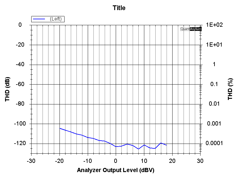

Have you measured different capacitors for distortion at all? I suggest that unless you are prepared to do that and find evidence you don't have any right to claim what you are claiming, its just baseless assertions. I have measured a range of capacitors and PP is definitely very linear, mylar less so, type II ceramic very very bad indeed(*). In fact I found allegedly "PP" capacitors from eBay that are type II ceramic in a plastic case, very evident from measurements, and subsequent disection.

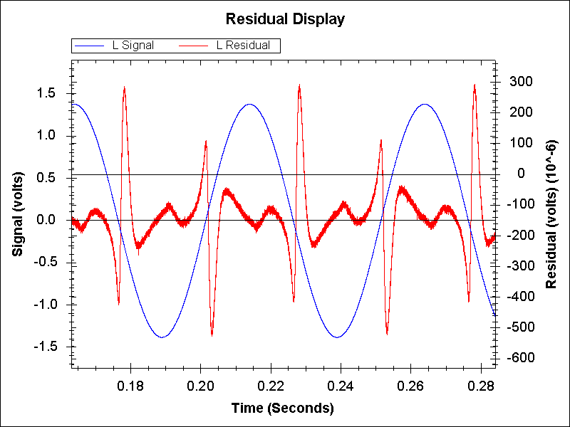

(*) type II ceramic actually have cross-over distortion, not just odd-order harmonics, as evident from their residuals:
This actually makes sense when you realize type II materials are ferro-electric...
Here's a plot from a PP film cap, basically down at the noise floor of my QA403 analyzer:
True. However, IMHO and IME @anatech is correct about antenna effect with large body caps. Sometimes squeezing or tapping on large caps can also have some effect. Its not just about dielectric material properties. Nor is it just about easy-to-measure nonlinear distortion. This has been proven to me time and time again.Thickness doesn't affect dielectric properties...
