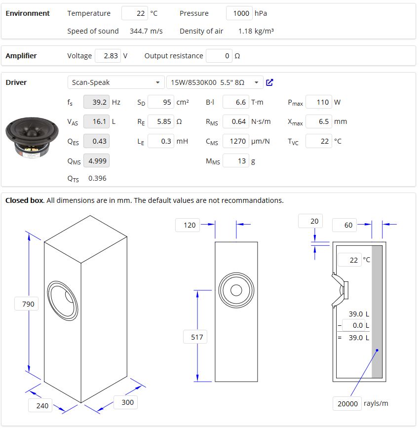

LineSource Member Joined 2003 2020-08-10 3:00 am #41 2020-08-10 3:00 am #41 ScanSpeak 8530K00 sealed box (790mmH_240mmW_300mmD). -F3~65-70Hz 20mm wood. You can build a wedge or a stand. You can put woofers behind the chairs 🙂 Attachments ScanS 8530K00 sealed.JPG 88.2 KB · Views: 83 Under Chair Woof.JPG 139.9 KB · Views: 81
