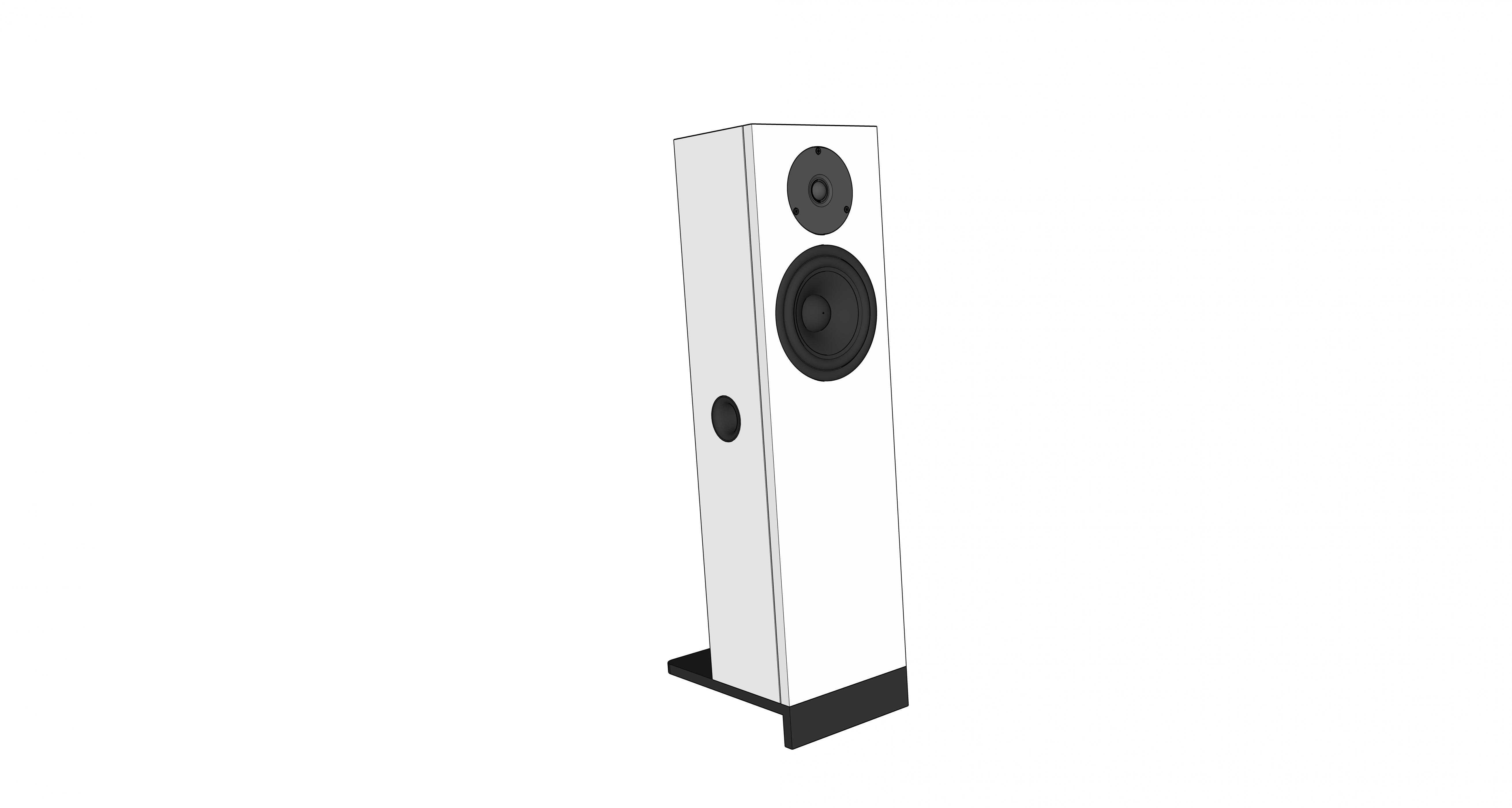

So decided on the Hiquophon and Revelator combination. I've modelled up the enclosure. 10 litres in total - probably tuned to about 45Hz to give a nice bit of extension. The idea is to try and devise a system without clamping so I'm intending on using Lamello Cabineo internal fixings and glue. These will pull the panels together securely and make the structure rigid while the glue cures.

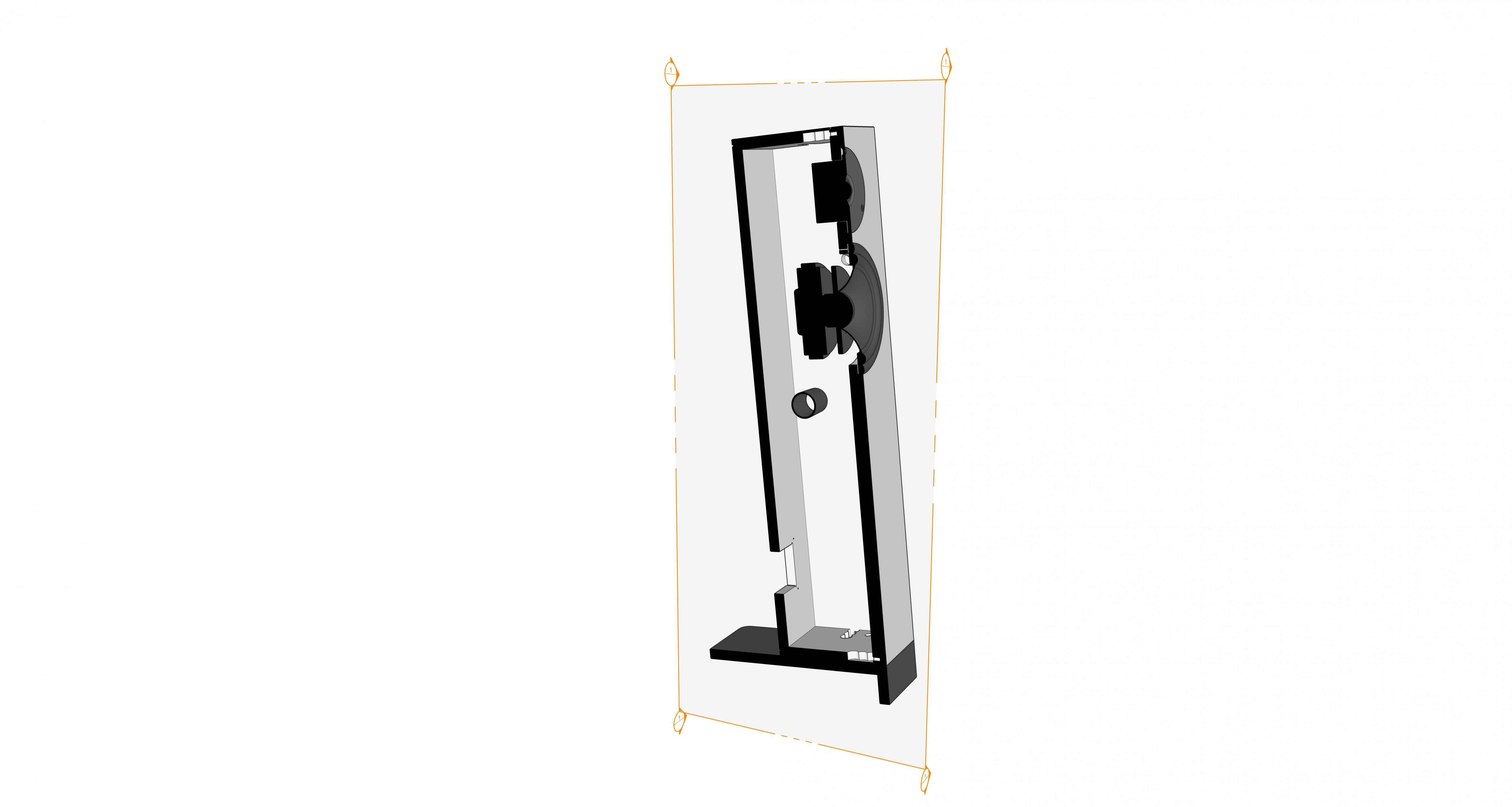

Cabinet is 12mm Valchromat and the baffle will be 16mm birch ply. I've opted for the thin wall approach rather than brute force, no internal bracing though I may revisit that. I will probably use automotive bitumen pads on the rear internal surface to a thickness of 4mm and the egg crate foam. Not sure if it also needs acoustic wadding?
Porting fitted in the side on opposite sides as the cabinet depth is shallow. I'm tilting it back 6 degrees to fire up to ear height as the baffle height is short but will fit adjustable screws to alter the tilt if necessary. Added some drawings and one for scale 🙂
Wish me luck!

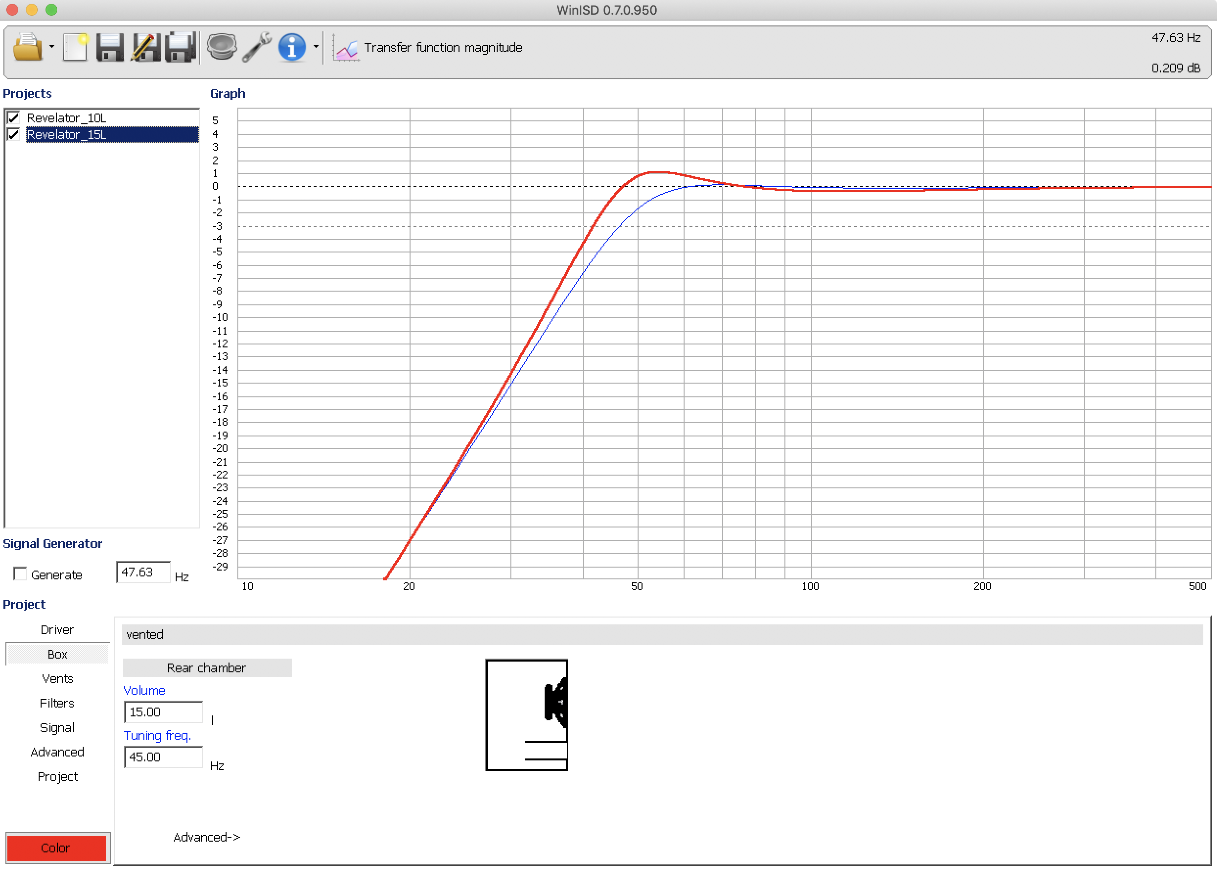

Quick question about port tuning before I commit to the final volume I have two modelled at both 10 litres and a maximum 15 litres. They are both tuned to 45Hz for comparison. The 15L extends but a small 1db rise at around 55Hz. As the speakers are positioned a little closer to the back wall than most designs recommend I wondered if I should go for a flatter tuning or that 1dB hump is inaudible?
Room affects aside, I don't think a slight rise through the bass is bad. For example flat at 200Hz passing through 1/2dB or so at 100Hz and up by a couple more down lower.
