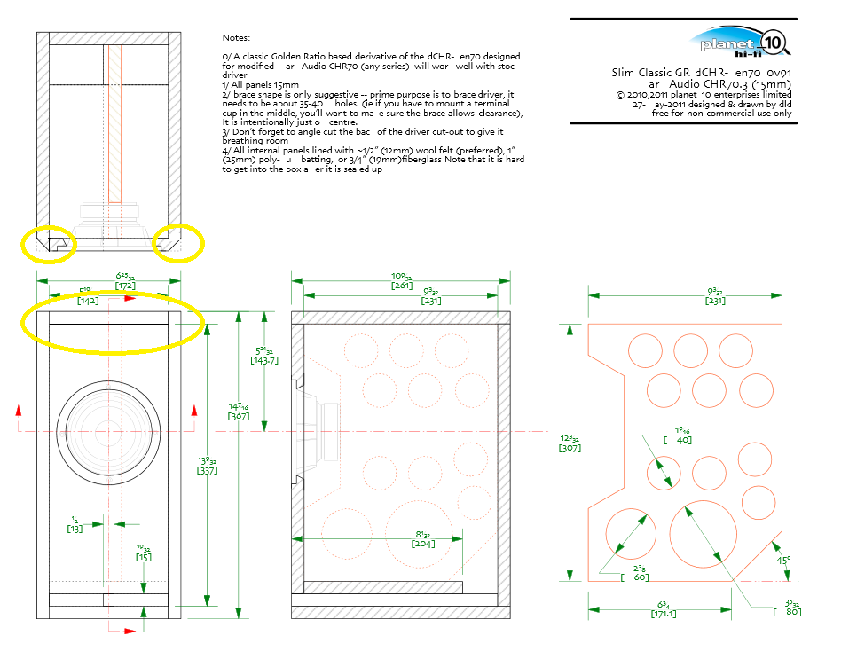

i saw the slim classic gr dchr-ken70 plans on frugalphile, are you talking about this? there's a bit of work in it but it's not a problem, my question is if does this really sound better than the "stupid" reflex box in the mark audio site.

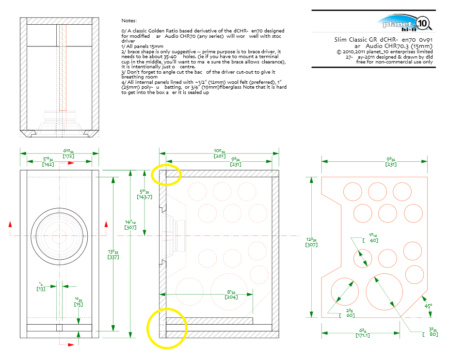

i also have some doubts about the plans, i dont know how to properly say this english isnt my first languange and i apologize for all the errors, but it ssems to me there's a little imperfection in the plan.
in the front view the front panel is covering the top one, in the side view it is under it, i dont know if it's me that i cant read it properly or what but anyway, the correct dimension are only a couple of sums ahead.
what do you think? am i good with this one?
I believe so. The high aspect ratio vent effectively adds an R to the vent equation, which in practise keeps the box in tune over a wider range of the dynamic changes in driver parameters allowing for a more finesses bottom end.
These emclosures are larger than the miniSize box -- but IIRC what Kyle did build.
The plan is consistent. The larger panels are full height, but the skinnier panels are not (would be harder to do the vent otherwise). You of course can much with the joinery as you see fit.

really thanks for bothering with me, but i cant understand the plan.
i made two version with the corrections i'm talking about, assuming i'm right wich isnt true probably, they are attached here.
the first one, if i understtod correctly what you said, should be the one you are talking about, with the simpler front panel.
the second one is more difficult to do but is more aestetically pleasing, especially using plywood.
idk if it's right but i'm pretty confident, changes are circeld in yellow.
here is the original one:
