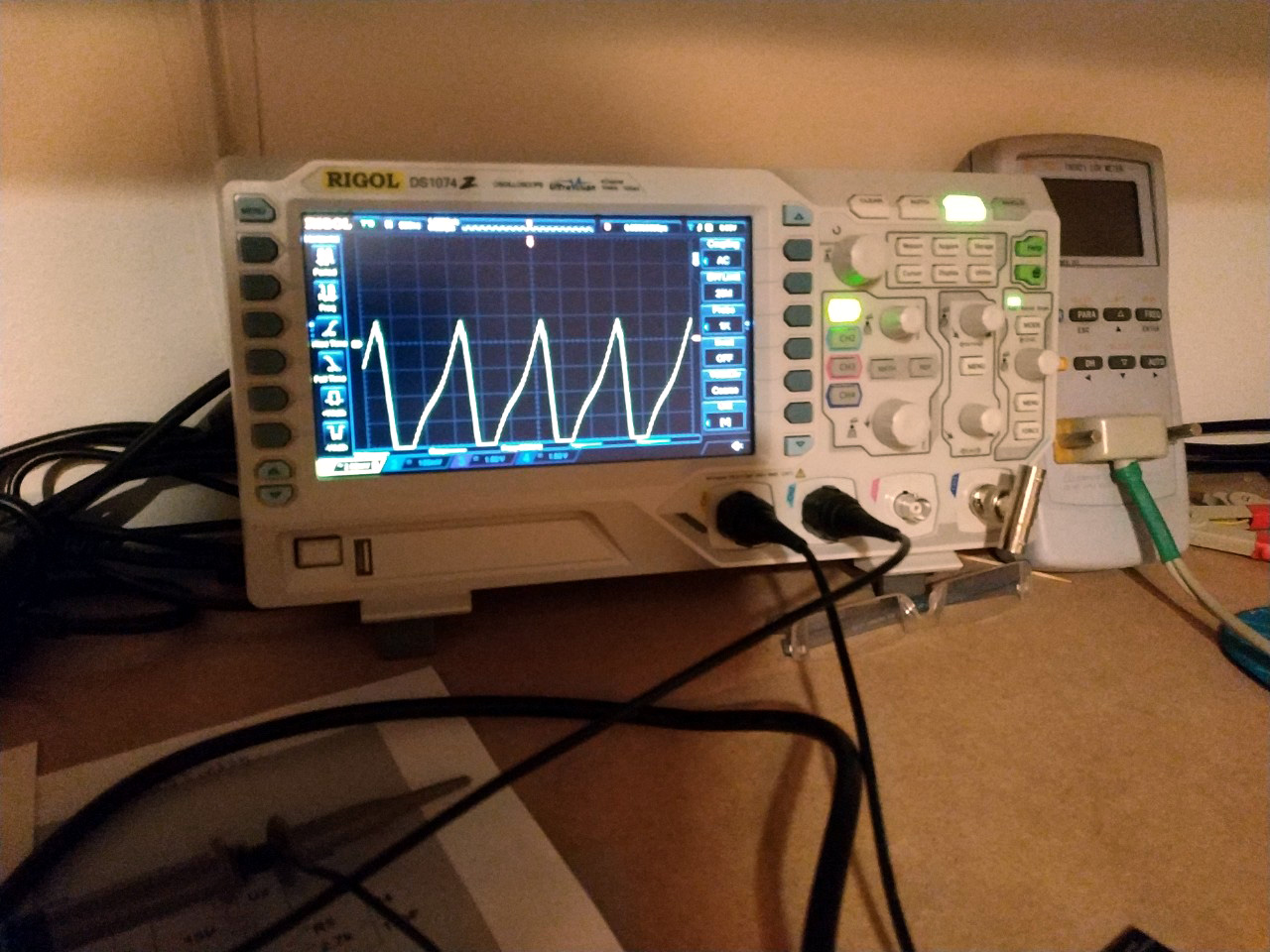

Actually its Vgeorge who discovered a 10mV 964kHz LT3094 rail anomaly and Dimdim battled it to submission by manipulating values between its Vref filter cap and V- output cap. The pos LT3045 was happy with typical initial values but it now uses same caps so both polarities regs shall reach Vo nominal together at start up and having the same noise behavior.

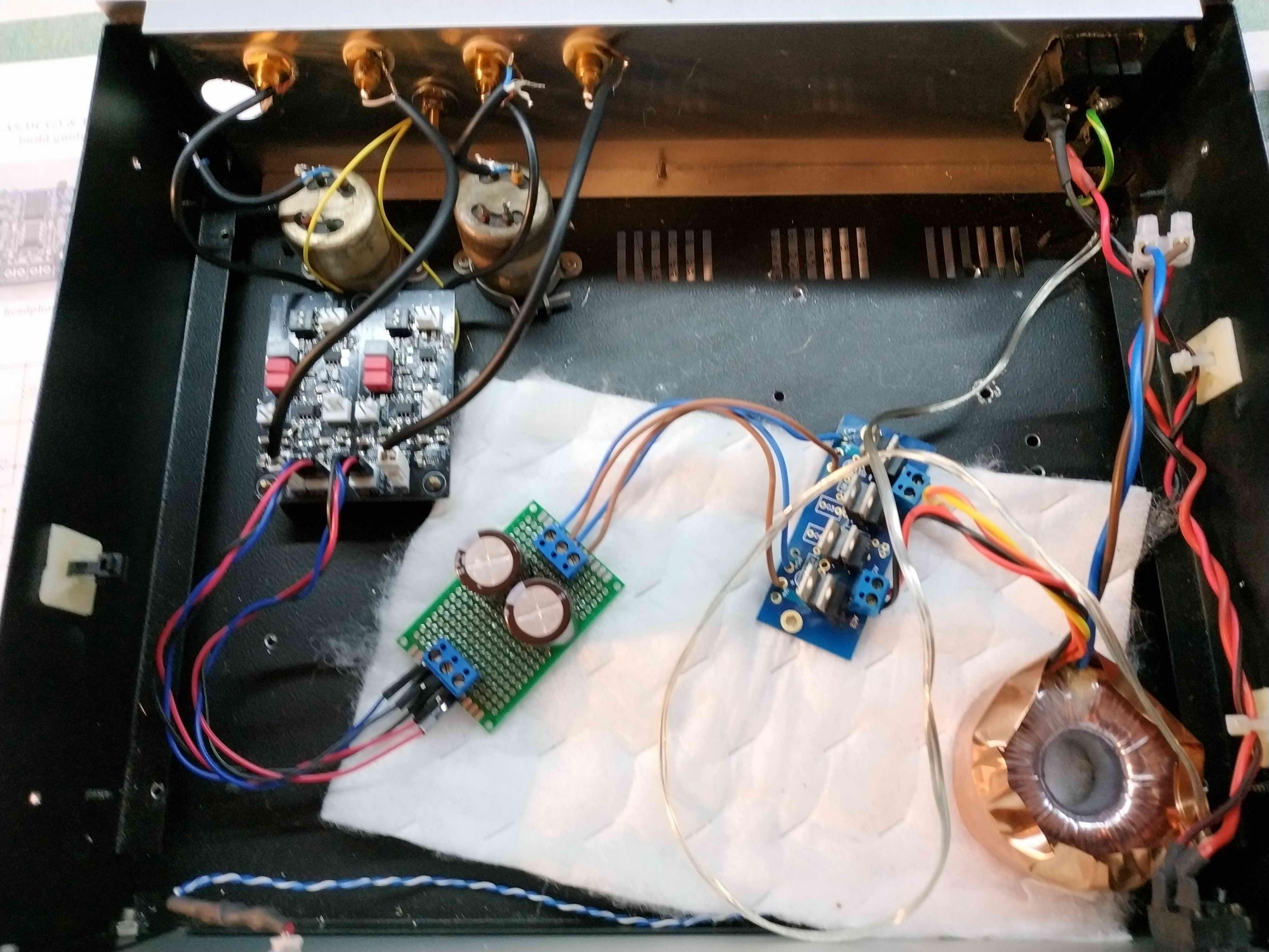

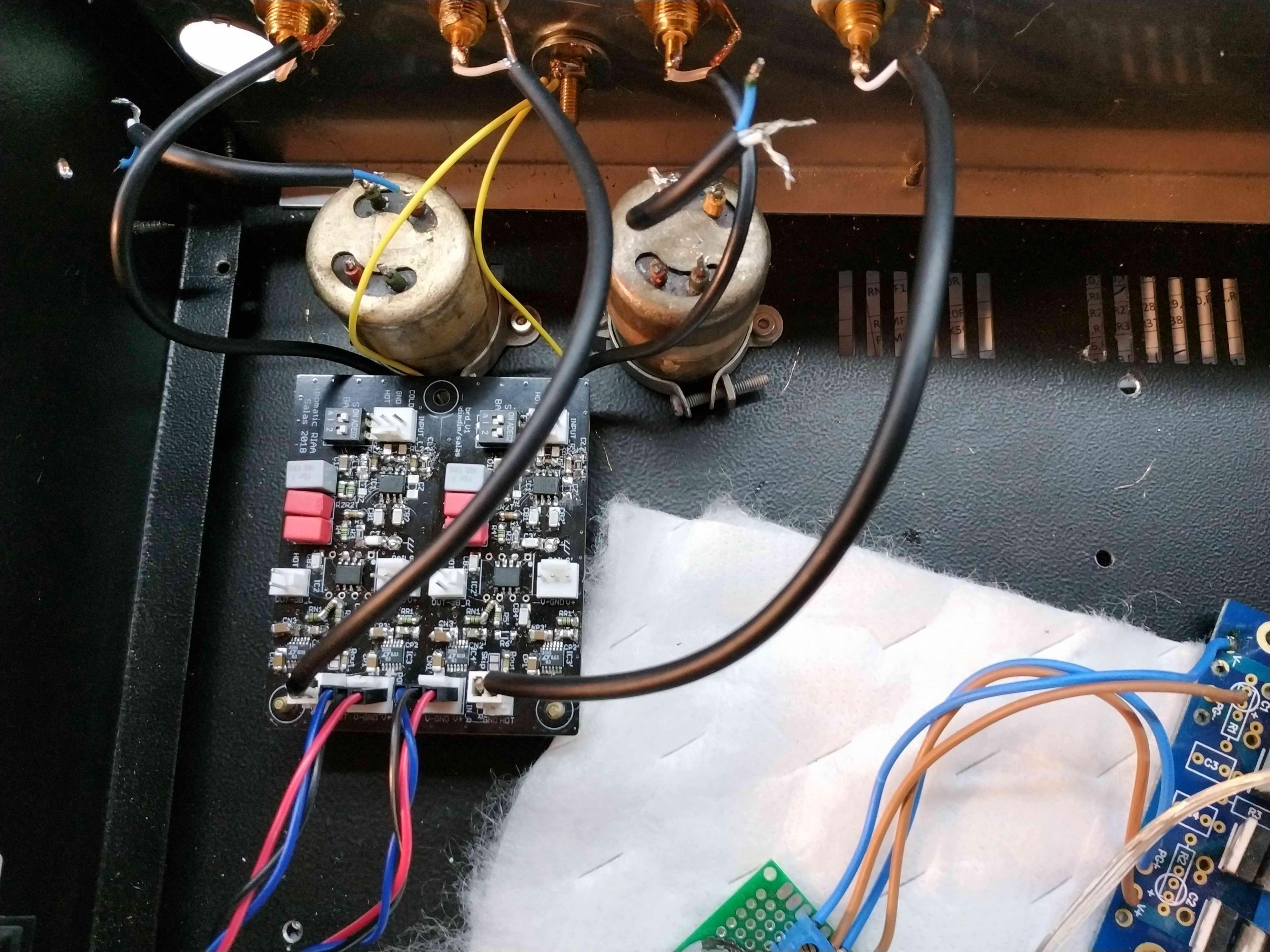

After populating the chipomatic boards and debugging a few things that were mentioned earlier in the thread finally did some listening tests in various configurations. Photos shows my test setup in old case I had.
My cart is an Audio Technica ART-9, so i needed either input mc transformers or to set up the chipo with at least 56 dB gain.
First test was with gain at 45 dB (Rg 33ohm) and some Partridge 12 dB transformers I had in my stash.
Also changed the last IC with ad823, as it was much more natural and less technical sound than with opa 2134. There was also a very slight buz I couldn' t get rid off, but not much as not to be able to do some initial evaluations. I concluded later that it was due to the transformers, as when i set the gain to 56dB by changing the Rg to 8.2 Ohms there was none.
Sound was natural and dynamic. Nothing like other chip phono amps I had listened in the past (with ad797 etc). Only by comparing to my simplistic it showed that some more naturalness can be attained, especially in the midrange.
Next was without transformers and gain set higher at the input chip.
This time no buz, but a little bit higher hum. Sound this time was a little bit more rough than I would like.
Conclusion is that with low MC you need transformers for a good result.
I have buy already two nice boxes to put it in, in the future but with some other transformers.
With MM - I did not listened - but with around 40dB gain it was was very quiet, and should be an excellent match.
Also try not to have a strong mains transformer near by, as you will have some interference. In the end I got a 15VA toroid and it was fine.
At the end it is an excellent phono stage for a very small investment.

Hi George,
Very nice and detailled report, thanks for sharing!
I understand it is not your aim or priority, but perhaps instead of increasing the gain in the first stage only from 45 to 56dB you could have split the additional gain with the second stage - or even increase only the second's stage gain by 11dB... just a quick thought...
But anyway, your results are very very encouraging. Let's hope final boards will be relased soon!
I wonder though what (per channel) 2 class A biased AD825 would have given (or at least one for the second output stage and "whatever single" for the DC control)... perhaps I will have to find out myself once the board are relased.
Another thought... Having the normal sized dual AD823, or whetever best suited dual for that purpose only, controlling DC for both channels could enable complete free amp rolling with singles for the (second) output stage... that would make a double for DC for both channels - a dedicated one to that task - and 2 singles (for the second stage of the 2 channels)
Do you know any single op amp you do prefer over AD823 that could in your opinion be suitable for this fascinating project? Say improve on the slight drawback (mids naturalness) you noticed without deteriorating the remainer?

Hi, I am not an expert on opamps, Salas will reply to your questions better.
Maybe an ultraBIB as power supply could or not help.
Remind you the comparison was with my simplistic with premium parts, dual mono supplies etc. not a fair one. If you hadn' t listened together maybe you wouldn ' t notice.
Thanks again George
Although I have already ordred those amazing reg chips, it would be nice indeed to have a comparison on the Chipomatic between these reg chips... and an UltraBIB. Or who knows, maybe cumulating them both or whatever.
At the end it will be very interesting to see how much sound can be squeezed from this nice projectn whatever its final form!
George will have the opportunity to bring his build around at a point to listen for possible (?) differences between the hardwired prototype board build powered by the shunt and form an opinion vs the full SMD on SOTA reg chips version.
From what he described I think his assessment is on the right track. In other words an exciting op-amp phono that should not be expected to rival something like the FSP in sheer naturalness but scores many impressive hits.
Dimdim had listened to my build a few days ago when he came by to measure his work in progress. Was successful and measuring alike. He just had a 0.15dB rise in the curve after 1kHZ. But he was happy about it since his treble caps are of higher tolerance and his capacitance meter only indicative. It was set for MM on a wooden plank just to can look in it on the bench, he will eventually box it.
The input signal connectors especially should be skipped to directly solder the coax in a finished build, as I have seen they can be prone to erratic noises. Maybe that's a hint for George too (?)
He has a higher than 100dB sensitivity big horns multi-amped loudspeaker system that can easily throw any nuisances into stark relief.
