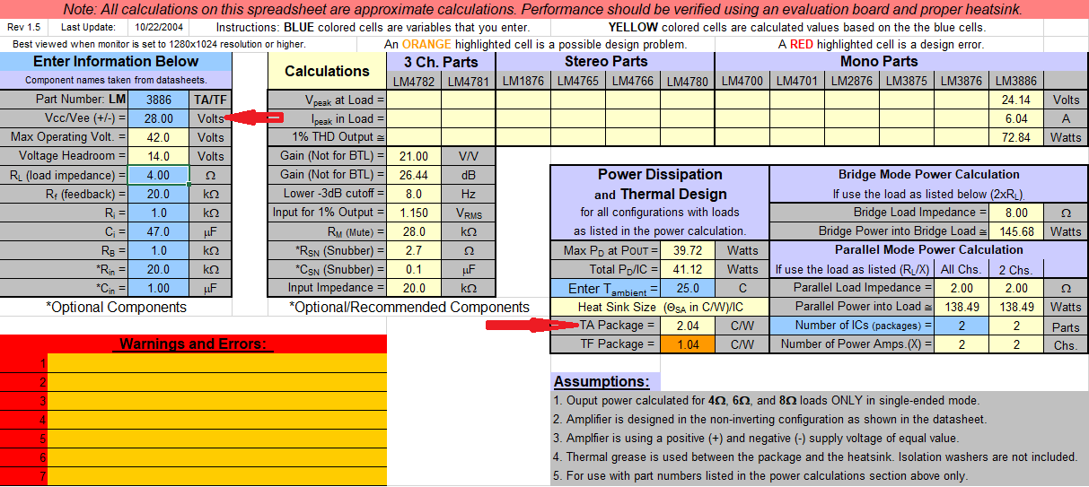

After TI took over Nat Semi they eliminated the "Overture Design Guide" spreadsheet. You will need a heat sink with thermal impedance less than 2 degC/Watt. Here ya go:
