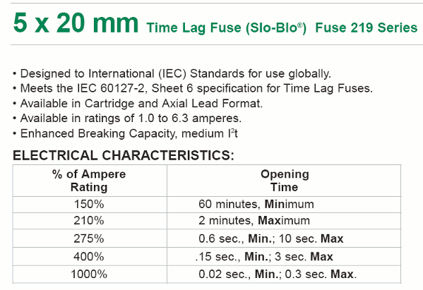

Look at the preceding table for T rated fuses to see what is happening.
Take the T2A fuse. At 2A it lasts forever.
@ 4A is blows at ~ 1.5Seconds. No music transient ever last for 1.5Seconds. A DC fault could easily last that long and blow the fuse, saving the speaker. Obviously an F2A will blow more quickly.
The following is all guesswork based on scientific principles. Actual testing could easily prove what pulses a fuse can pass without failure.
Now look at how long the fuse takes to rupture at 12Apk. ~100ms. Again a transient output current of 12A cannot last as long as 100ms. By definition a transient is a fast and quickly passed current condition. It might last 10us or 100us or 1000us. The fuse might pass 1000 pulses of 1000us before fatigue makes the fuse blow.
But it might take 10,000 pulses of 100us for the fuse to fatigue fail and maybe a million 10us pulses for the fuse to fatigue fail.
The F2A fuse could last forever when passing valid signals to a valid load. That is why you may find that a smaller fuse might suit your system assembly.

what do you mean by "see"? look up on a graph like the one you described? or test what faults can rupture that fuse?
Sorry but there's just a lot of electronic terminology I'm not familiar with.
Pacific's solution leaves me less stumped than the ones with all this terminology.
thanks for your patience
Post 610 has the graph from a manufacturer for their T rated (slow blow) fuses. Go and look at it.
Most manufacturers will be similar but not identical. F rated fuses and standard rated fuses have their own sets of graphs. Some manufacturers have a range of ultrafast fuses.
