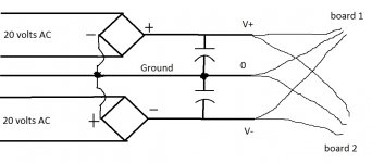

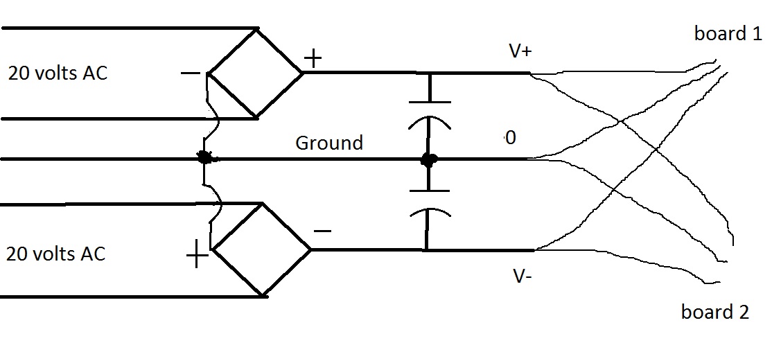

Well one more person needing help here 😱 I got some bridged tda7293 boards off ebay that call for a power requirement of 30 to 35 volts Dc. TDA7293 parallel BTL mono power Amplifier borad 350W - eBay (item 120595963571 end time Dec-11-10 06:58:28 PST)
I have a dual secondary 2x20 volts ac 400VA plitron trafo. The picture shows how it's wired. When measuring the assembled supply with no load, from v+ to v- i'm getting a reading of 48 volts. But measuring from ground to v+ i'm getting around 30. This makes sense to me but the 48 volts does not... I'm wondering if i did something wrong or i fried the boards cuz when i had it hooked up and turned it on there was a buzzing sound and then complete silence. No smoke, no heat on the chips nothing.. did i do something wrong?

what is the 5th (middle) ground wire going to?
It is not needed for a dual secondary transformer, it has no centre tap.
Could it be going to the Safety Earth?

One might also consider paralleling the dual secondaries transformer for just 20 VAC out put = 28.5 volts DC after connection to a single diode bridge ... OR ... connecting the dual secondary transformer outputs and passing that through a single diode bridge = giving one a true center tap between the series coils (as is "standard" practice).
