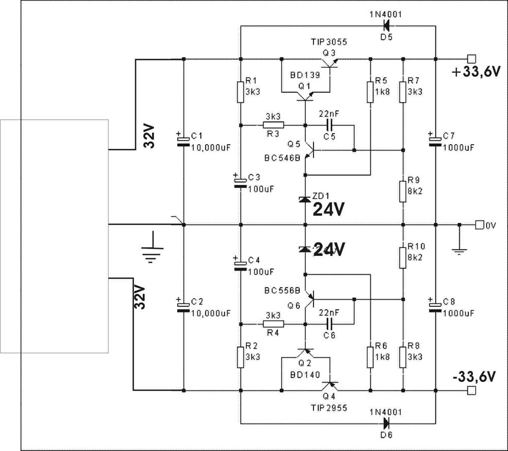

depending on tolerances and actual mains supply voltages you may get a regulated +-35Vdc from a 32Vac.pirej said:I'm trying to get 35v regulated as max. for stereo LM 3886.
The above schematic is OK with my trafo 32-0-32v?
But, you may suffer from occasional drop outs in the regulators when high current demand coincides with low supply voltage. This could be so rare that it effectively never happens during normal operational conditions.
If you find that drop outs are occurring then reducing the output voltage by a volt or two may cure the problem.
Where are the rectifiers?
THNX Andrew and all...
Sorry, but I was impressed with GC with my Canton CT 920DC. Previously I had a technics SU-V-670 and was trying to hear some parts of any music composition...
That was real reason to use two other trafos 32-0-32v to make another for my colleagues...
Rectifies were not drawn...Just the trafo..
