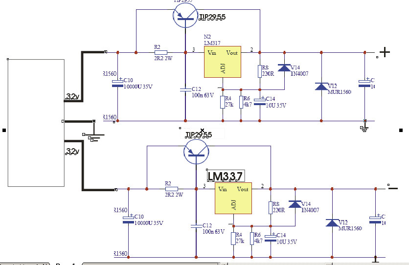

I have transformer 32-0-32 ..5 Amperes... and wanted to use to "drive" my Gainclone, made by LM3886 (stereo version).
- If I use 40v capacitors can I get "normal" power supply for GC?(for example 36-37v per rail).
-Is there a schematics for regulated supply in which my transformer will fit? (Lt1083 or somethnig else..) to lower the supply on 35V per rail..
- No way - just to make single supply version (to use as 64V or twice by 32V?)

Your transformer puts out 32V AC. Multiply by 1.4 and you get 44.8V DC. The maximum for the LM3886 is 42V. Also, using a 40V capacitor with 44.8V rails will cause destruction of the capacitor. The capacitor is not a limiter, it must be rated for higher than the highest voltage it will see.
A regulated supply is your best bet if you want to use that transformer. Unfortunately I can't help with that.

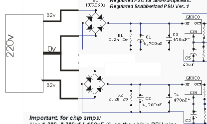

Check this thread: http://www.diyaudio.com/forums/showthread.php?threadid=56106&highlight=
are you trying to get+-24Vdc from your regulators?
Then use a 24Vac or 25Vac transformer.
You need a single bridge rectifier if you use a centre tapped transformer.
You can use either a dual or a single bridge rectifier if you use a dual secondary transformer.

I'm trying to get 35v regulated as max. for stereo LM 3886.
The above schematic is OK with my trafo 32-0-32v?
