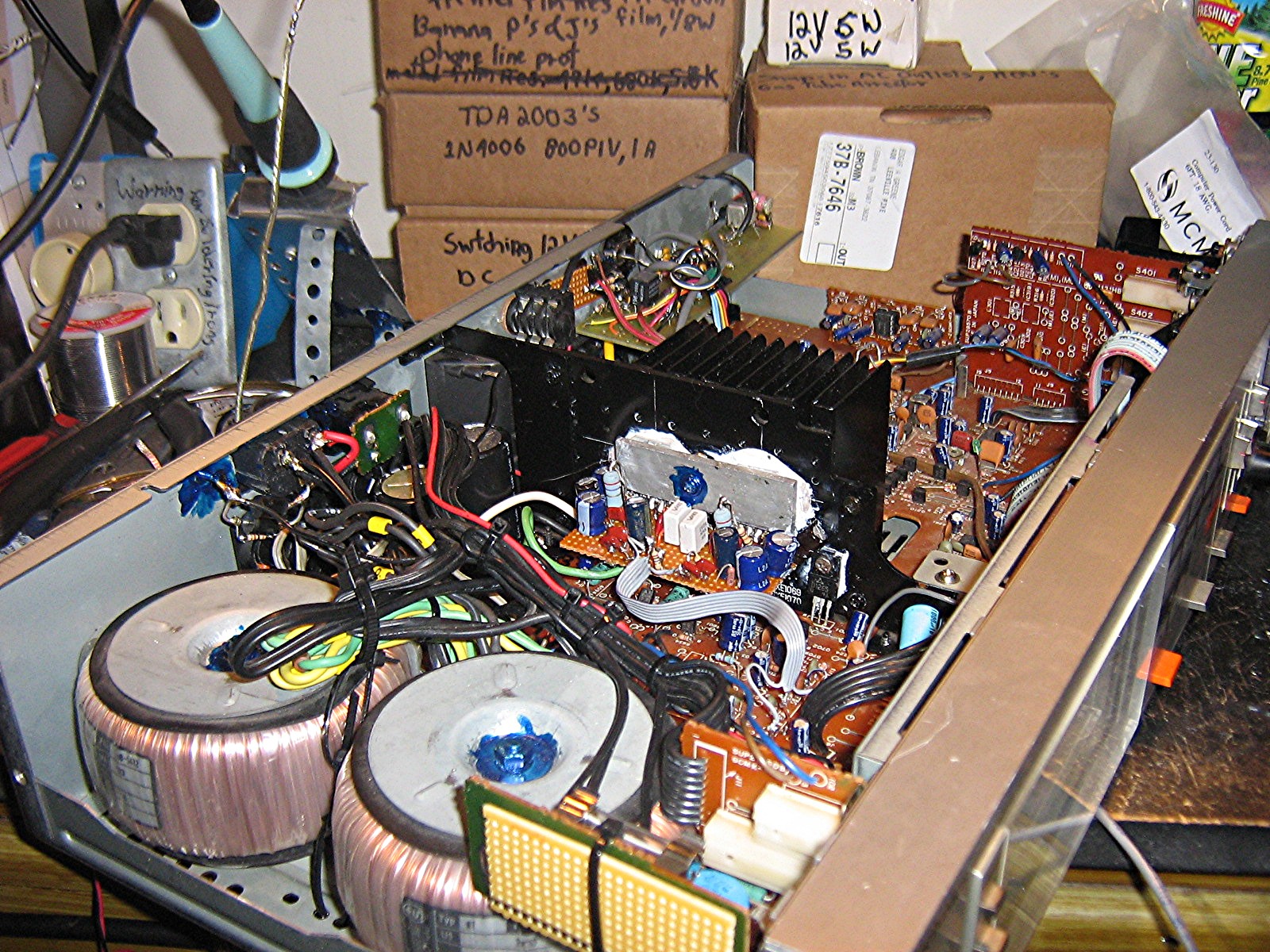

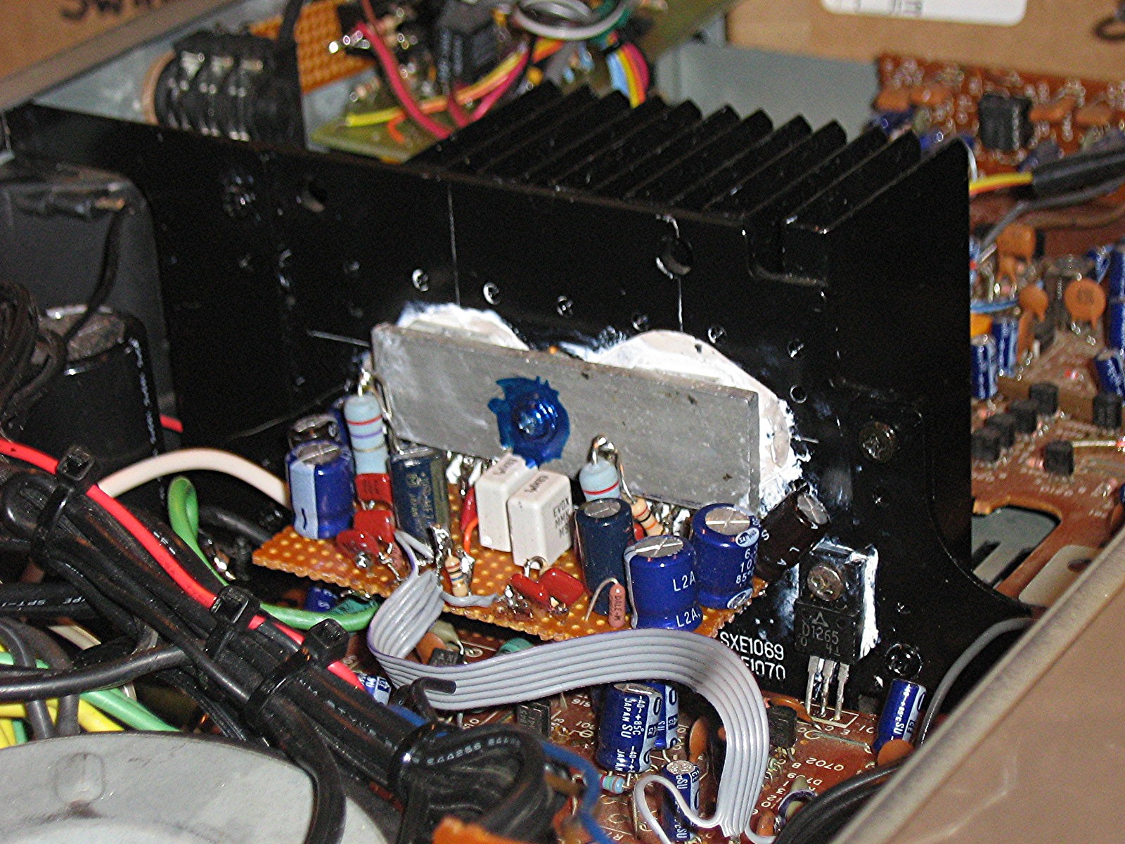

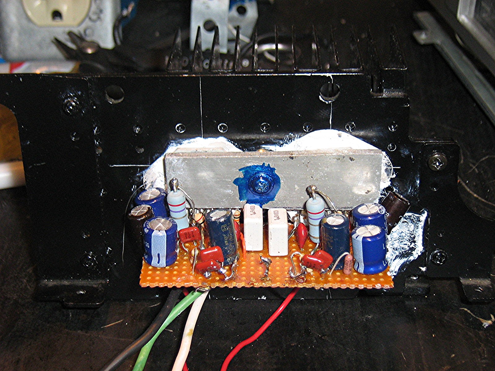

Here's a 2 X LM3886-to-Stk Retrofit board I made on perf-board. I designed, built, and installed it in a Technics SA350, a few months ago. I have it out for modifications while I'm doing other maintenance on the receiver. The board has snubbers, but no main filter caps, as its made to replace an STK in receivers and amps. I'll probably have FAR Circuits run a few for me in a couple months. It's the first GainClone amp I've ever built and I'm delighted at how great they sound! 2 123VA toroids and a pair of 15,000uf caps on my +/- 32V rails probably help the sound.
heatsink
Nah like i said im sure they are well too small,or so i thought. It runs fine at low to moderate volume. It is after all open chassis. Ive done some very rough testing of heatsinks on this chip, using 22-0-22 quality traffo, quality wires (i dont mean trendy i mean short, stiff, twisted copper!) and basic techniques which often get forgotton.
The result after 8 months of v.loose testing more just monitoring temperature against volume. Even at high volumes, driven hard into 6ohm each side ive not had a thermal cutout trip ever. admittidly with theses sinks i just dont push it nd usually have a fan running.
But it is a concept piece! 😎
Are you sure those small heatsinks are sufficient for the ICs power dissipation? They are so small and might trigger the internal themal protection circuit a little too soon.

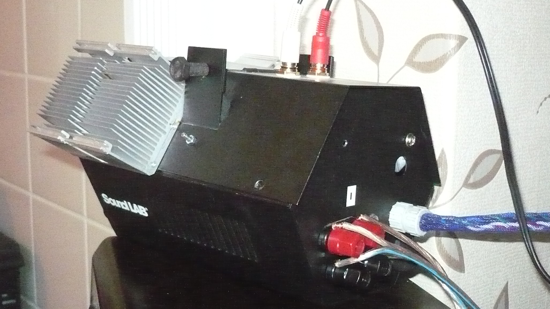

Here is my latest version of a simple chip amp. (unfinished)

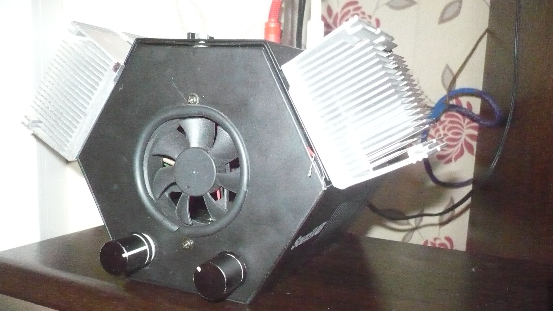

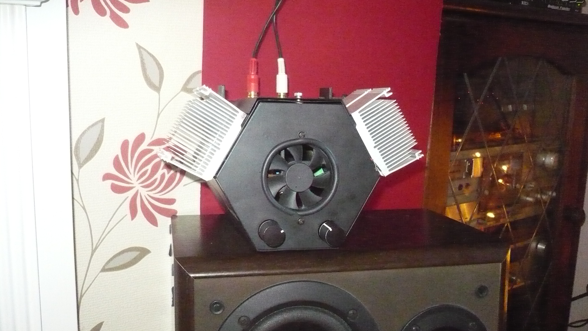

The VAMP (V-twin amp).
Just like to say that thats some craftsmanship there folks, stunning

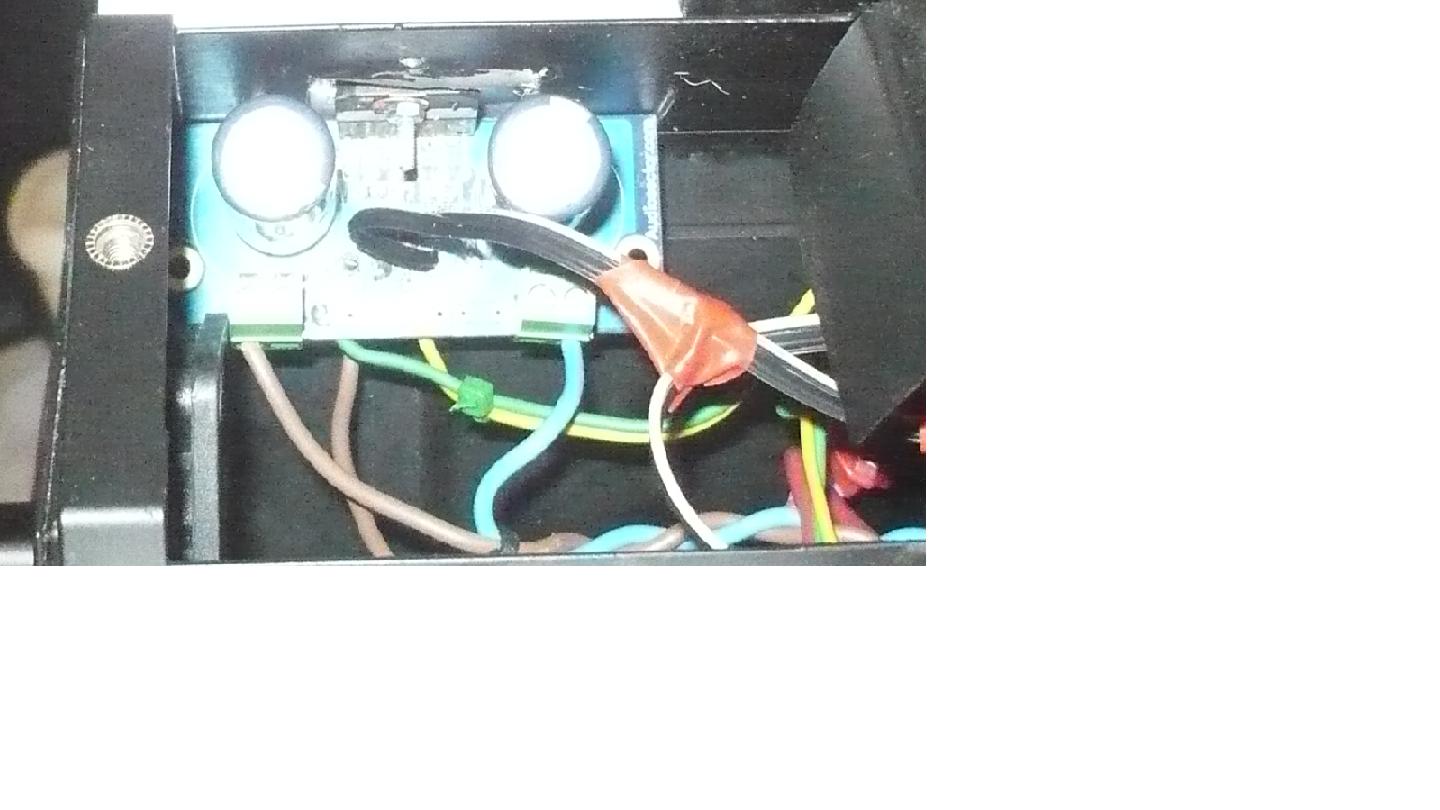

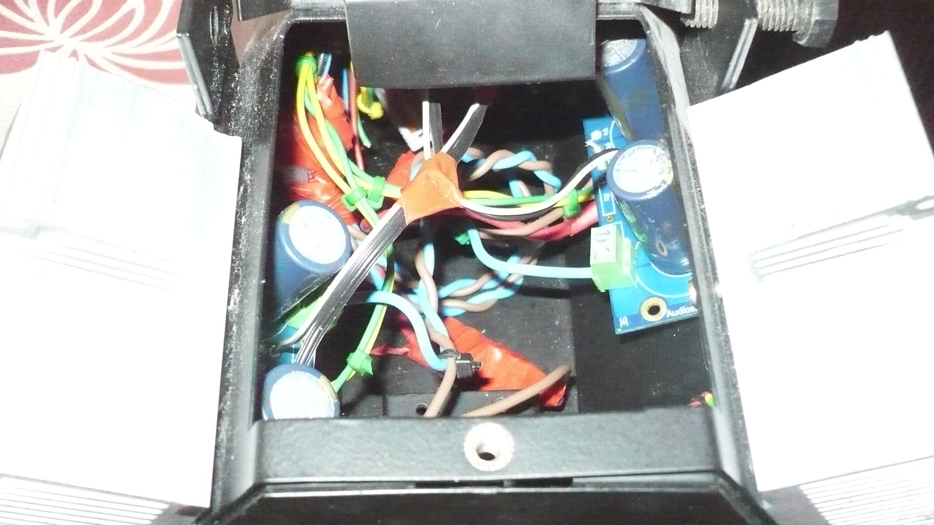

Here some pics of my girlfriends converted disco light V-Twin amp!! build diary in seperate thread.

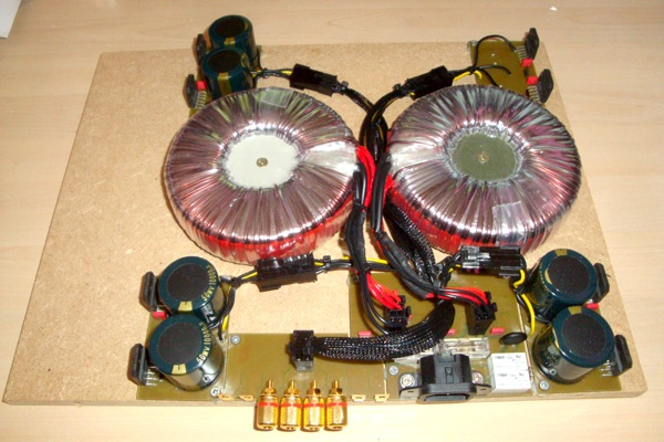

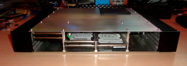

After watching this forum for a while I decided to build my own amplifier. Actually I'm building a complete home cinema system! The mediacenter is up and running. It can handle 12 2.5" harddisks. Just because it's possible 😛.
Mediacenter:
Now I'm busy with the amplifier. It will contain 8x LM3875 and 2 250VA transformers (1x 25V 10A each). Volume controll will be handled by the pre amp (wich I still have to build). The amplifier is getting the same housing as the mediacenter. Size (including heatsinks) is 380mm wide, 50mm high and 300mm deep. It all just fits...

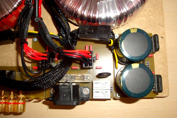

Complete layout on a piece of MDF. I made 4 modules with 2 channels. Each module has 2 50V 10.000uF capacitors (except 1, still waiting for 2 capacitors). All the resistors are 1% 0805 SMT and soldered onto the bottom:

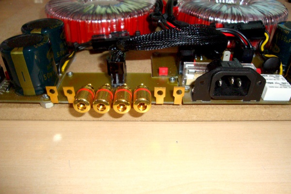

Closeup of the rear (I know, connectors are realy close to eachother, but there's no more space...). Here you can also see the 2 relays and the thermistor to power it on. Each transformer has its own fuse. The diodes are on the bottom of the power pcb. I used SMT versions for this (45V 15A). In the real case they make contact with the aluminum bottom plate:
Here you can see how precise it fits. There is about 1mm between all pcb's. I putted 6pin molex connectors between the powerboard and the amplifier modules, so I can easily replace them if necessary. The 3pin headers will be changed for the same headers as they use for computer fans:
Next is to put this all into a nice case.
Mediacenter:

Cool amp!!! It has the distinctive look of a "V" type motorcycle engine!
Udden, udden, imitative sound of a motorcycle engine. "Coy, don't answer the phone "udden, udden" Ray Stevens

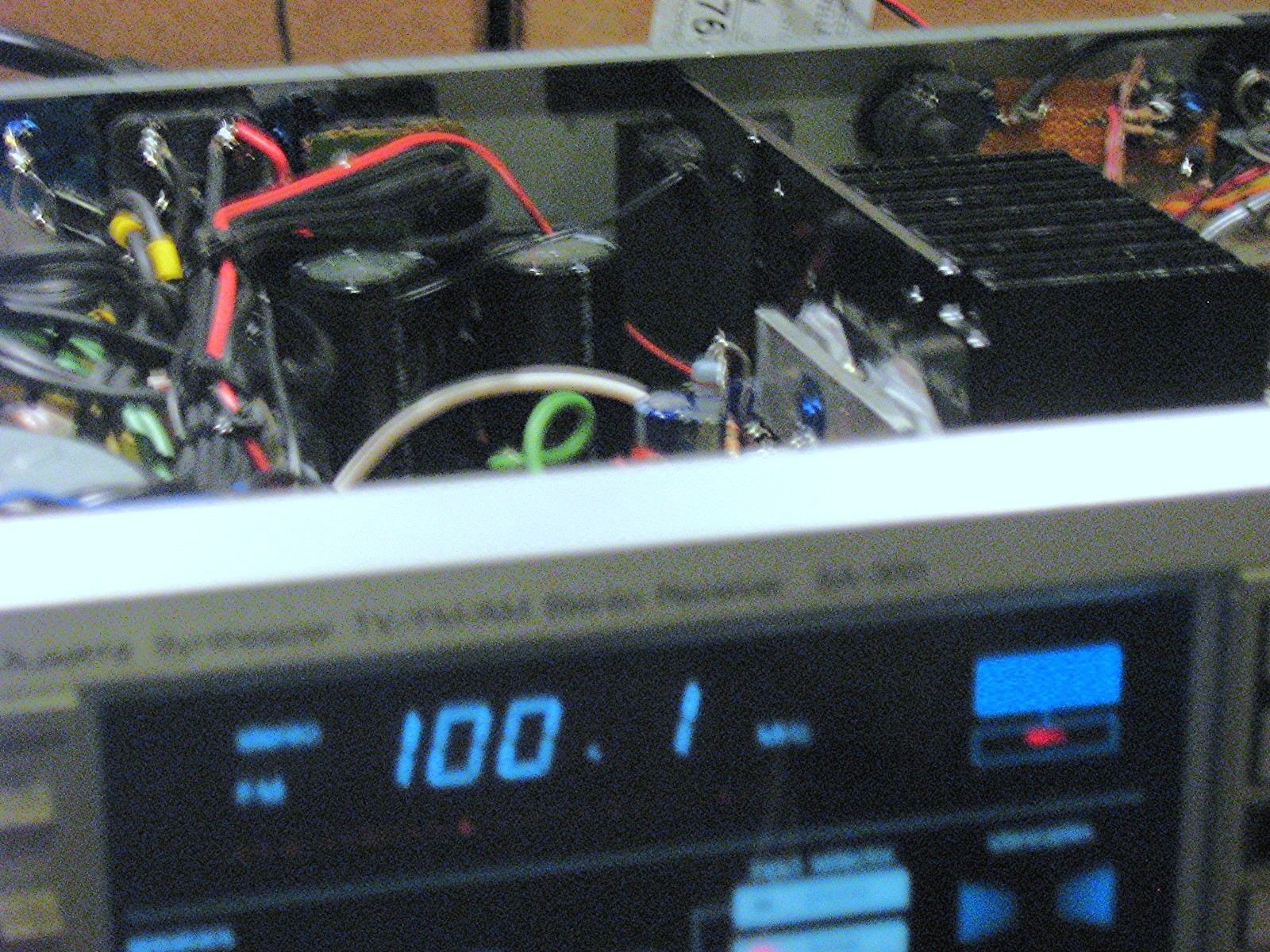

Nice MOD job. What's funny is that I used to own a Technics SA-450 many years back. I'm curious as to what other modifications you are making to that receiver.
It's always good to see another fellow modder like me. I myself am working on a MOD project. I am heavily modifying a Memorex MP3851 boombox. So far my modifications on it make this little, what used to be a cheap sounding boombox, into a truly phenomenal sounding boombox that always gets jaw dropping responses when even audiophiles hear it. Gotta love 8-18v chip amps that put out amazing high power. And yes my little modified boombox can easily put a Bose wave radio to serious shame. Since I can't really find the right forum on this site for MOD projects like mine I am thinking of posting my pics here in this thread, showing my detailed modifications, which there are several. Let's just say the only thing untouched is the CD player. Lol
