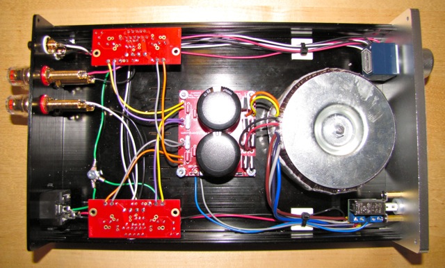

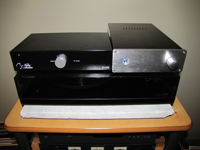

Here's some pics of my LM3875 gainclone that I just finished. This was my first time building one so the wiring and placement of parts might not be perfect. It works and sounds great though and I had a lot of fun building this amp.
Wow, this is nice. Impressive casework.
Where are the VU meters from, they look really shiny.

Thanks! I didn't actually make the case myself. I bought it and then had my front panel custom made after designing it on my computer.
I got the VU meters from ebay. It came with a green lamp but I modified it with by removing the lamp and putting in 3 blue LED's. Here's the link to the vu meter on ebay.

Hi JDawg are the driver circuits diy for the VU meters ?

The vu drivers can be bought from JLM Audio. They have a vu buffer kit that you can get to drive the vu meters. There's also a schematic so if you want you could also make your own. Here's the link:

Where did you purchase the case from?
How about the blue led power switch?

Thanks, I think this turned out great for my first time building one. I wanted mine to look a little different from most of the others I've seen on here and I think I succeeded in that.
I ordered the case from an electronics store called RP Electronics.
Chassis Box - 2 Space, 3.5 x 12"
The power switch I got off ebay. Here's the link to the switch I got and its free shipping too.
