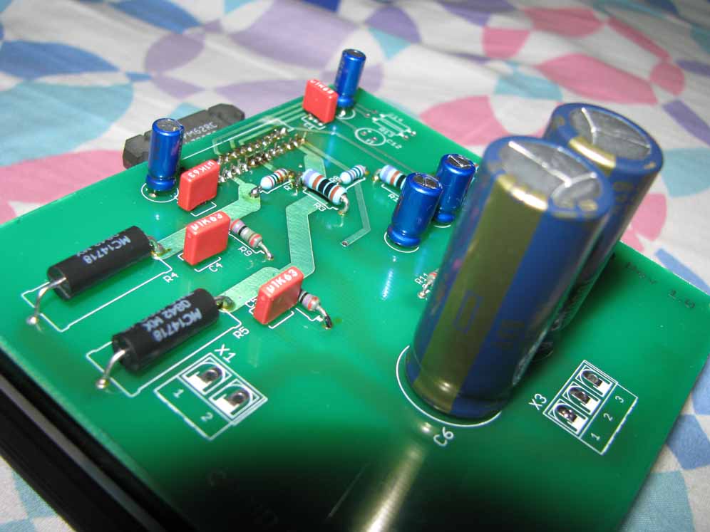

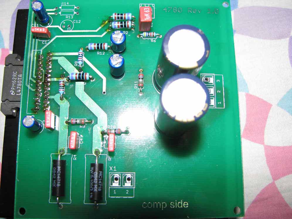

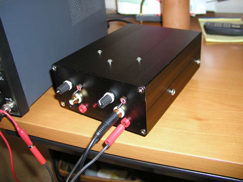

Here's mine
I wanted to build a rugged, small, 30 to 50 watt amp for testing speakers and casual use. Beftus (post 860) and Matjans (post 32) povided the ideas. The schematic is Rod Elliott's
http://sound.westhost.com/project19.htm
and Mick Feuerbacher’s methodology & layout was used to build the circuits http://www.dogbreath.de/Chipamps/GainCardCopy/GainCardCopy.html

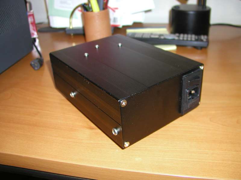

This is a dual channel amp, completely contained in one case about 3" tall, 5 3/4" wide, and 8" long.
I consider myself unbelievably lucky, this amp makes zero noise. No hum, no thumps, ticks, or hiss. I have no sophisticated test gear, just an old used scope and a cheap signal generator, however, the amp's output changes less that a trace's thickness from 20 Hz to about 100 kHz. I'm really pleased with it 😀

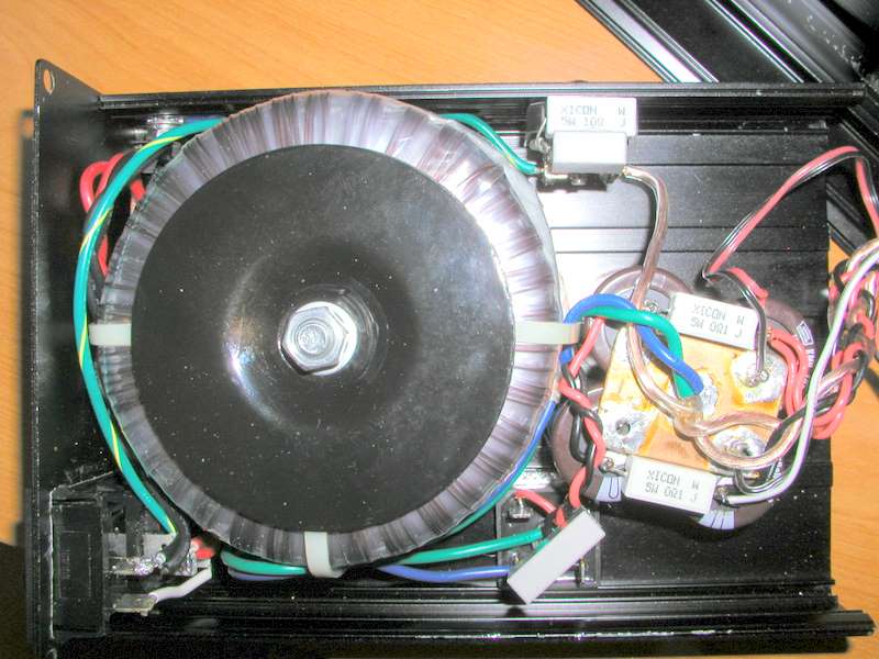

Here's mine (3)
The power supply is a traditional filter bank (although necessarily small). It consists of four 4700 µF caps, 100 v, 35 bridge rectifier & an Antek 200 VA, 22-0-22 transformer. The white rectangles at top of the pic, to the right of the transformer are the loop breaker (Elliott's design) with another 1000V-35A bridge, 10Ù/5W resistor & 0.22 µF 275V MKT cap.
