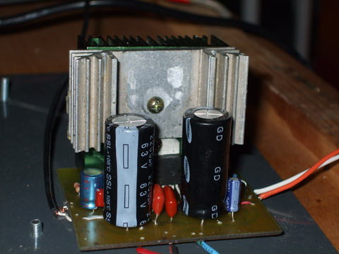

Here is my LM1875 amp with LM338 regulated PSU:
PS: I'm sending the picture second time ,after deleting the first post by mistake.Looks like the link works afterall...sorry about the hasling.

thetube0a3 said:hey nice amp pikkujöpö
but i have a important question, i noticed your RCA jack is isolated from the heatsink, i need an isolated jack and CANNOT find one anywhere.. what brand is that? or did you just add washers?
The isolated sockets are NEUTRIK NYS367-0 and NYS367-2(white and red).I bought them from Farnell.Good quality and low price.

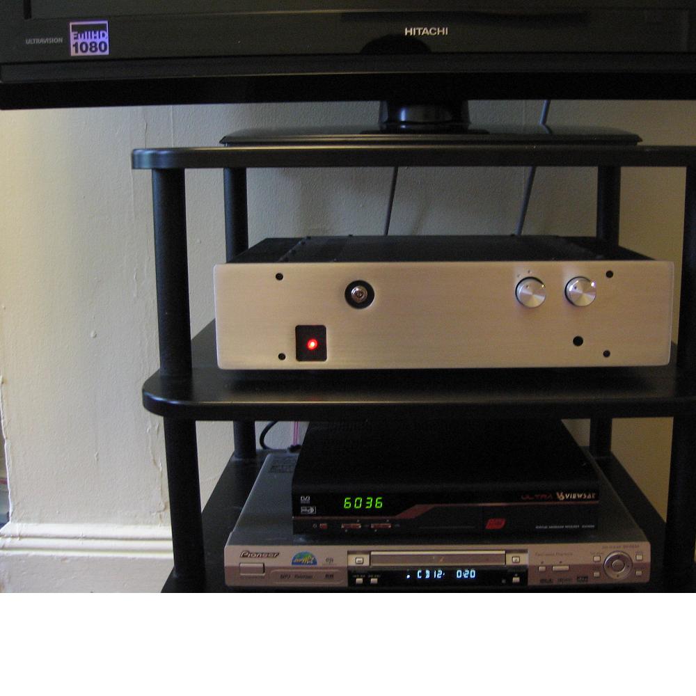

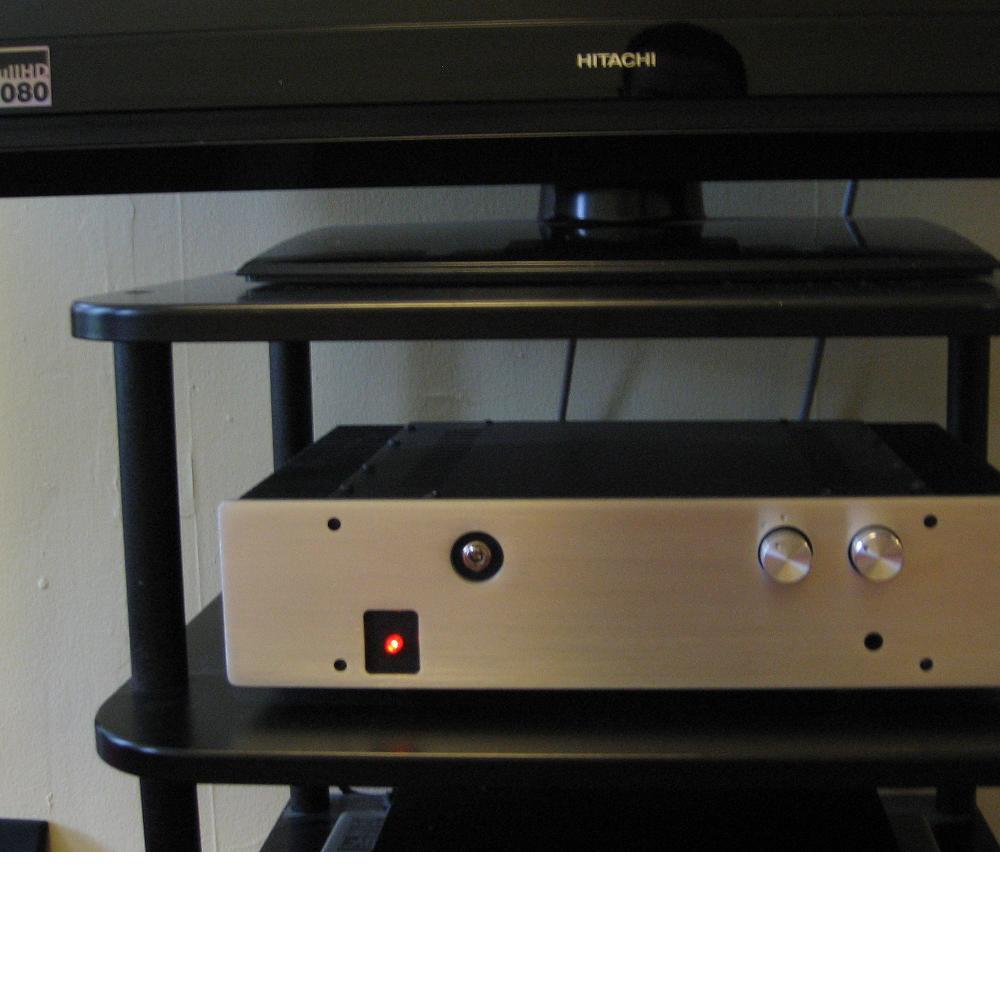

Square Box?
pikkujöpö, that looks fantastic!
What is in the square box? Just a power switch or anything else? Looks like the transformer and power supply are in the other chassis.
Thanks lgreen
The square box is holding the fuse.There is also a capacitor between "live and neutral"(100nf x2 rated).
Yep,the other box is holding the PSU,bridge rectifiers etc.The amp and regulators are all point to point.
Amp chips are close to the speaker terminals.Grounded aluminium bar separates the amp from the psu.
