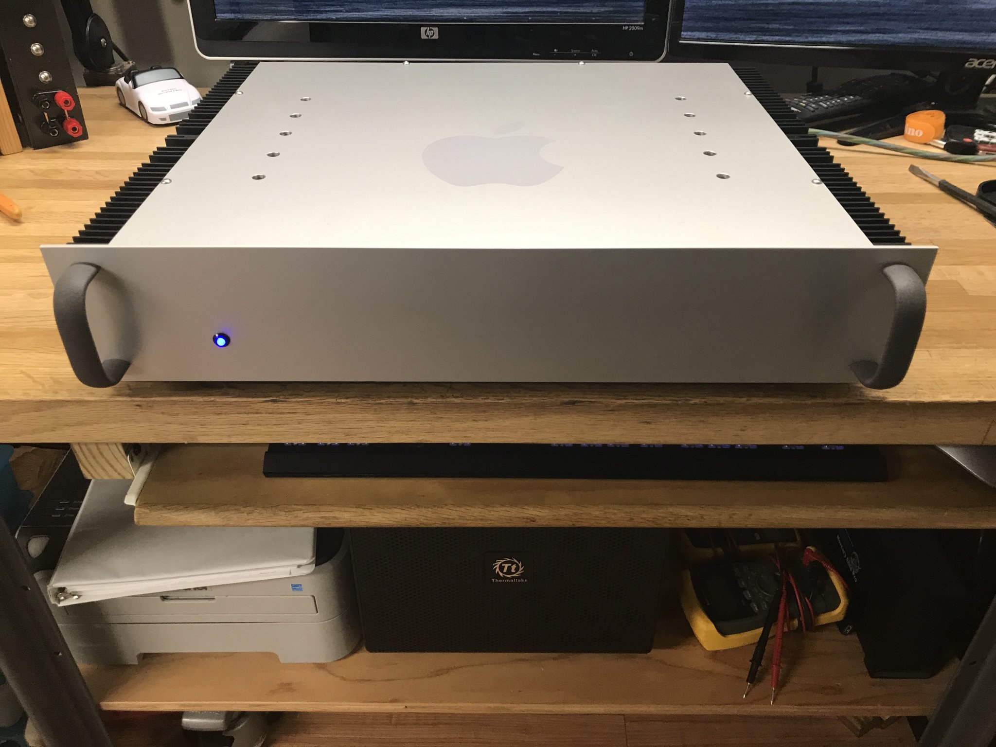

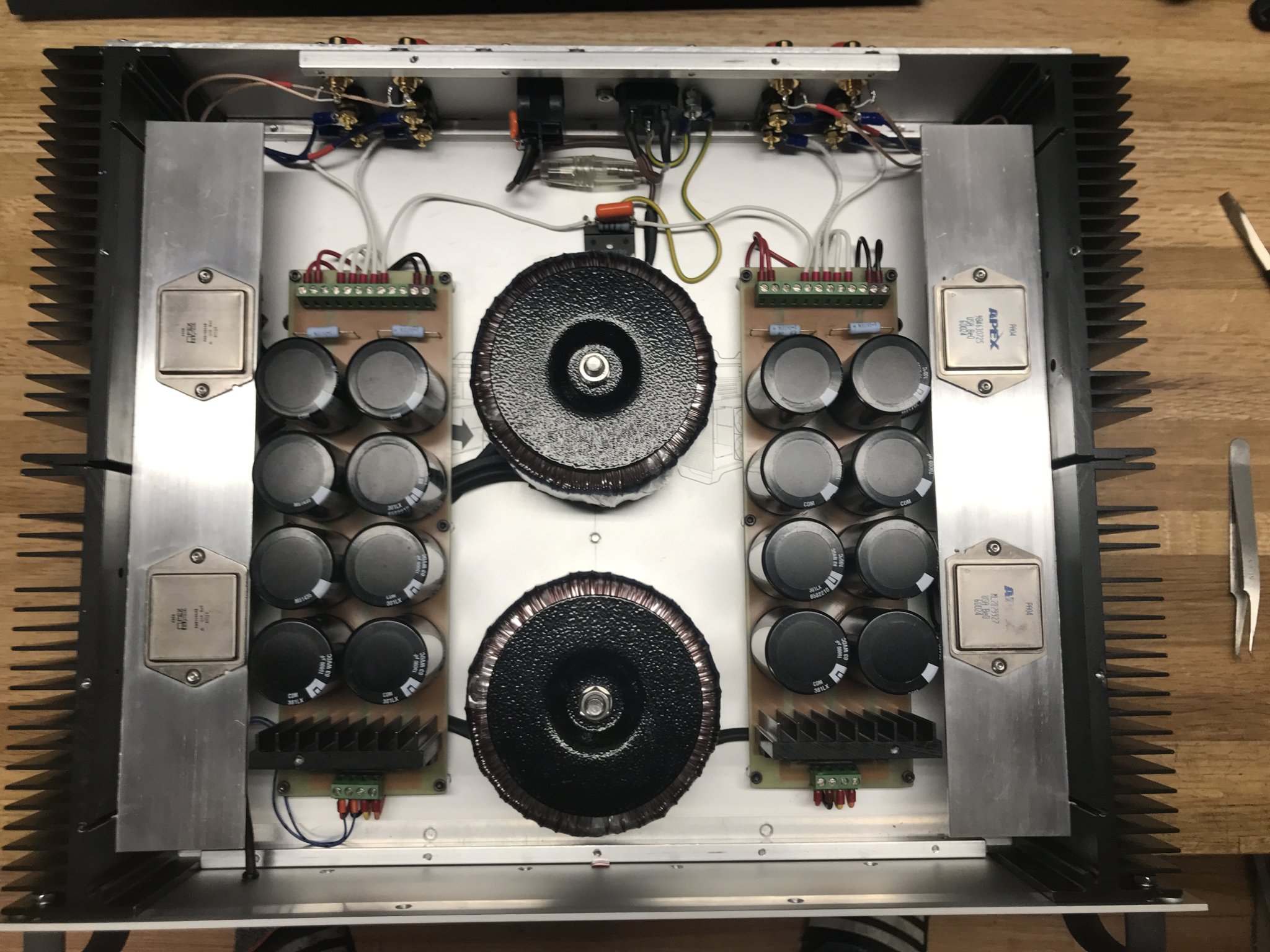

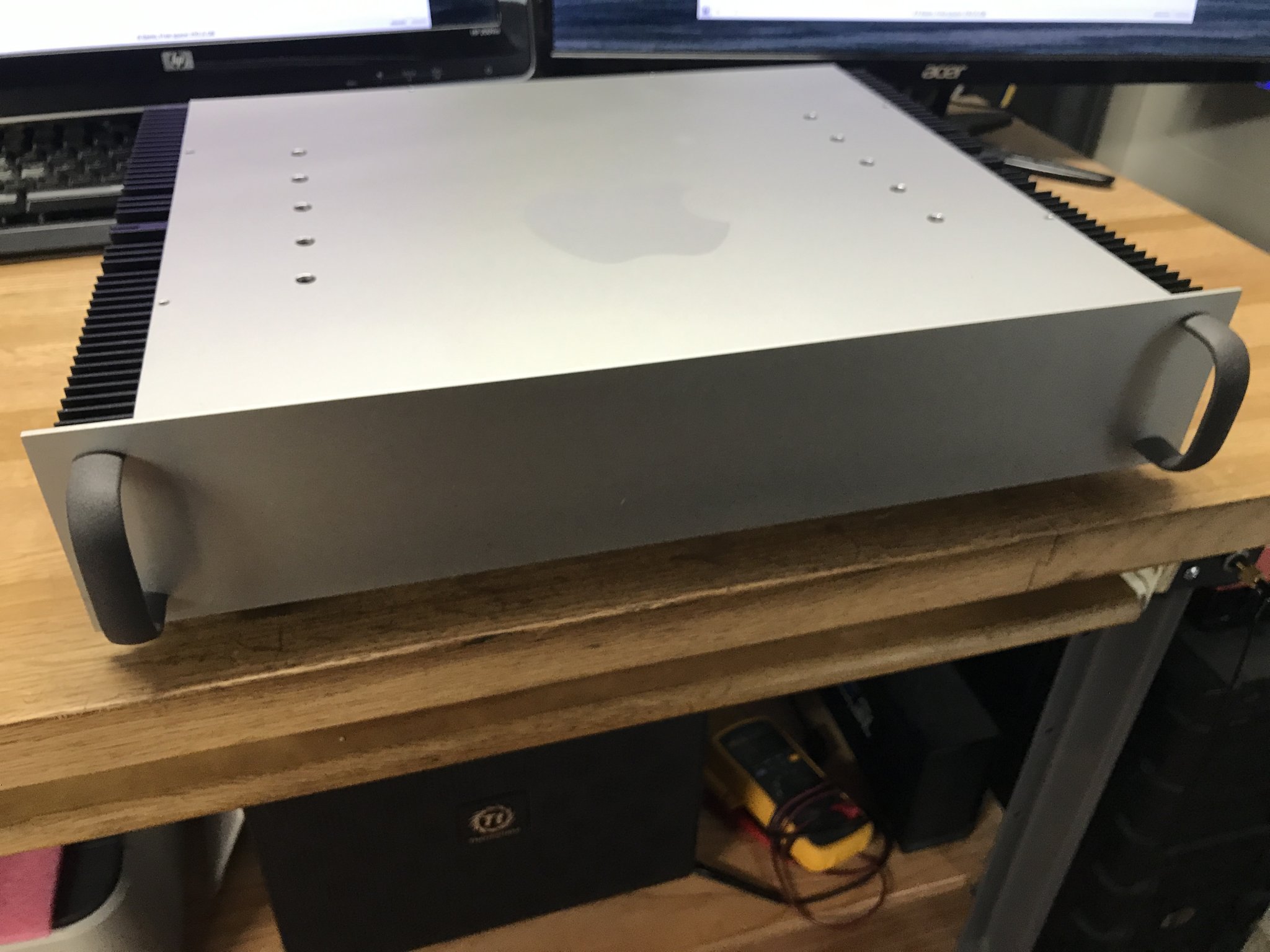

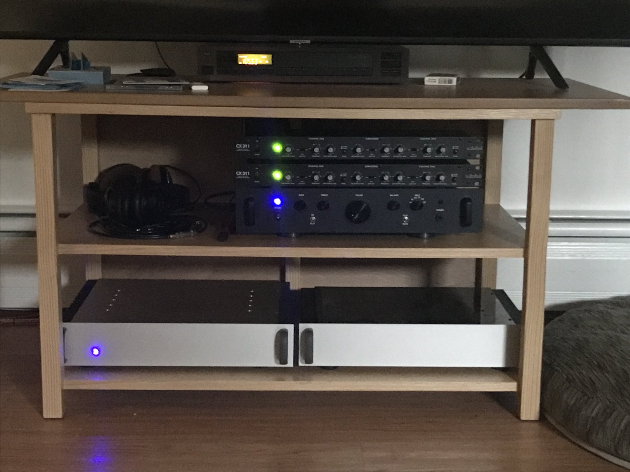

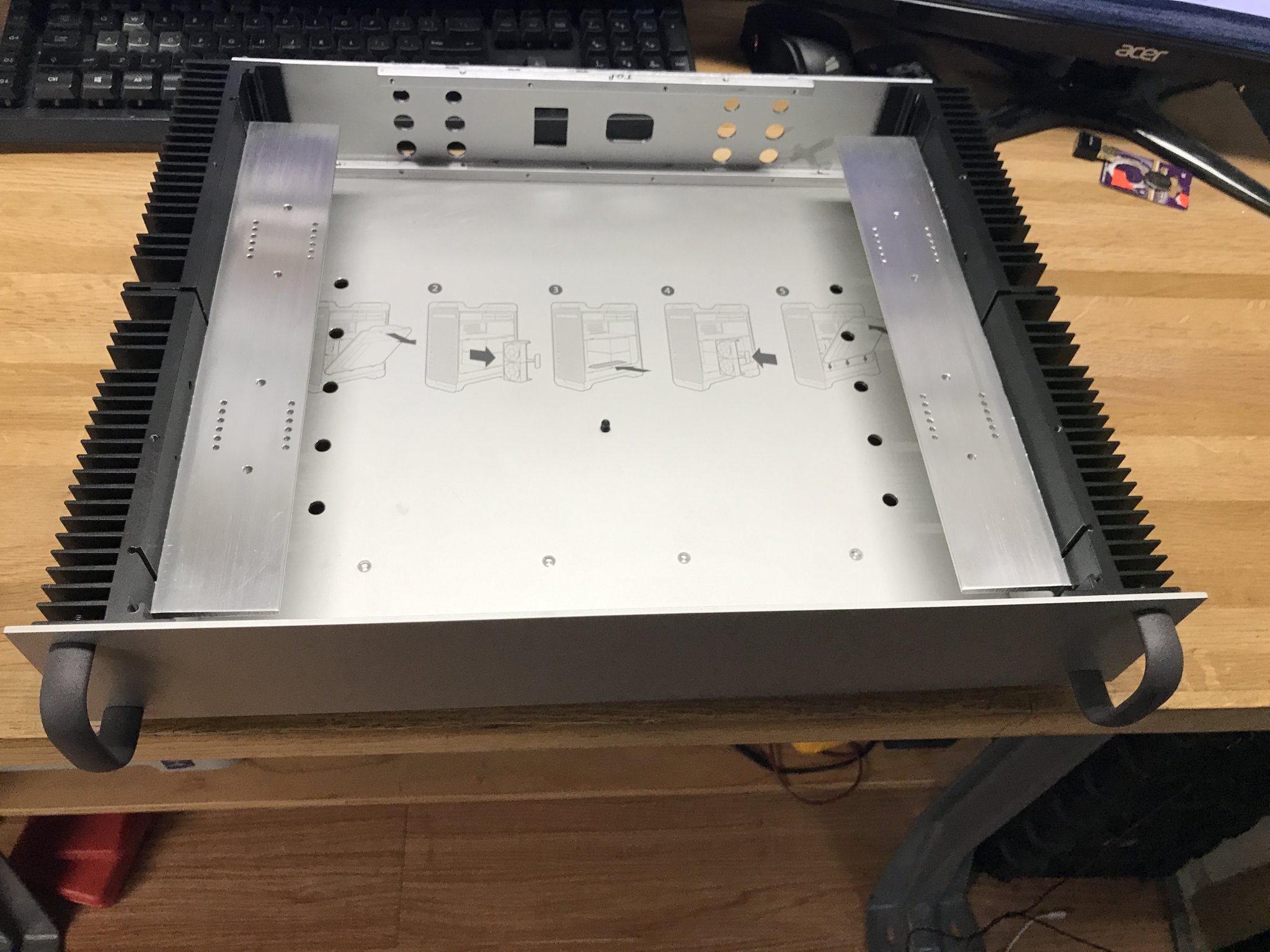

My third build using Apex Microtechnology power op-amps. This one with the high power PA04 MOSFET chip since the amp was built to drive four subs. The design has 4 channels in a dual, 2 channel configuration, with two power supplies. One side puts out 2 x 140W into 4R when both channels are driven just below clipping. The PA04 chip is capable of 400W according to the data sheet, but I certainly don’t need 4 x 400W at home, and I wanted to get it all in a 19” 2RU case anyway.
The case is made mostly from recovered e-waste with the aluminum panels from an old Apple G5 Mac and the heat sinks from industrial servo drives. The extruded brackets, handles and feet were all that was purchased for the case.
Been listening for a while now and very pleased with the results. Thanks for looking.

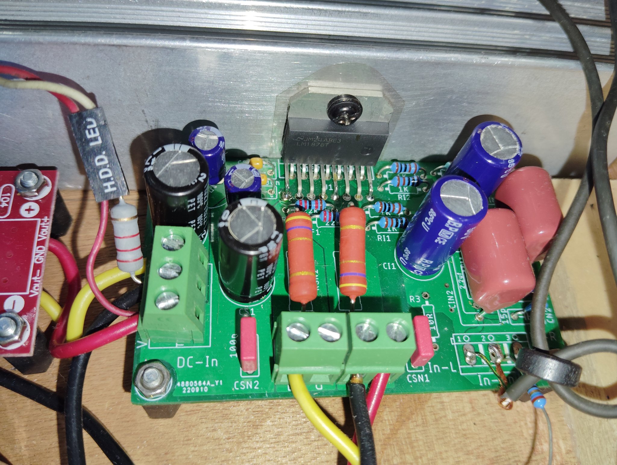

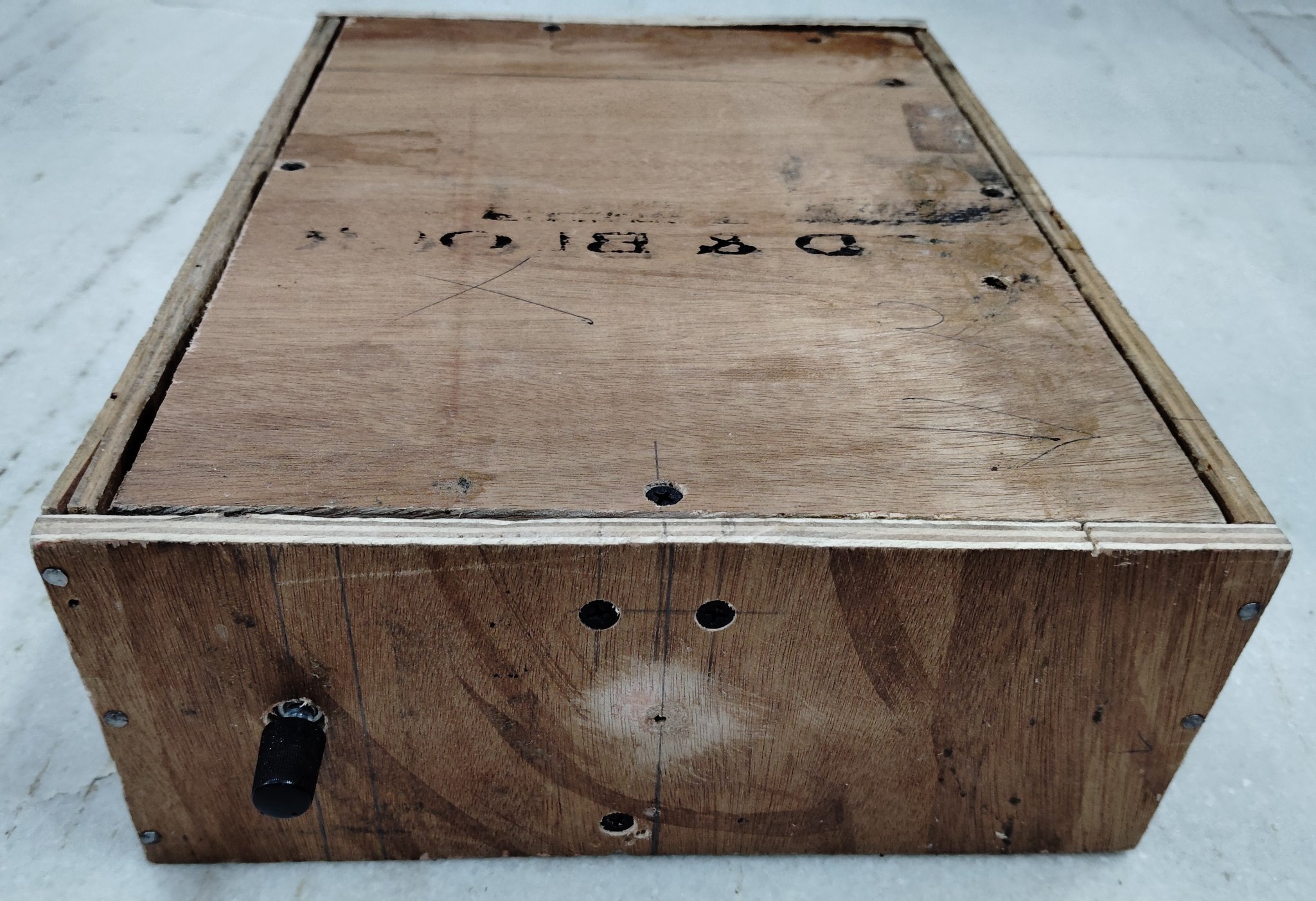

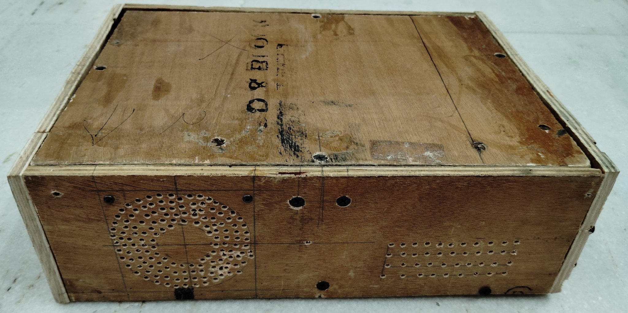

Hi

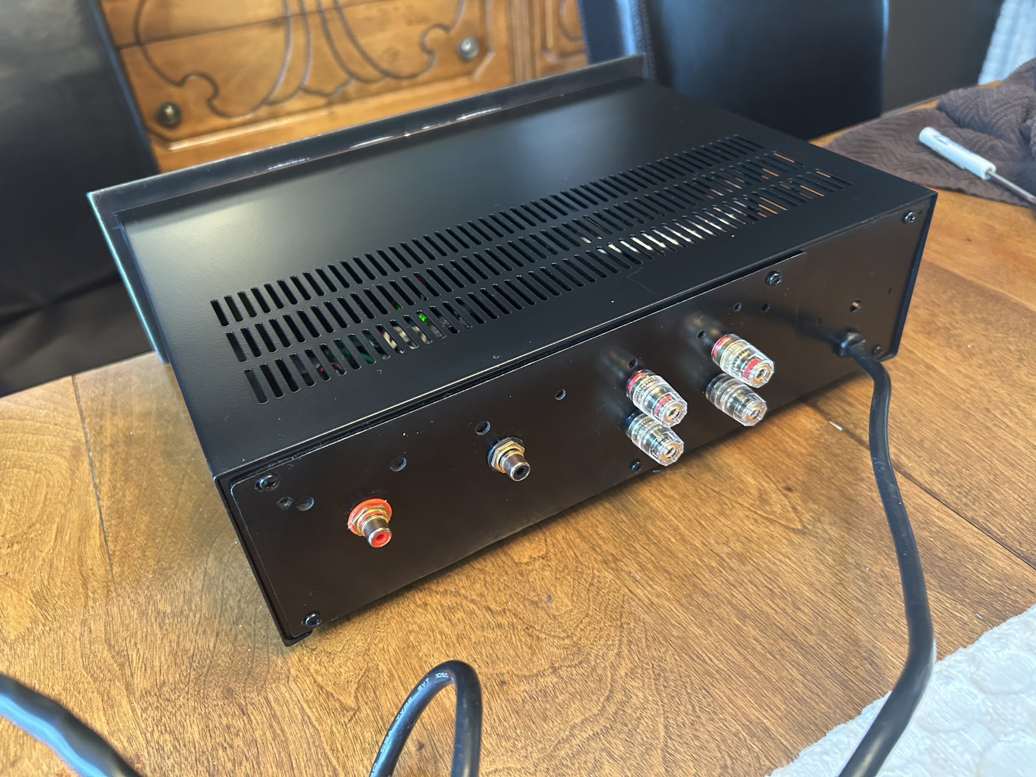

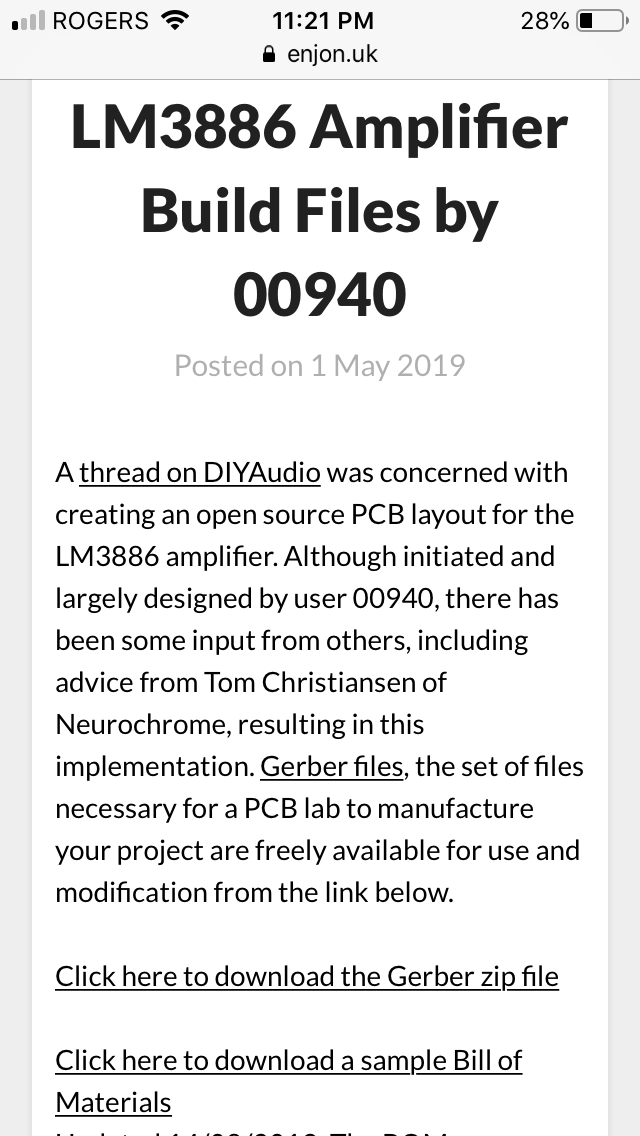

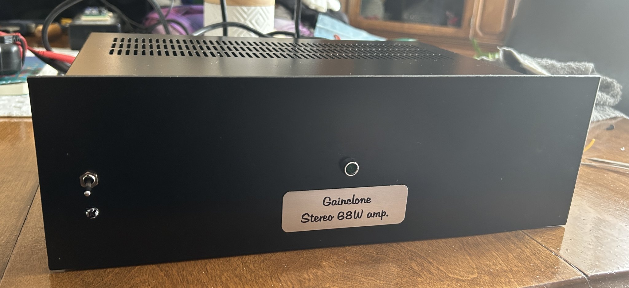

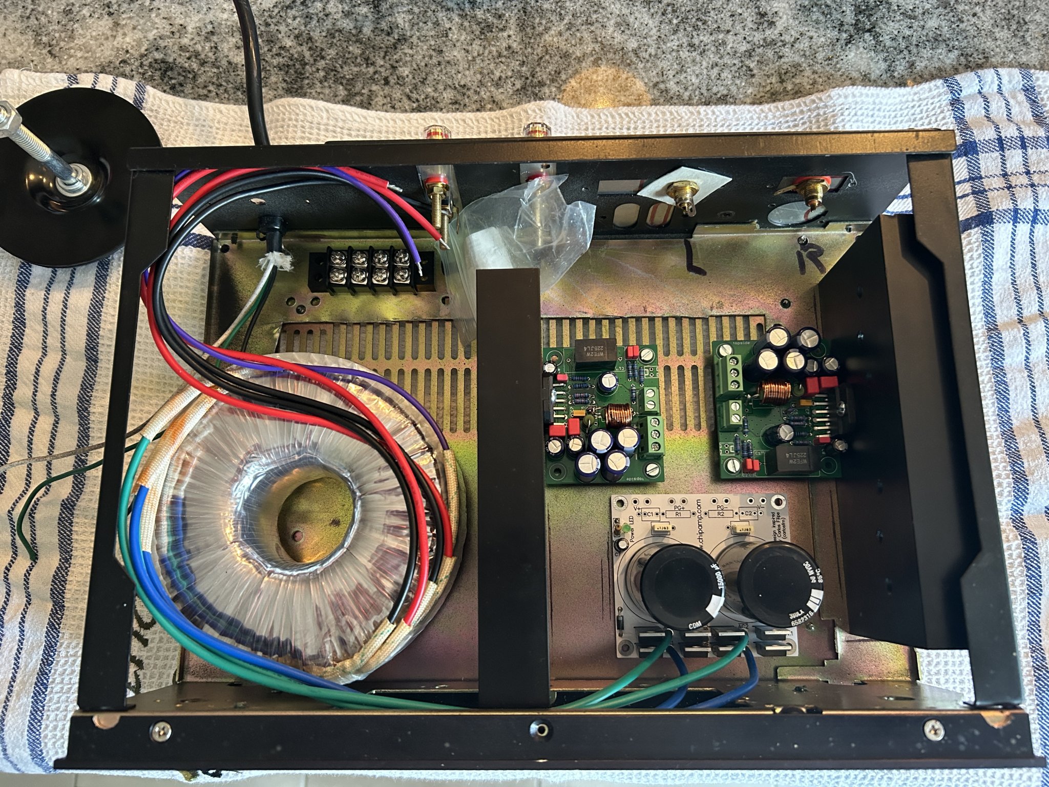

Many years ago I had built a stereo LM3886 amp and since my brother in law literally fell in love with it, I gave it to him for his birthday.
I caught the bug to build another one so I bought the amps board ready built (based on the open source PCB layout by member 00940) in swap/meet, got the enclosure from a friend, read some stuff and then decided to buy a 200VA, +/- 20Vac, etc…. Filtering capacitors are 15000uF per rail. Rails (no load) is +/-27Vdc. I then ordered a label for the unit (trophy guys on eBay)
So everything is new except for the recycle enclosure 😀
This amp is playing very nicely and has guts when needed.
Below are some pictures and where I took

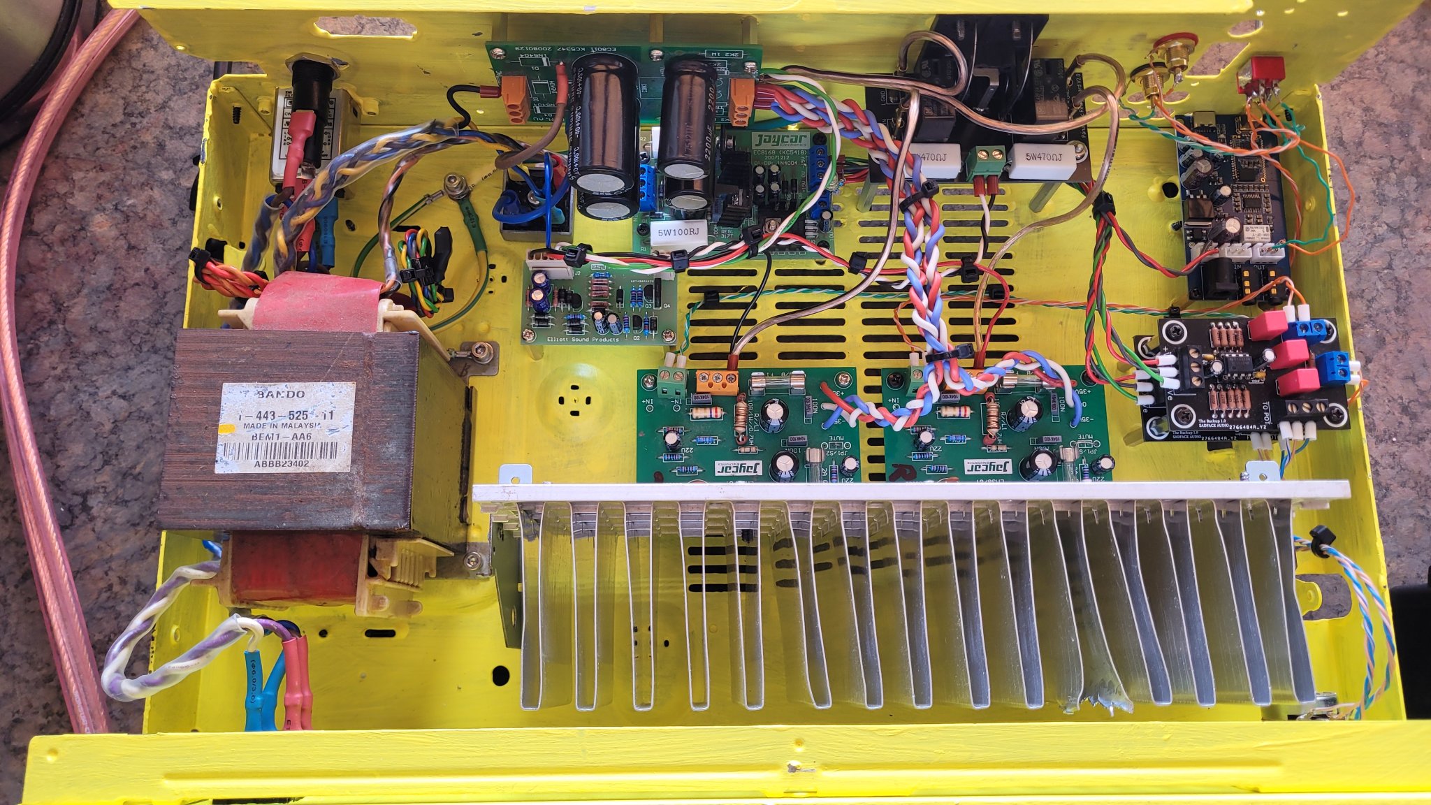

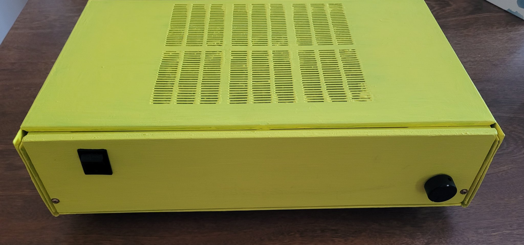

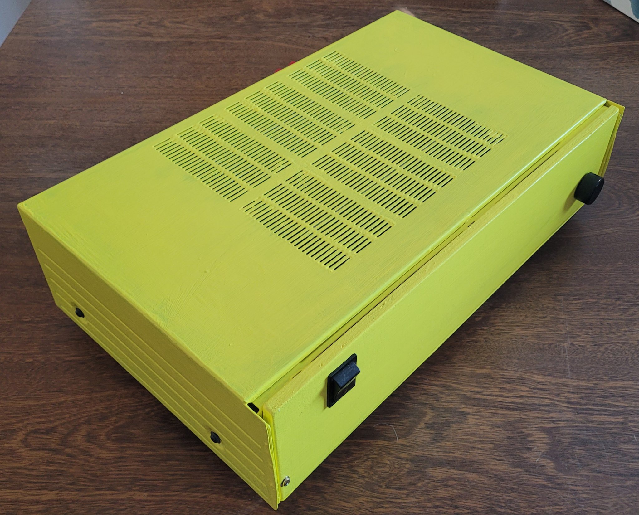

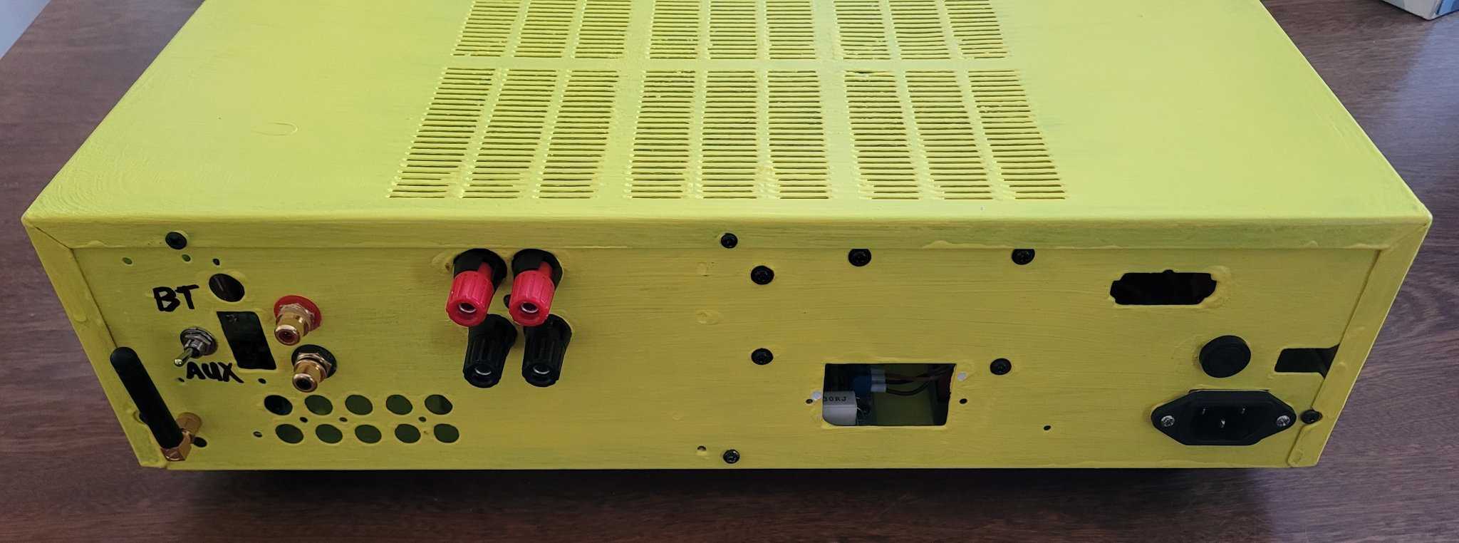

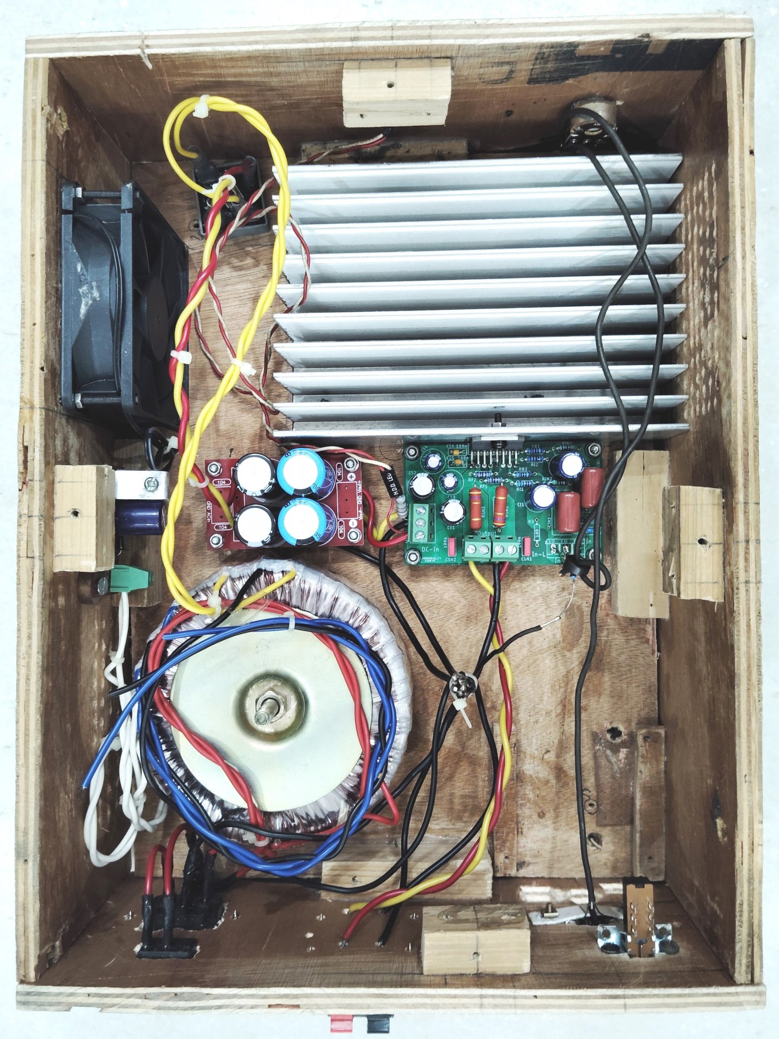

My latest and most hideous creation!
This was a throw together made in haste combining some experiments in construction with what ever was lying around. The idea was to make a bluetooth amplifier for my basement while I build stuff.
It is a hodge podge of scrap parts and old projects that have been sitting around along with a couple of experiments.
The result is a deliciously ugly success. The high vis yellow should hopefully accidents!
Full build details here:
https://www.diyaudio.com/community/...ogether-for-the-basement.416216/#post-7763788
Nice. My build (LM3886) was very similar, even down to the heat sink! In a re-purposed chassis too. I left it unpainted and made a wooden front but otherwise it's remarkably similar. I posted mine here somewhere, quite a few years ago I think.
Oh, and mine didn't have BT, but I see that I have a board or two and some power boards that would work lying around awaiting a project. Perhaps I should add that to mine too!
