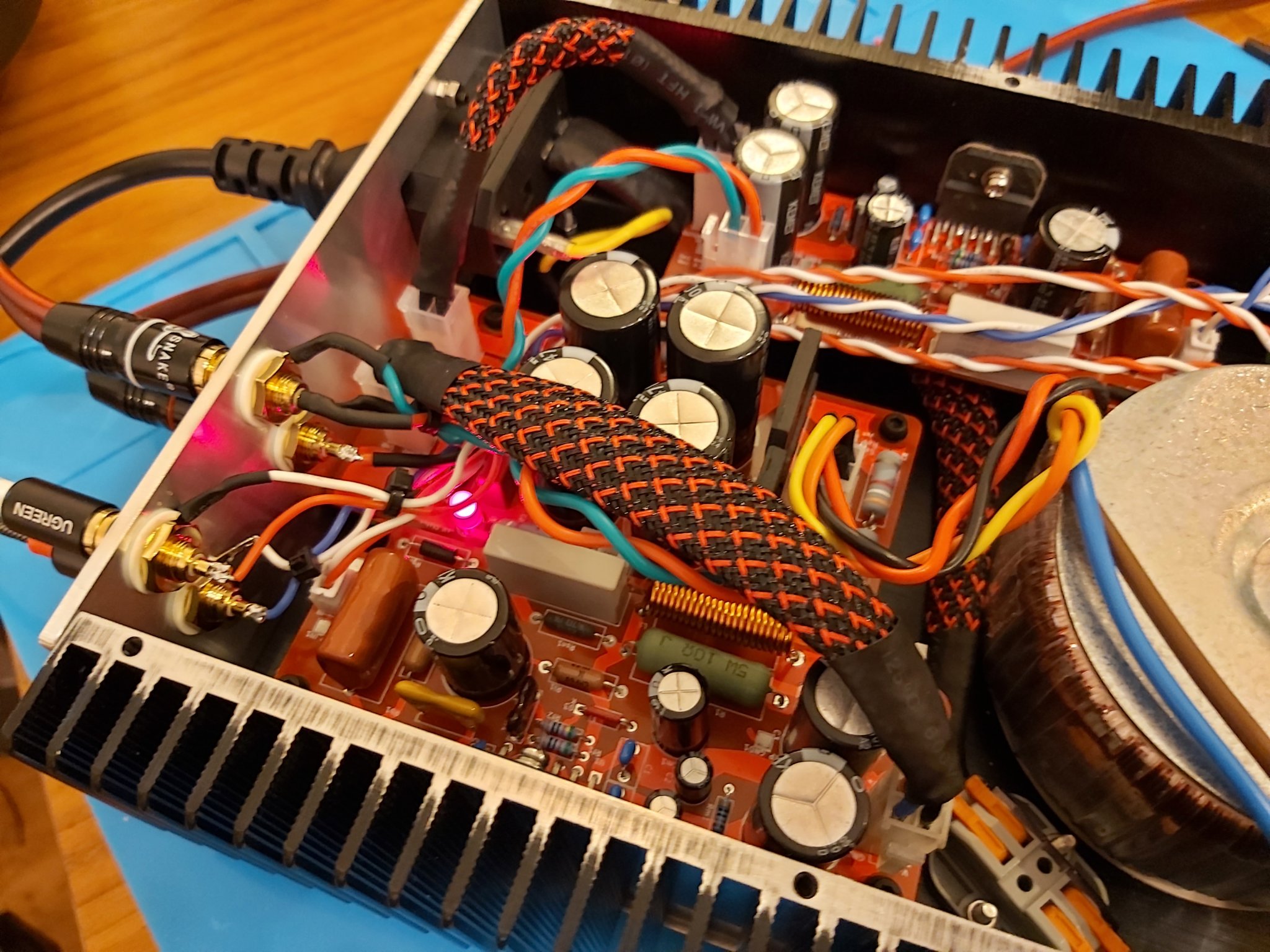

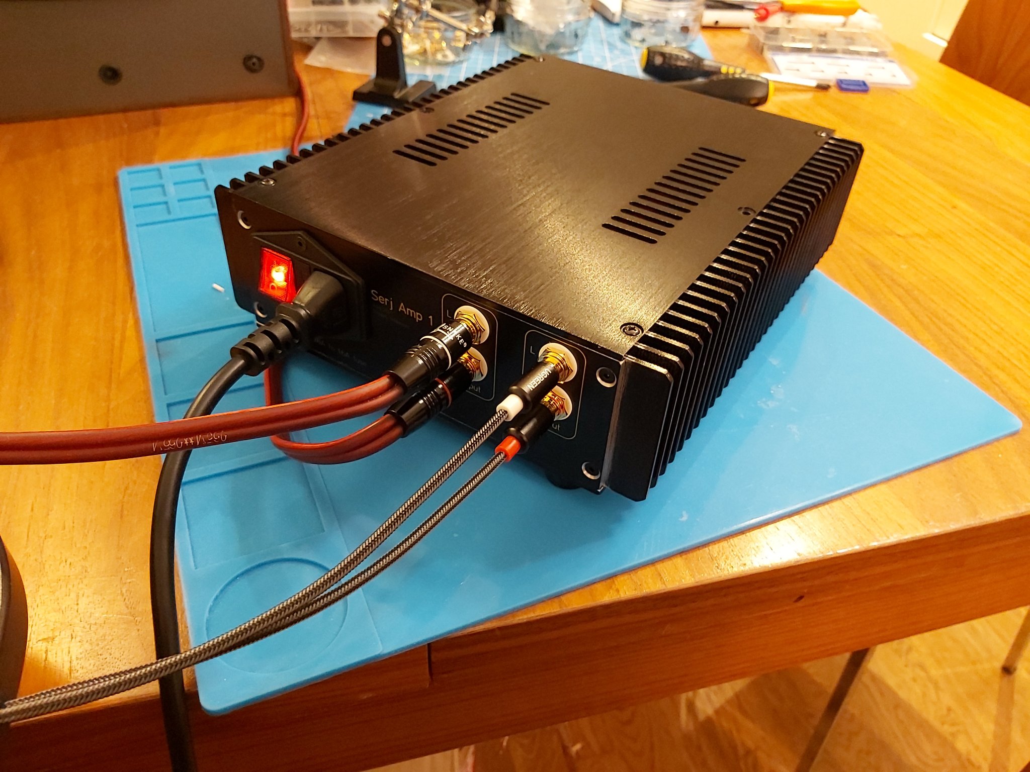

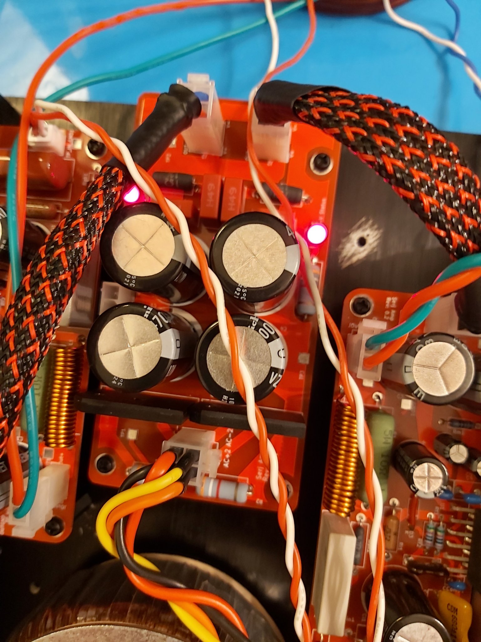

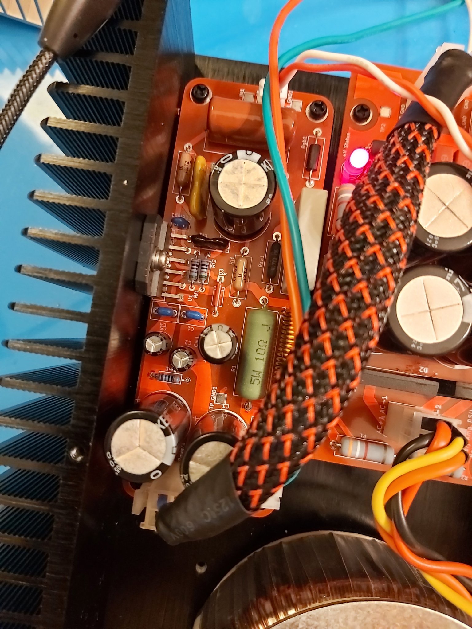

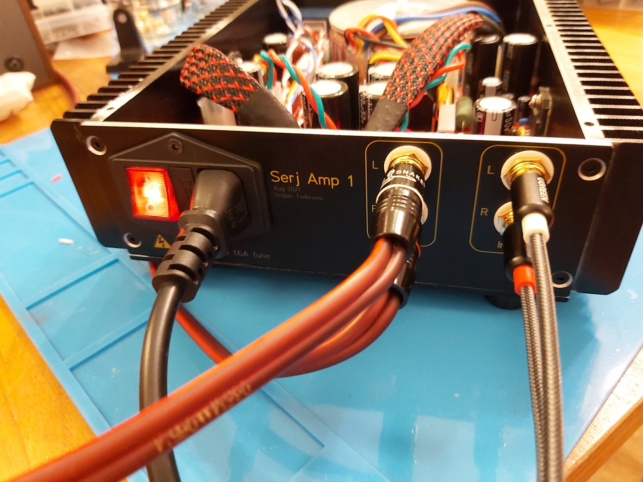

Spent 2020 lockdown doing a prototype version of an LM3886 amp. Bit of a progress between the first photo and the latest.
And now use this amp every day (still need to get better front-panel for it).

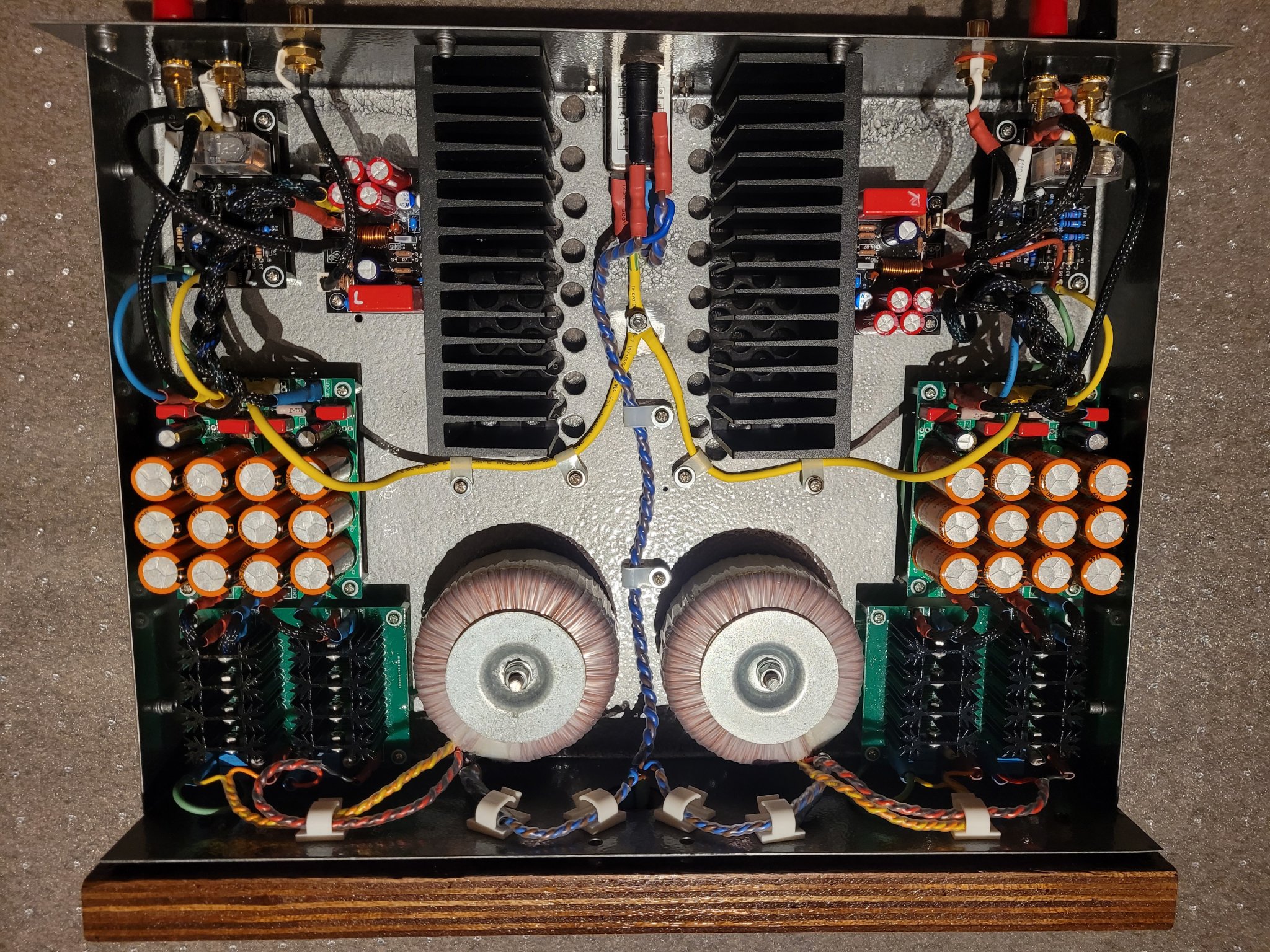

G'day Guys,
May I present a project I've been brewing for a while.
A dual mono gainclone using 00940's LM3886 boards.
The rest is all home brew: chassis, cap banks, rectifier boards, speaker protection boards etc.
It's been quite the experiment. Many things I will do differently on the next power amp but this one was designed as a backup amp so mistakes and learnings are ok!

Love the tight twisting of pairs and the separation of power from signal!G'day Guys,

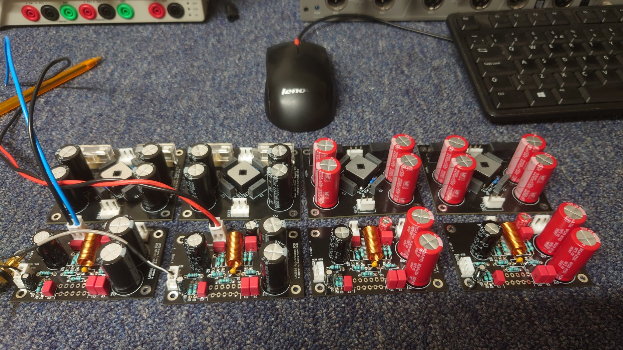

Bottom row: LM3886 Gainclone PCBs. Not minimalist, but minimal. Specifications agree or better than those stated by IC manufacturer.
Top row: 5A fused AC-DC power supplies with individual rectifier diode snubbing. Transformer used, 22-0-22V AC nominal all large capacitors 50V but to be fair, 35V will have been quite adequate.

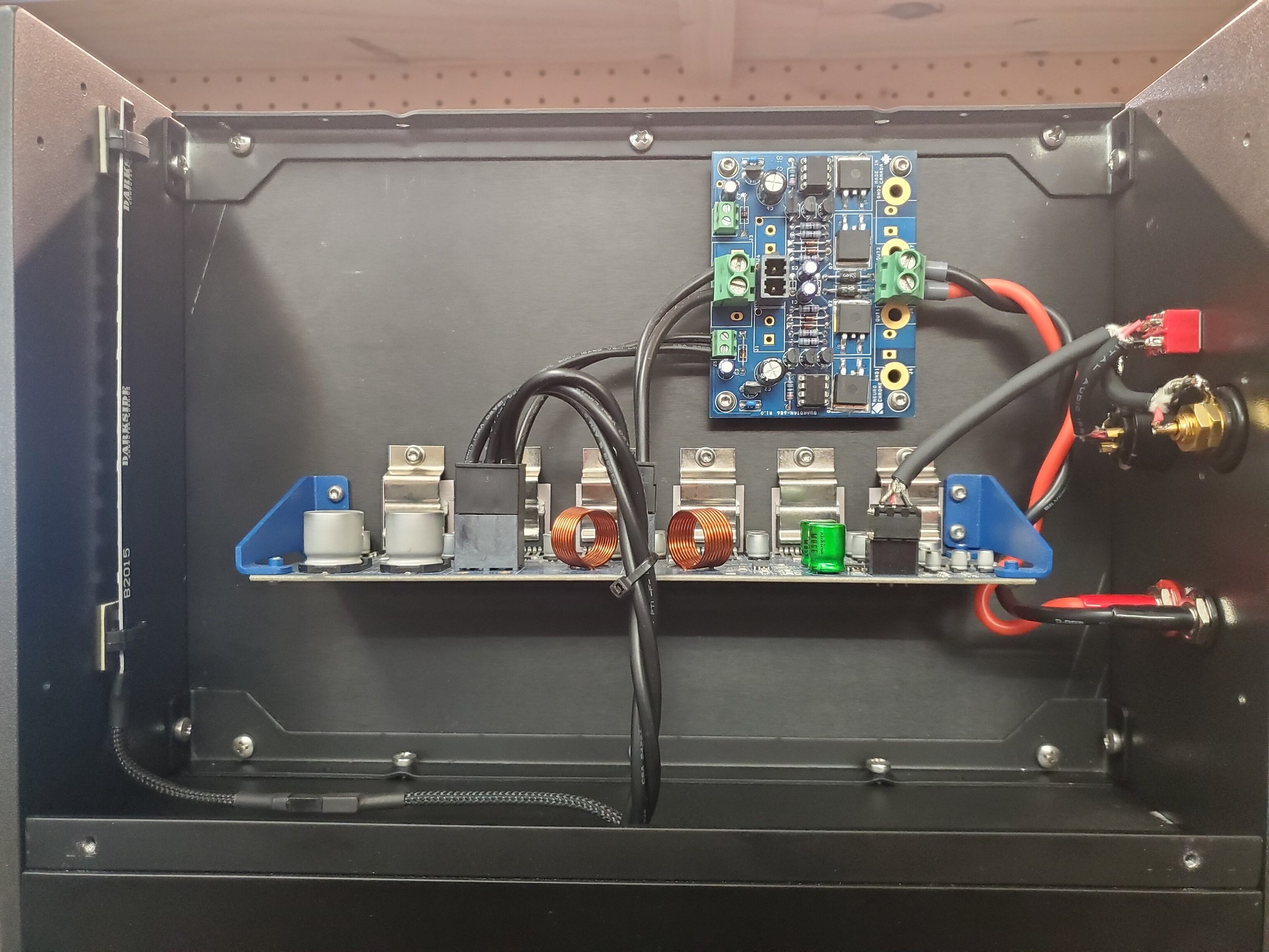

This China-board with parallel TDA7293 has been driving my sub for the last 2.5-3 years. With +/- 33V I was quite satisfied with the performance at a 12" in 50l cb.

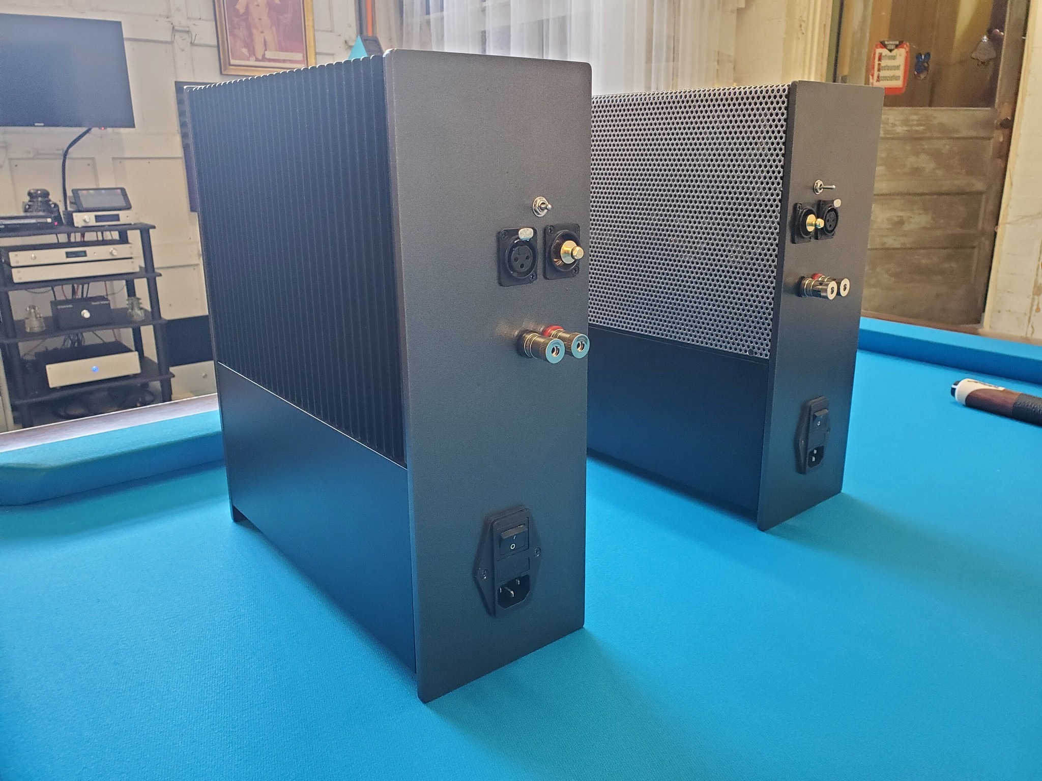

Here are my vertically oriented & mirrored Modulus 686 monoblocks. These have been 'nearly finished' for years. I just finished DIY powder coating the panels.
"Top row: 5A fused AC-DC power supplies with individual rectifier diode snubbing. Transformer used, 22-0-22V AC nominal all large capacitors 50V but to be fair, 35V will have been quite adequate."
If I understand correctly- you are using single transformer, but multiple bridge rectifiers+filters? So each chipamp module has its own rectifiers + filters set. Can you please elaborate advantages/ disadvantages of such setups

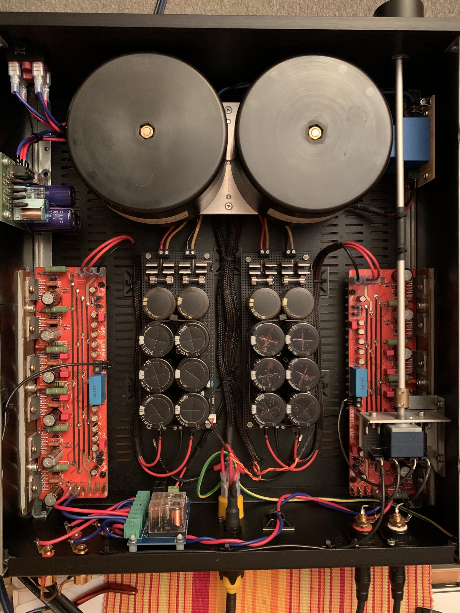

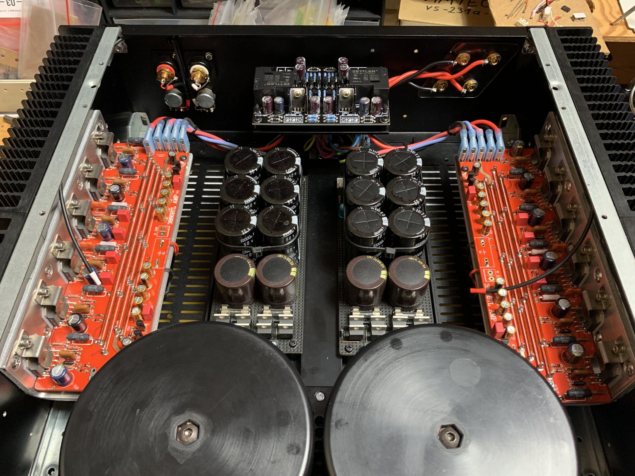

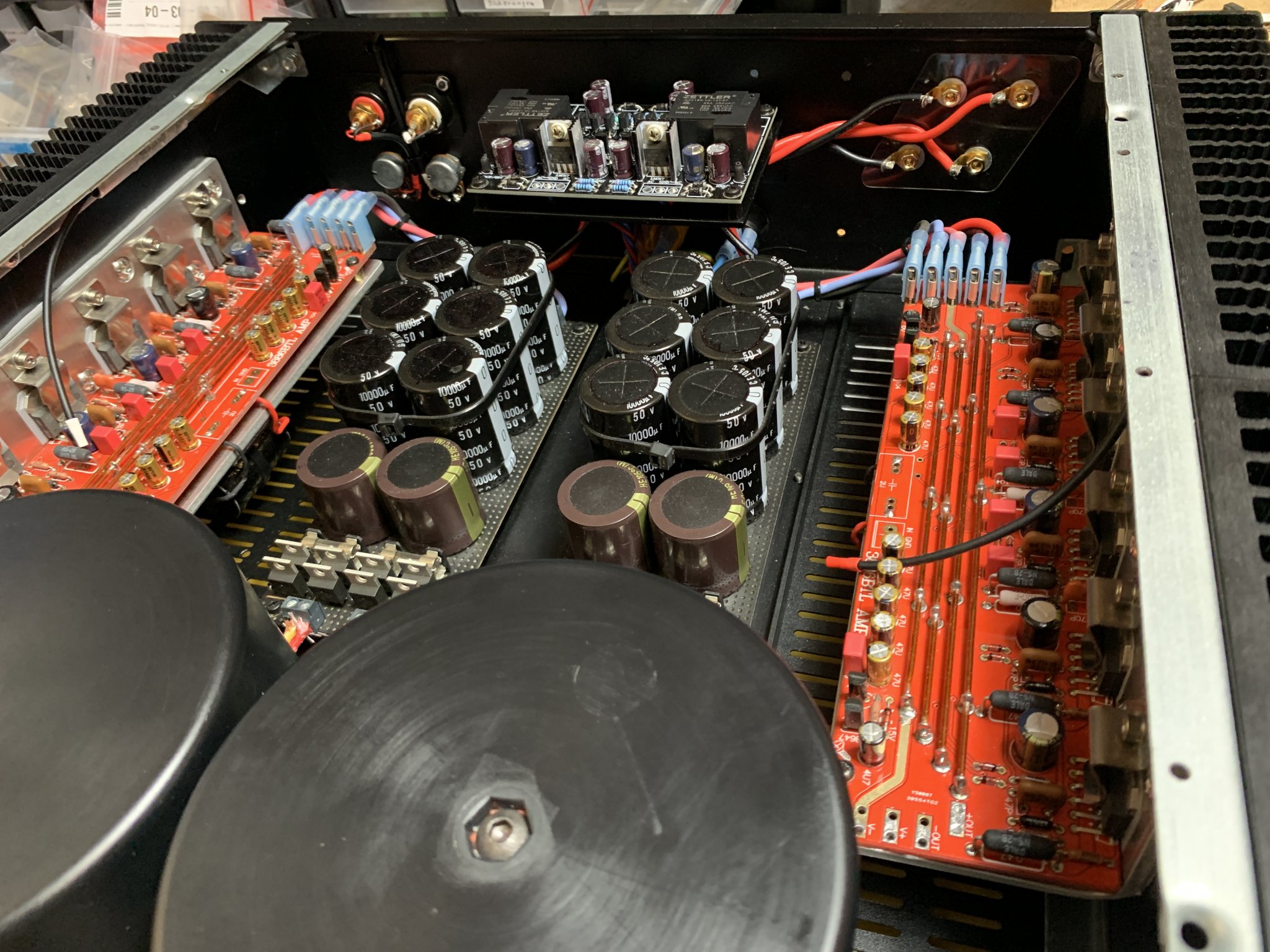

Hello,

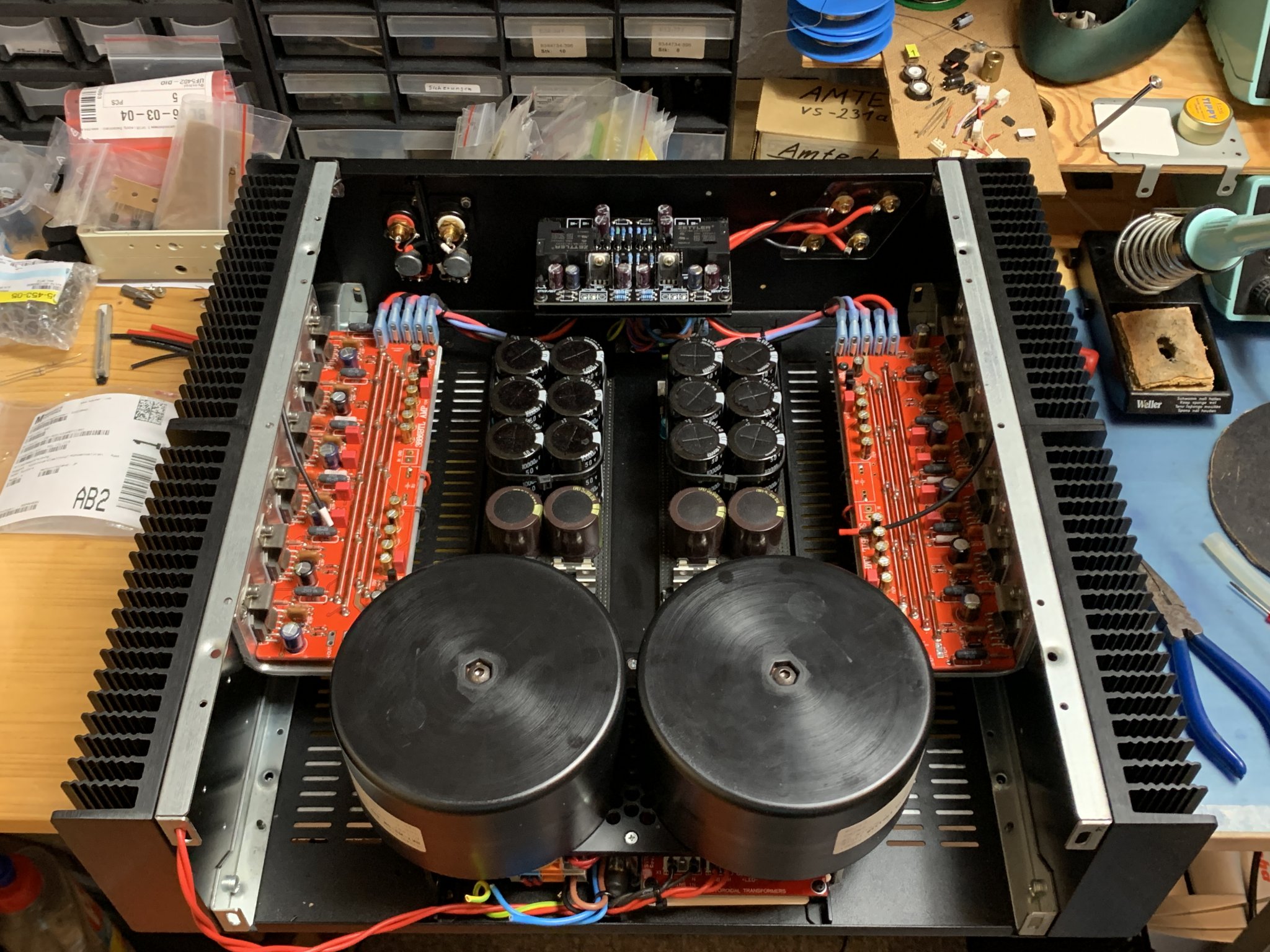

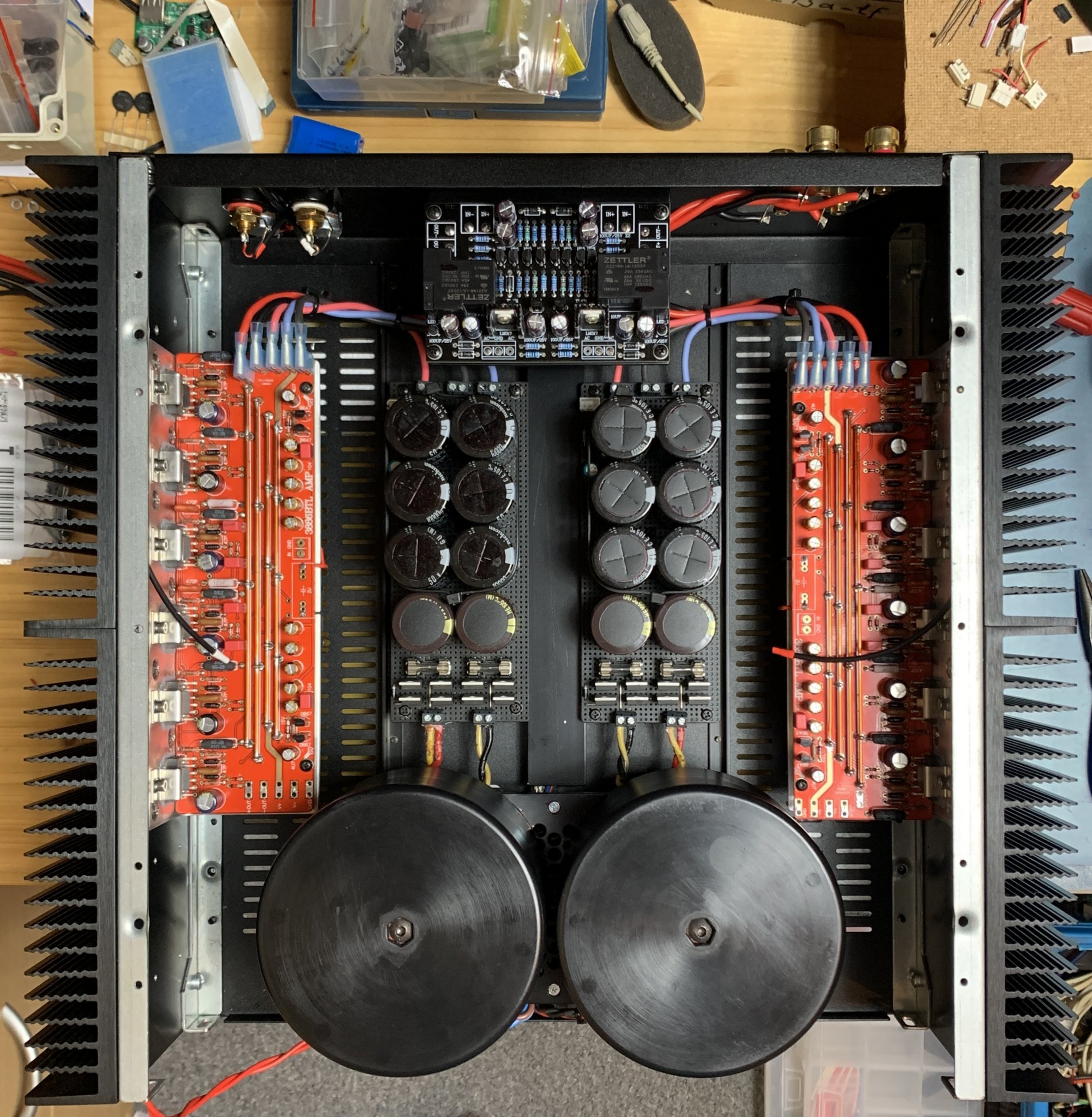

I built this power amplifier 6 years ago and started to completely rework it during the Corona period. That's the current status. I still have to adapt the secondary lines (I don't like wires, I prefer stranded cables) so that the transformers finally find their place. I still need to solder the signal wires and continue assembling the case. Unfortunately, by the front panel is left for the time being, because I don't want to take over the old one and I don't have a new one yet.

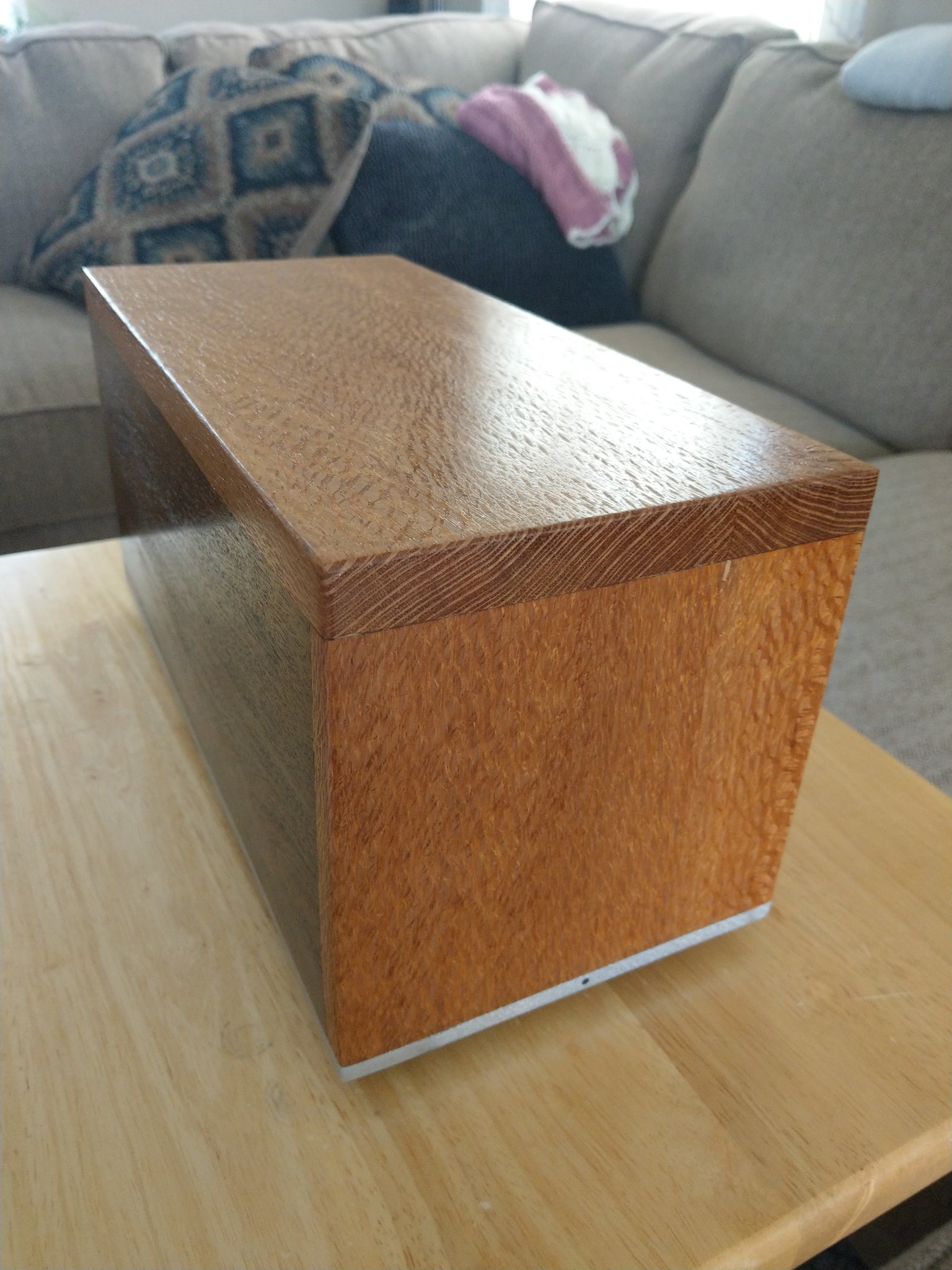

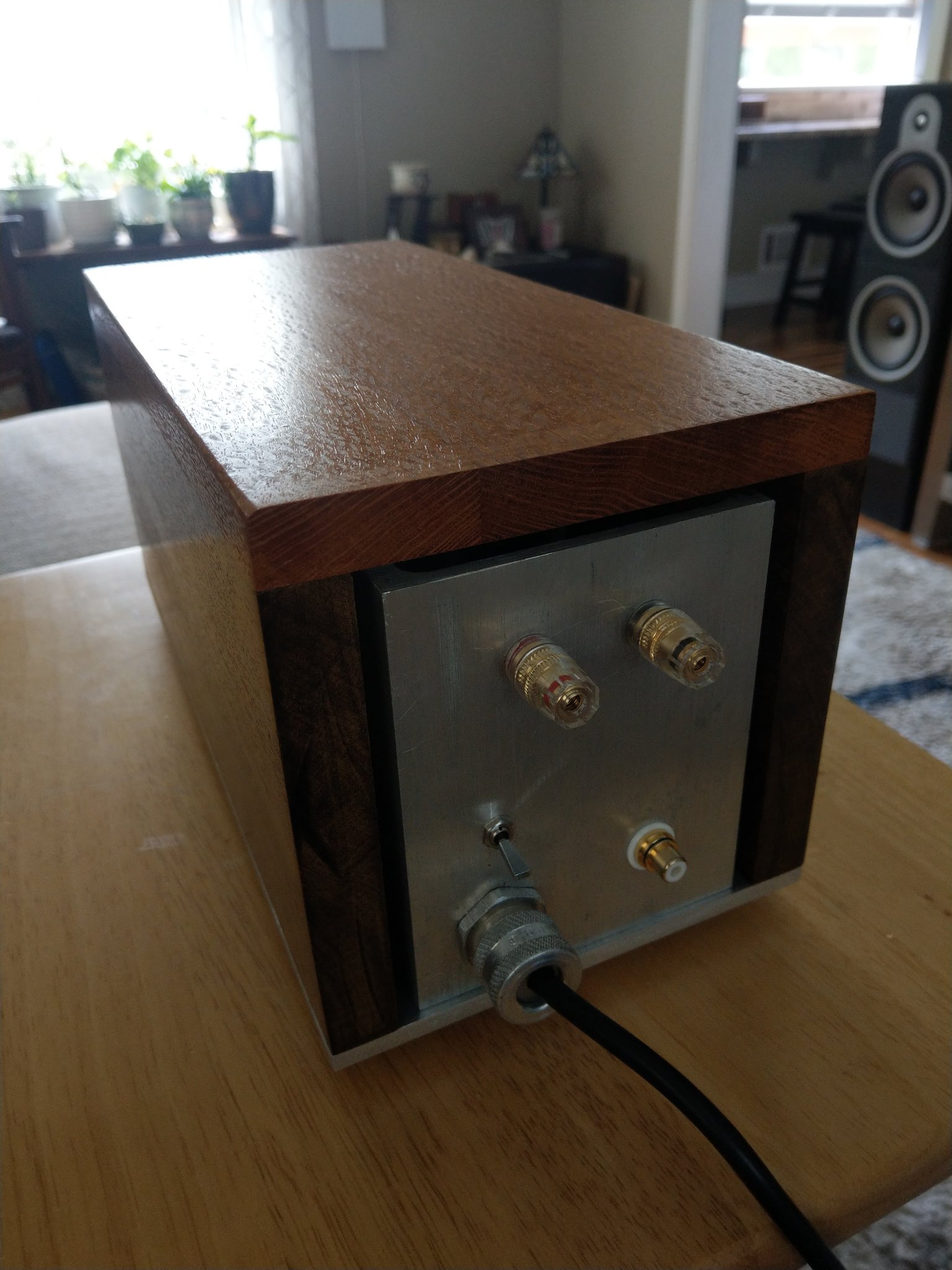

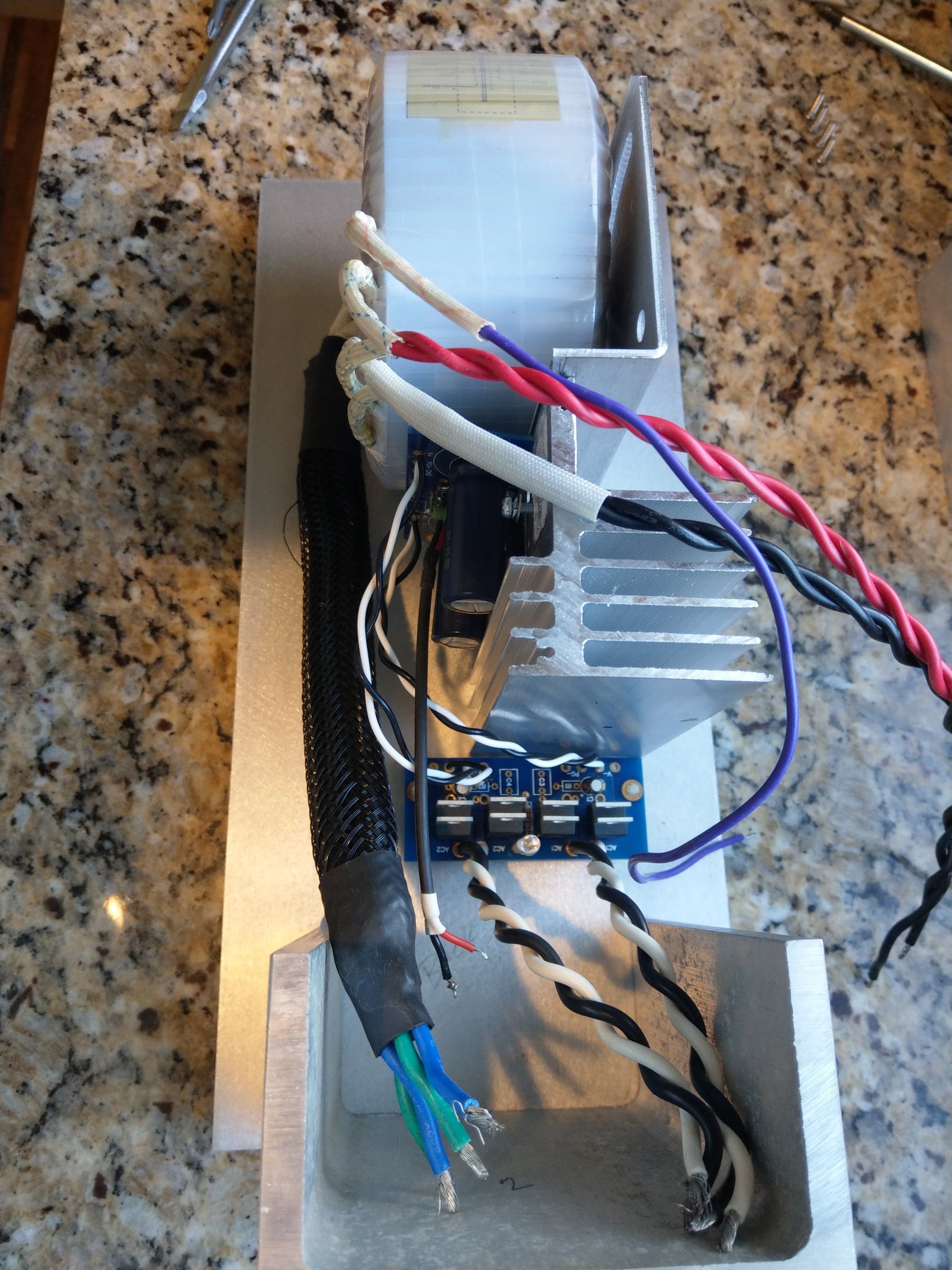

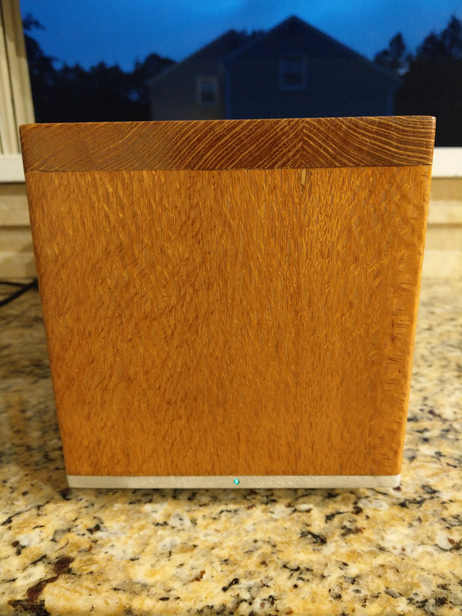

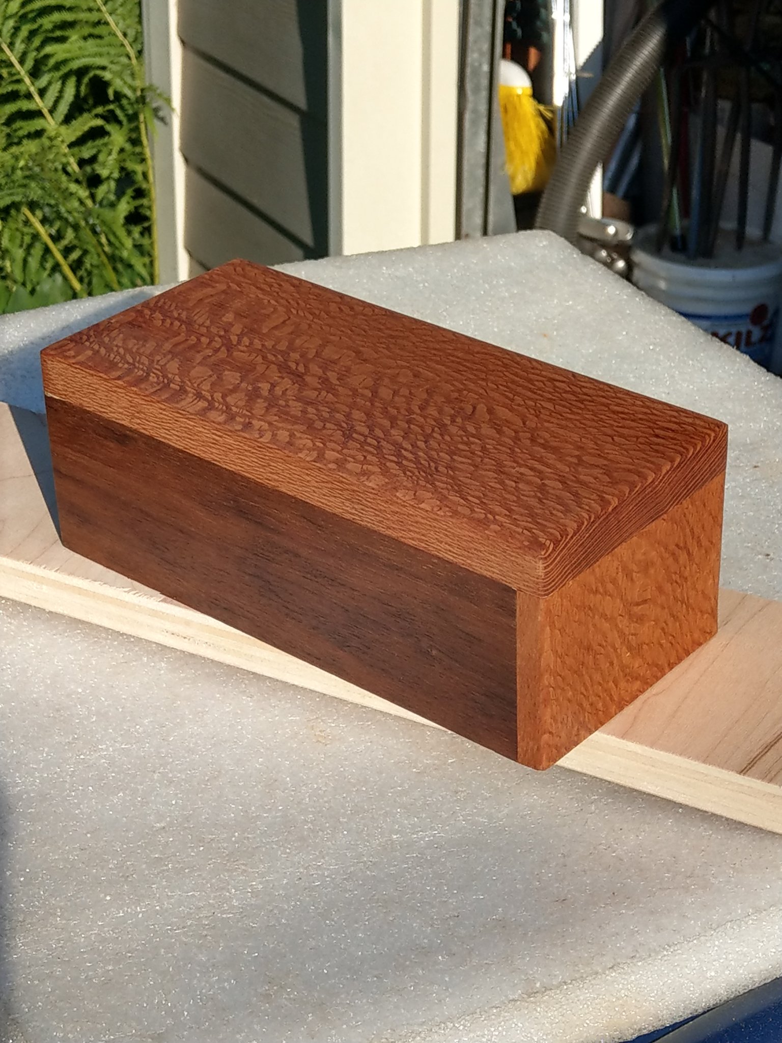

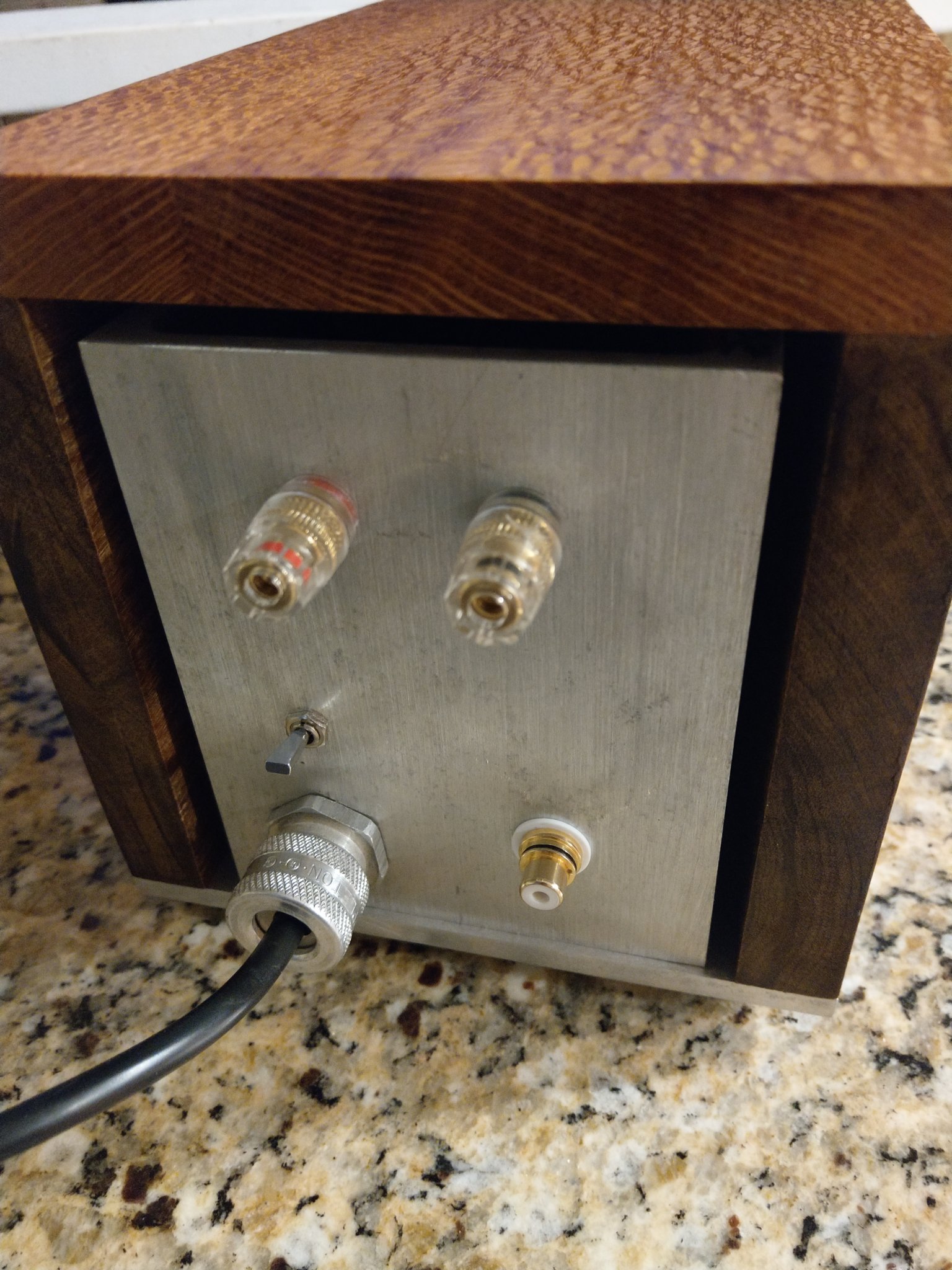

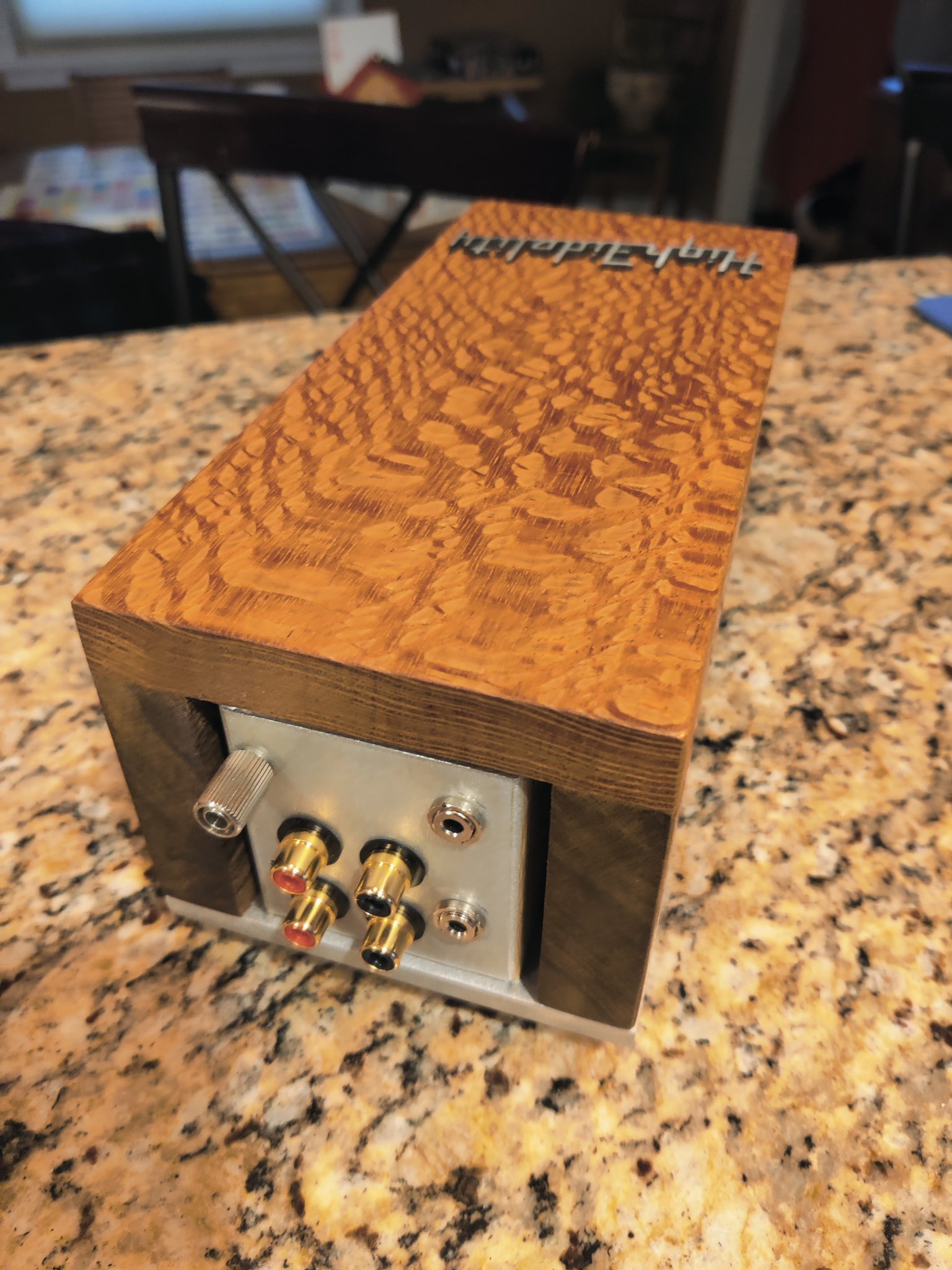

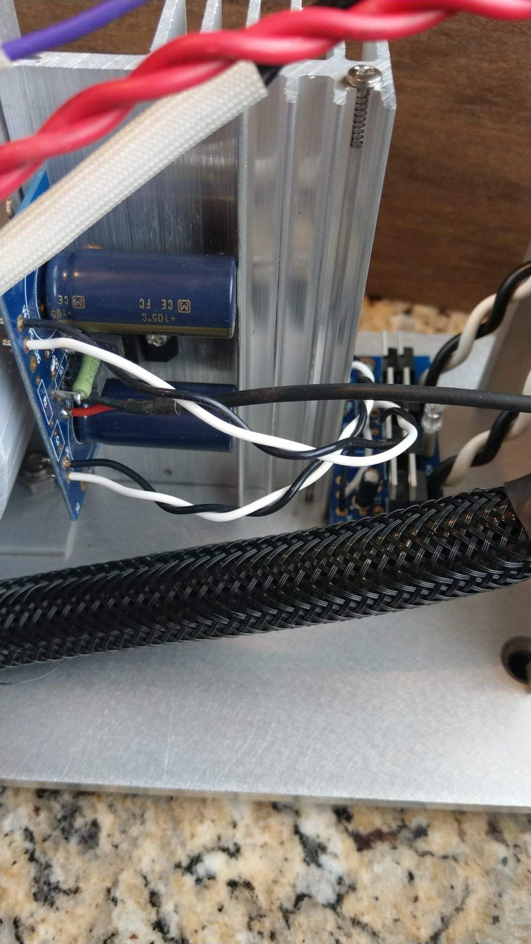

Finally! it was a very long journey with my audiosector kit from 10+ yrs ago. I found the hardest part was a home(case) for the amp and PSU. In the end mono blocks with a simple passive matching theamed pre amp. I carried the indicator LED via fiber optic to a small hole 1/16" on the base plate. I didn't want to take away from the beauty of the wood🙂 I have been driving a vintage set of B&W 500 series floor standers, the listening experience is most pleasurable.
Absolutely stunning, and that is incredible wood!
How does the heat get out?
the back of the amp is not sealed, I guess it could also release from the bottom plate. theres quite abit of aluminum and its all conected together with thermal paste.Absolutely stunning, and that is incredible wood!
Used the Audiovector brds myself. Use my chip amp in system #3 around the TV with a SS preamp driving Markaudio speakers. Built mine in a 1U enclosure with two low profile trannies. Love your timber enclosure.
