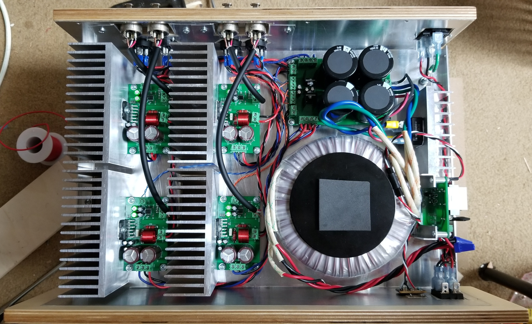

Here's my four-channel LM3886 amp with balanced inputs and soft start. All circuits and board layouts are my own design. I'll probably publish the schematics and board layouts before sometime soon (if there's interest). I also have some extra PCBs I could sell.
The amp is very quiet (despite the proximity of channel 4 to the power transformer) with no perceptible hum or buzz. Output noise should theoretically be somewhere in the 20-30µV range (A-weighted), but I don't have the means to measure this at the moment. DC offset is less than 1mV.

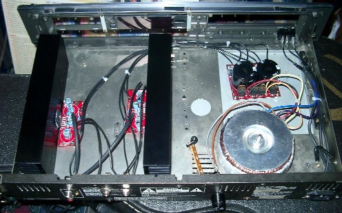

I built this one from chipamp.com PCBs but bought my own components from Mouser... RDV
Hi ! very nice amp ... i like the layout a lot.
63893d1147277622-chip-amp-photo-gallery-amp-8small-jpg
sorry ... i have a question ... why not move the PSU board with diodes and caps closer to the amps boards, placing it between the two ?
is there a reason to keep it instead closer to the mains transformer ? just asking ...
Your amp looks nice , are you planning to use those 4 channels for active speakers?

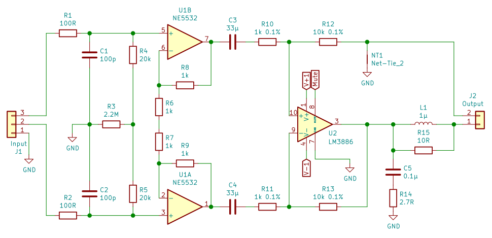

I would like to see the schematic if you dont mind,

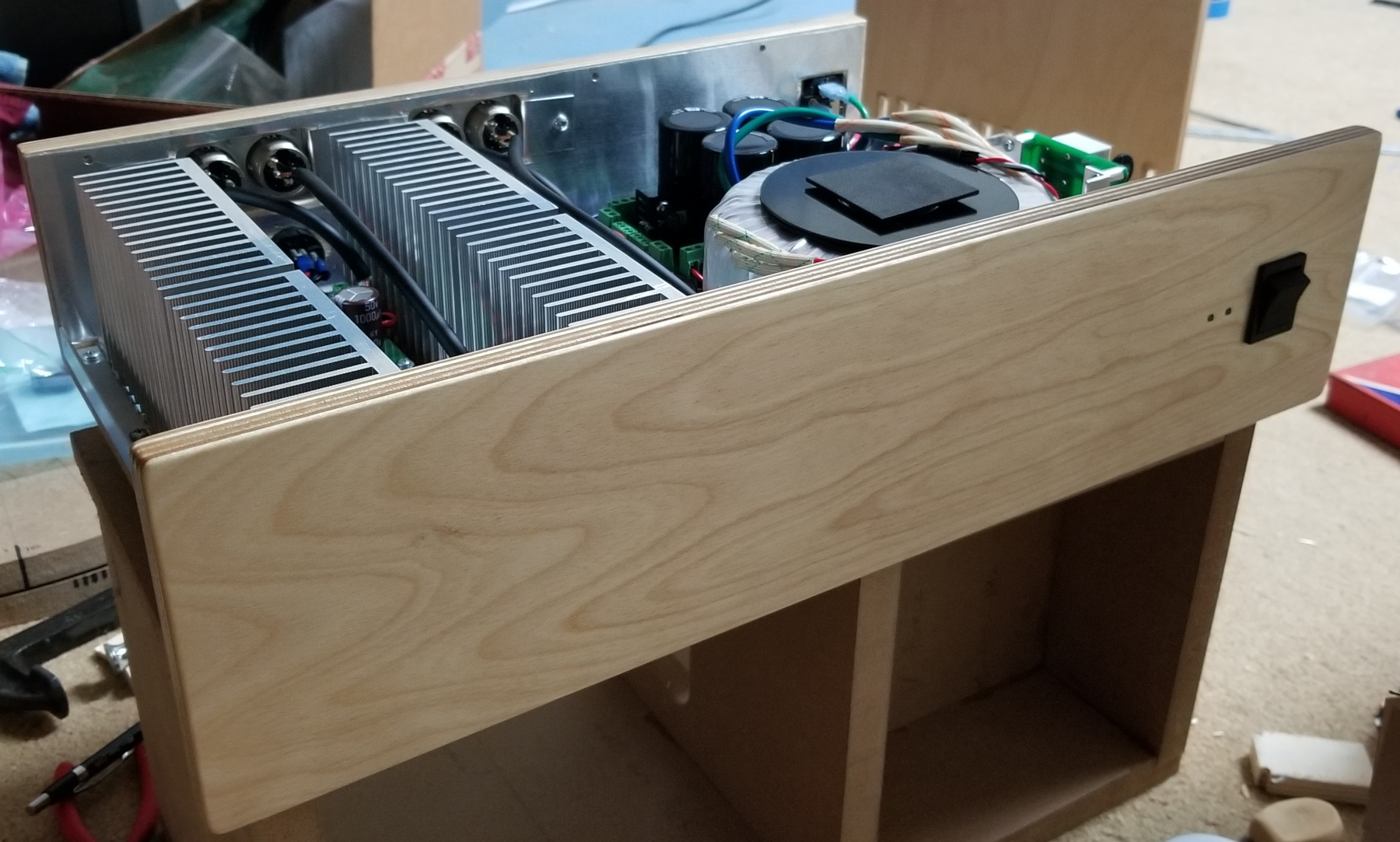

Yes, I'm using it for the big two-ways I built earlier this year. The amps I was using previously were too noisy (audible hiss at the listening position).
Here's the schematic (excluding power supply stuff):
attachment.php
It's basically just an instrumentation amp. The input buffers run off a ±15V regulated supply.
