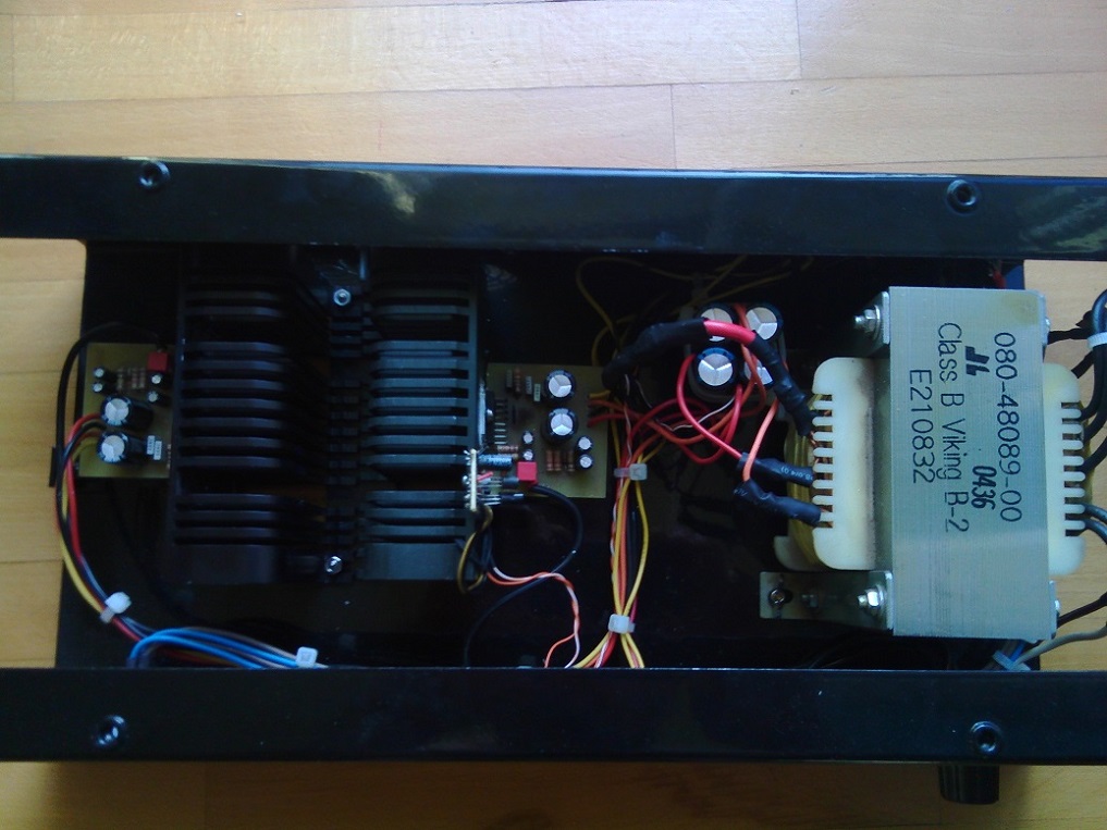

Hey all!
Just finished my first amplifier project! Before had only experiences on building couple of DAC´s from kit.
Here is the picture on the insides. Still need to apply thermal grease to chips and regulators, cut potentiometer shaft to fit knob and heat couple of heat shrink tubes.
I am really impressed on the performance. LM3875 chips drive 6 ohm/88dB wharfedales suprisingly nice. I am planning on building new speakers with audionirvana fullranges to pair with this amp!
Unfortunately I have just laid my eyes on myref as the performance of simple LM3875 design is so stunning. Maybe I will have two chip amps soon 😀
Lm3875 inside

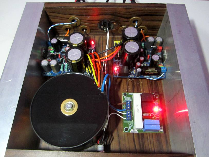

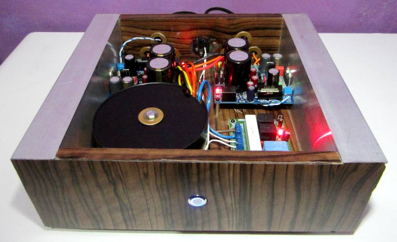

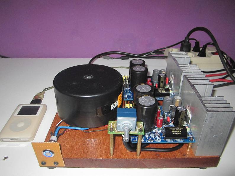

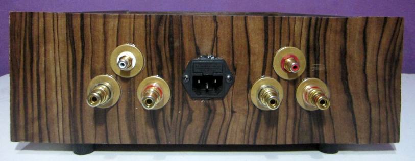

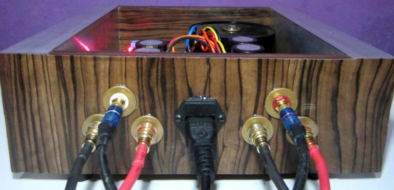

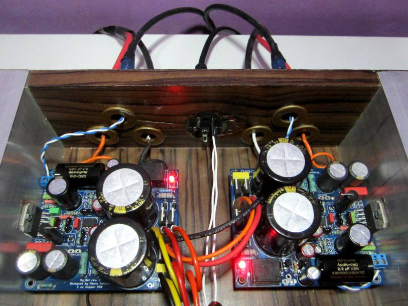

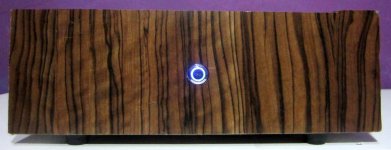

Finally completed my my_ref rev c. I have increased relay delay time by changing R21 into 470K, i get around 2sec delay as my expectation. another softstart also help much.
Never thought that my first amp will be this great 🙂
next -> pcb B1, DCB1, Aleph-J is on the way, more soldering is coming 😀
