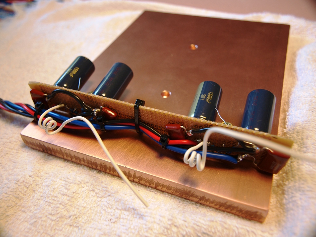

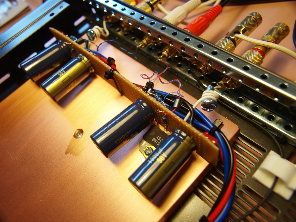

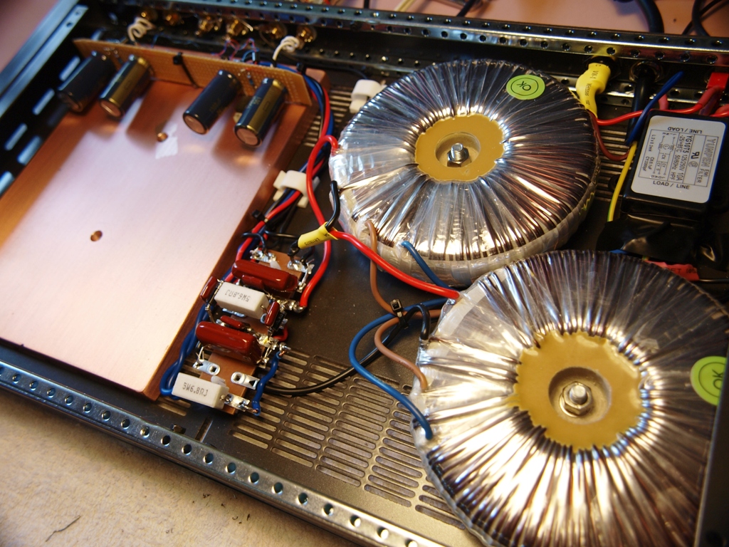

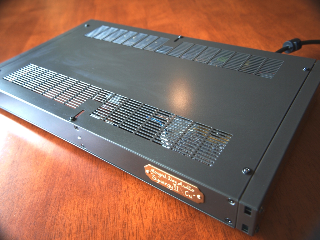

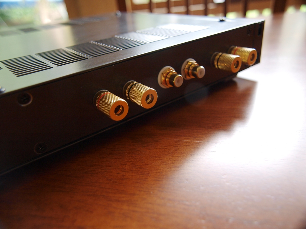

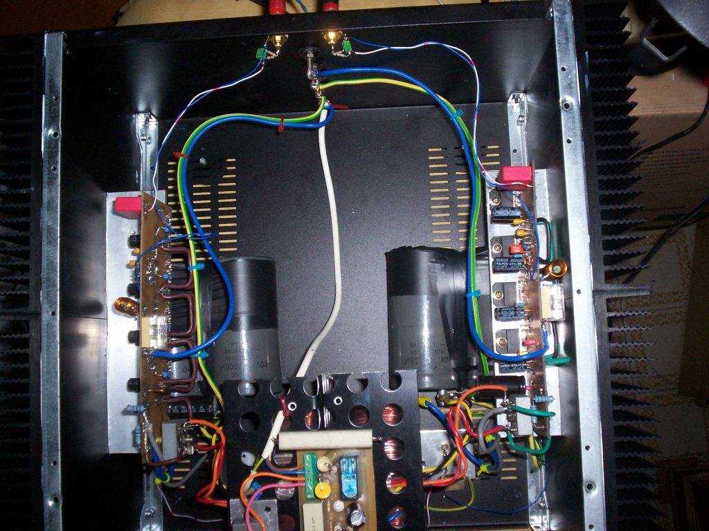

SynergyII\Cu started with 3.6kg of 100% very thick copper plate. The enclosure was selected, a 1U, 19” rack mount. The challenge was to build a pure Gainclone with its three resistors and simple 1500uf storage caps in a compact 1U enclosure. Everything had to fit in this tiny space including 48VAC of tranni, power filters and rectifier cct. Amp weighs 9.6kg.

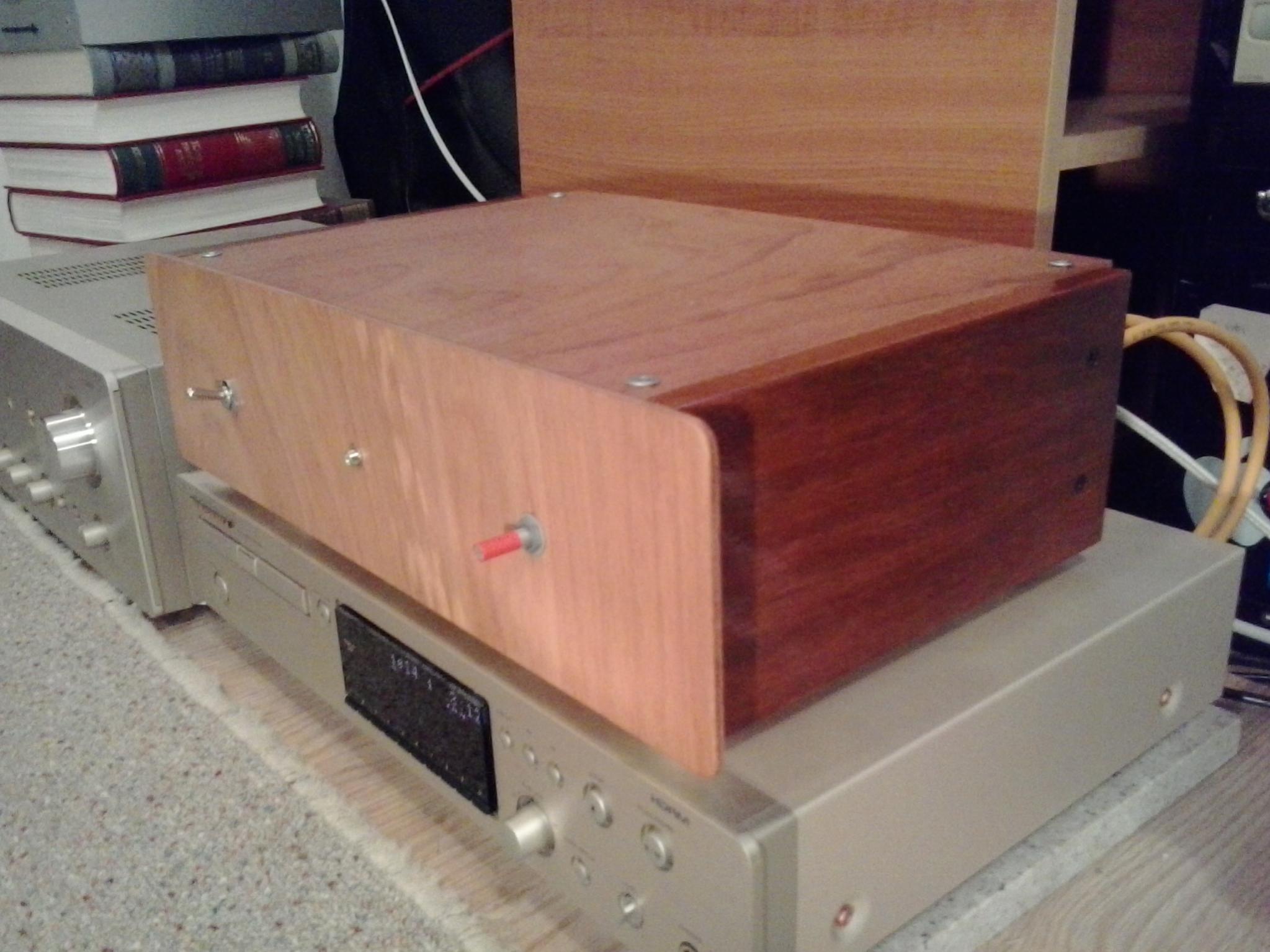

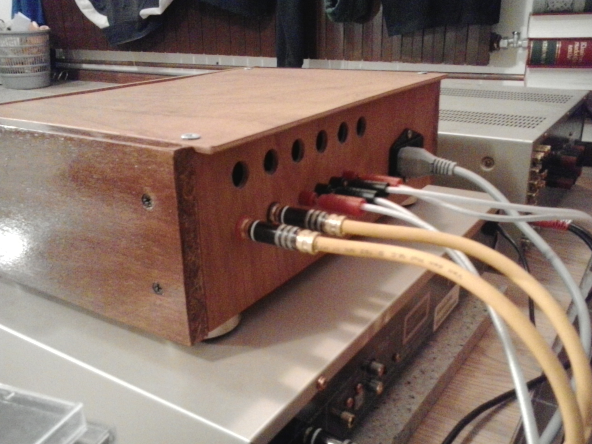

Just a bunch of wood with a gainclone inside, look very nice in person. The inside isn't anything special. A 250VA toroid transformer and a point to point LM3875 on a part of a CPU cooler
