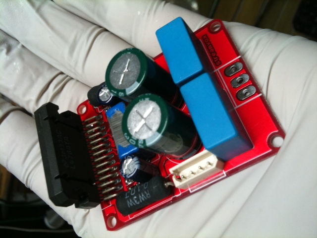

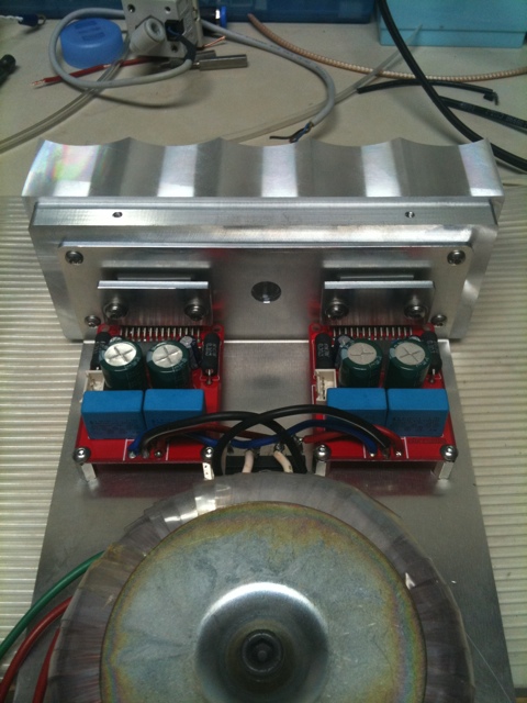

LM4780 parallel dual amp
WOW, this is an Oh My God kind of picture! Great job!

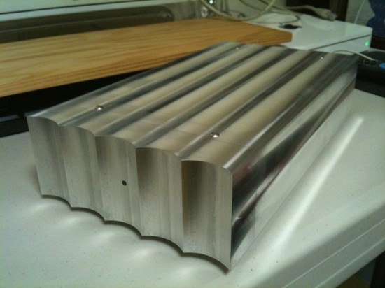

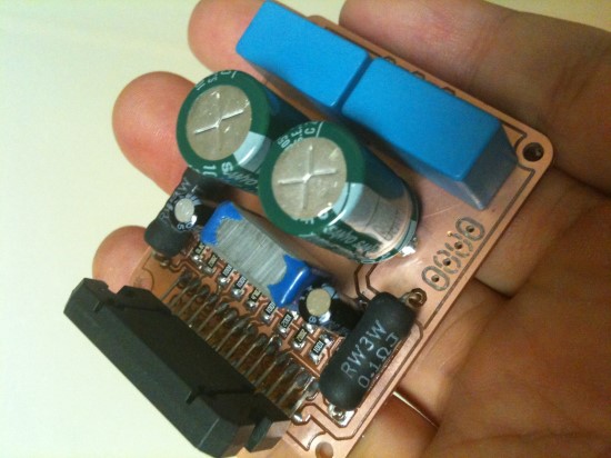

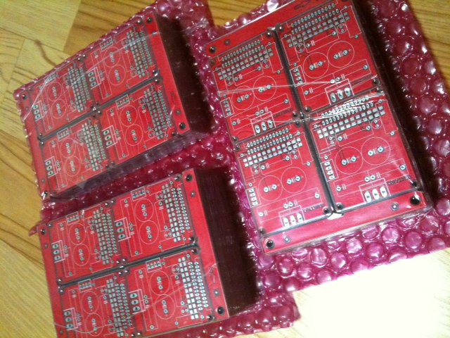

TEST PCB
Completion PCB 2layer cnc cut

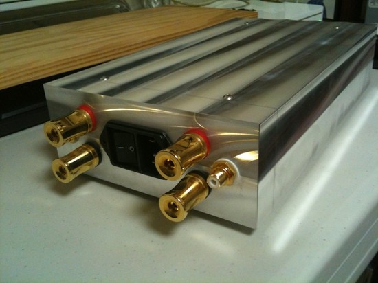

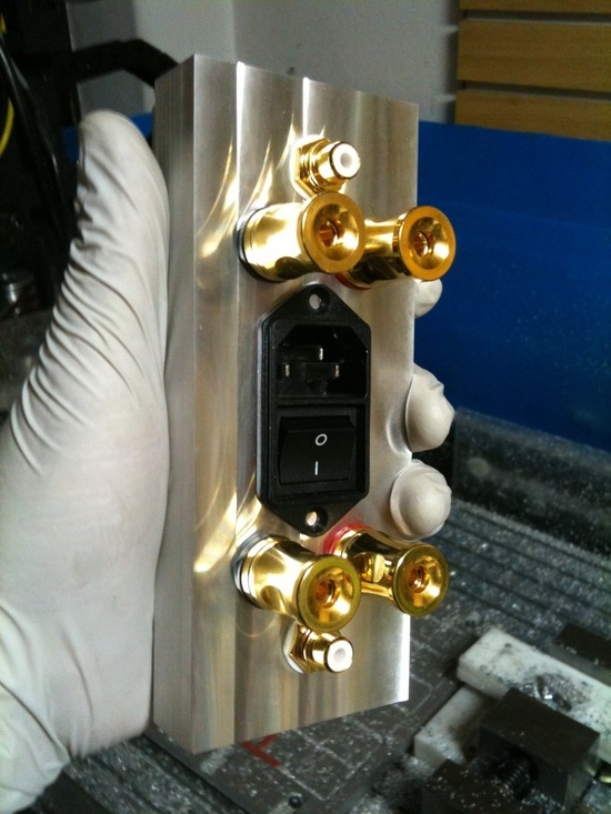

audio output / input AC power rear panel

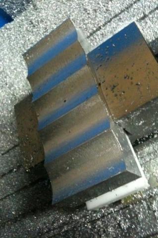

heat sink block
I made it absolute use CNC in my working room.
Streamvox - That is the most attractive chipamp chassis I have ever seen!!!!! Bravo!!
Absolutely beautiful! Did you make it?
TEST PCB
heat sink block
