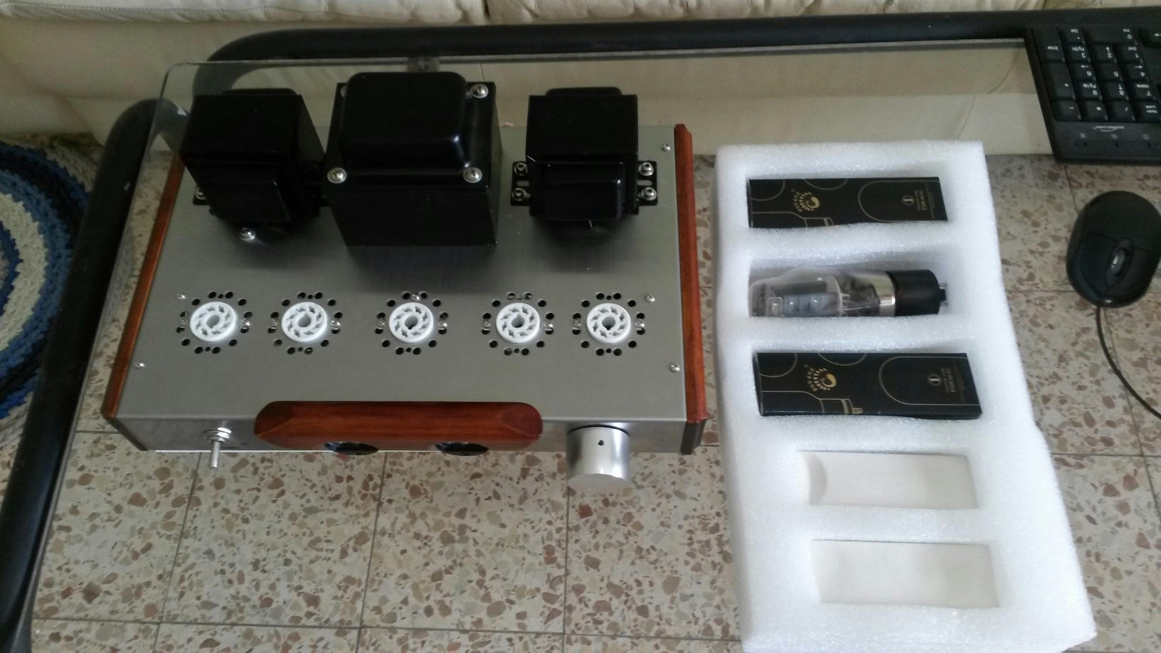

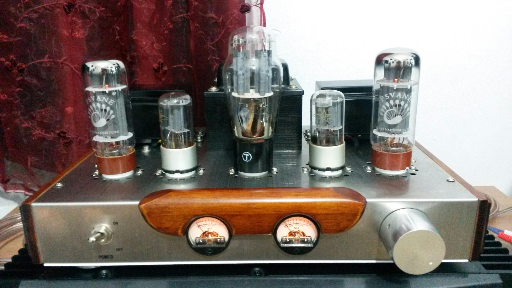

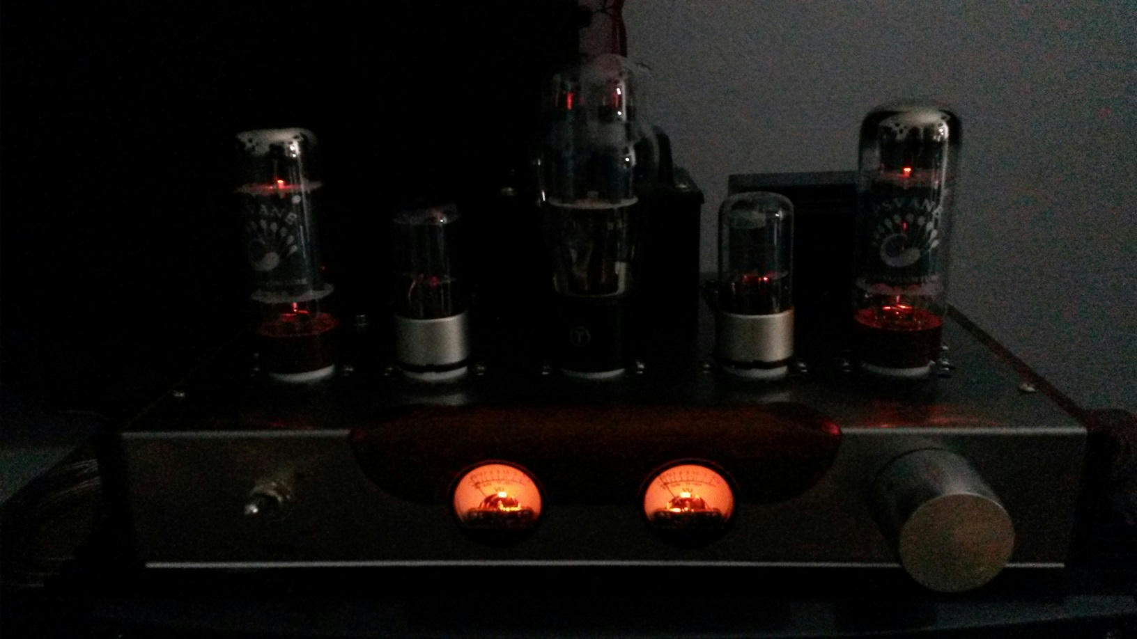

It has arrived!
Photos first talk later:
Okay, this sounds and looks Amazing!
Now for the important part;

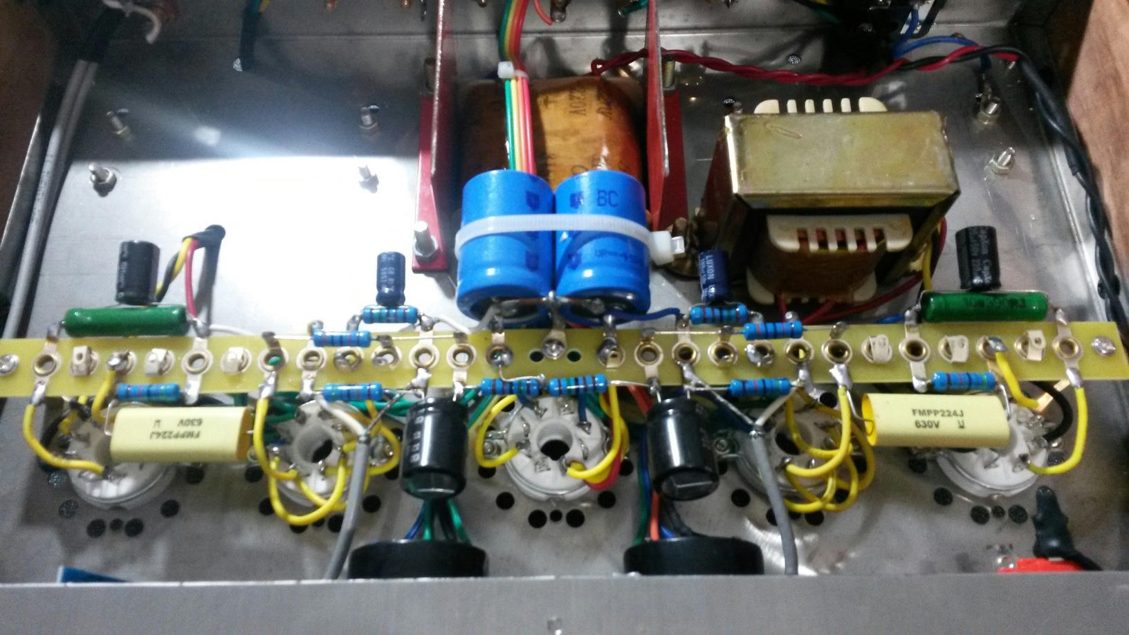

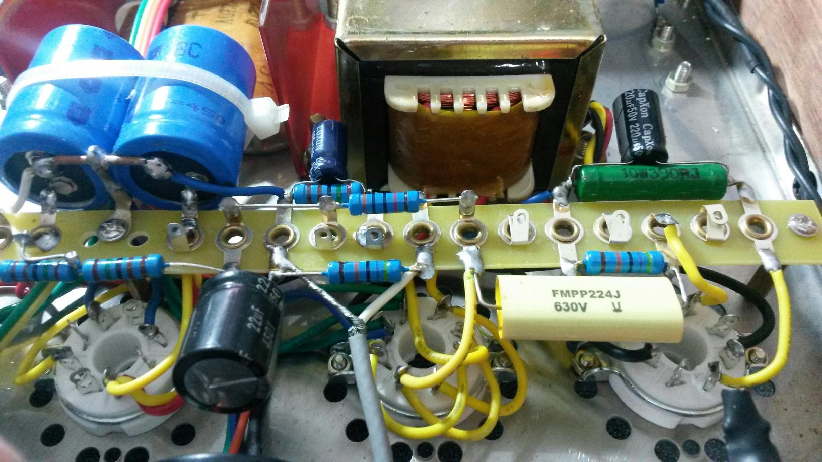

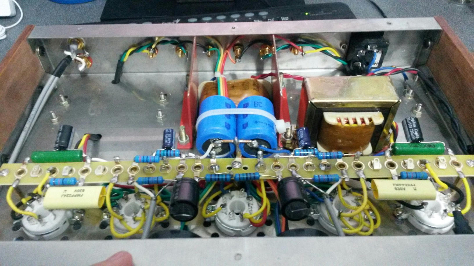

The build quality and soldering job is OUTSTANDING, I am truly amazed! 😱
All the screws and jacks are tight, pot is smooth and balanced, no hum or hiss, properly twisted filament wiring, properly shielded signal leads, hot glue on RCA jacks to prevent twisting, heat shrink, cable ties, proper grounding, transformer weight standoffs.
Man, I don't believe this is actually a Chinese product...😕
Wired as Ultra Linear without negative feedback, no screen resistor either.
Played a sinewave with max volume (quite painful), can't hear a trace of distortion, no buzzing (third) or octave (second), just pure ear piercing sinewave.
I can clearly hear a 0.03% distortion (-70db second & third) simulated in a DAW with a clipped sinewave, but not with this amp.
This means that the THD of this little amp is low enough for my needs.
Written on the power Trfx:
Separate 5VAC for rectifier, TWO 3.15 pairs (wired one for each channel), 300VAC.
Measurements to come...
Measurements and Questions:
300vAC before rectifier tube.
320vDC after rectifier tube on cap.
300*1.414 = 420vDC -> The rectifier drops 100V ???
EL34:
Pin3 (plate) - 290vDC
Pin4 (screen) - 300vDC (higher? *wired as UL).
Over 390 cathode resistor - 21v
Plate to Cathode (3 to 8) - 270vDC
Biasing calculation:
270*(21/390) = 14.7W.
Seems that the amp is biased very cold for Class A?
I will try a SS rectifier and remeasure...
With SSR:
363v after SSR. Still drops a lot.
312V plate to cathode.
24v over 390ohm.
312*(24/390) = 19W.
Got some power back, still well below max plate dissipation.
The SSR stays in.

SSR + Tubes + stable line voltage (230v):
Trafo out - 305vAC
After Rec - 383v
After Choke (into OPT) - 376v
EL34:
Pin3 (plate) - 353v
Pin4 (screen) - 367v
3to8 (plate to cathode) - 327v
Over cathode 390ohm - 26v
6SN7 (wired parallel):
Plate - 203v
grid to cathode - 8.3v (lots of input headroom considering that consumer level is only 0.5vAC Peak, and Pro is 1.7vAC peak).
Bias calc:
327*(26/390) = 22W, 88% of max dissipation.
I'd say it's on the safe side.
It appears that yesterday the line voltage was around 220v (hot summer here) instead of 230v so the whole amp dropped in power.
