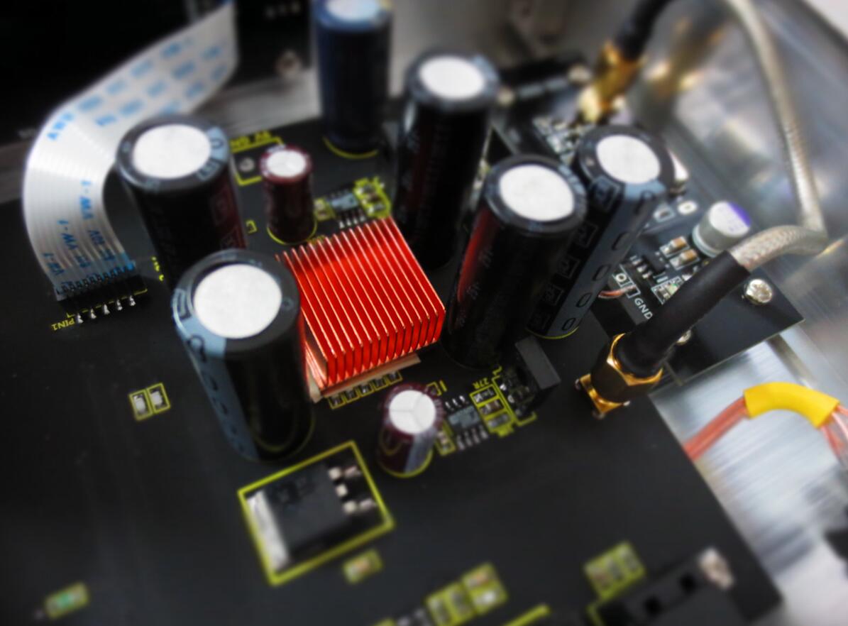

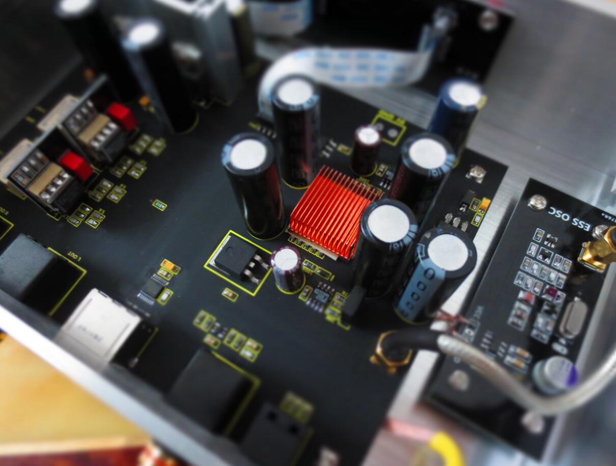

I'm using the cheap eBay es9028 board with a burson v5 opamp to drive a subwoofer as part of my minisharc based digital crossover. I'm working on upgrading the power supply of the cheap board. Would I be better just switching to the diyinhk es9018k2m board?
Subwoofer crossover at ~100hz.
Using minishow0328 es9028pro board to feed valve amp for main speakers.
I have some of the eBay (minishow)boards from the same maker, sound great with some upgrades.
The tiny, filter capacitors that are around the op amps will give a nice improvement, use either Wima FKP2, Siemens KS, or EMZ polystyrene here. These are all pf values, the larger sizes are likely power decoupling. That would be the first thing I would upgrade.
I will also replace the rectifier diodes with fast, soft recovery type also.
These upgrades will allow you to get the most out of the dac and burson combo.
If you aren't handy wth a soldering iron, you may want to practice first on some old circuit board to get a feel for it.
ES9018k2m is so old and have some bug , i use a ES9038pro now ,sounds much better than the 9018
I also have this board. Could you pls. describe what does your mod do exactly?
Where do you power it with what voltage (AC?)?
The main issue regarding SQ of this board might be the DC Elko at the Output in Signal path - anybody a easy mod her?
Thank you!
Best regards
Jörn
He's doing it to be able to run the board from up to 25V power supply voltage, which will help reduce the distortion in the opamp due to low supply voltage. It still does not do anything for the hack output stage though, so BJT input opamps will still sound like poo.
I considered this for a while, but decided to swap in a OPA2134 instead. It performs very well at these ludicrously low supply voltages, and no distortion is noticed even with the (software) volume at maximum and a +v of 11.5V at the input. Opamp runs off 10V, as the multiplier drops 1.5V or so. It also works better with the high impedance seen by the input pins.
I use a 5V-12V isolated converter so that the DAC and a Pi can run off a single 5V 12W charger. There is some CLC filtering on both sides of the converter to minimise the switching noise coupling between the two units. Being isolated means no ground loops are likely to occur.
