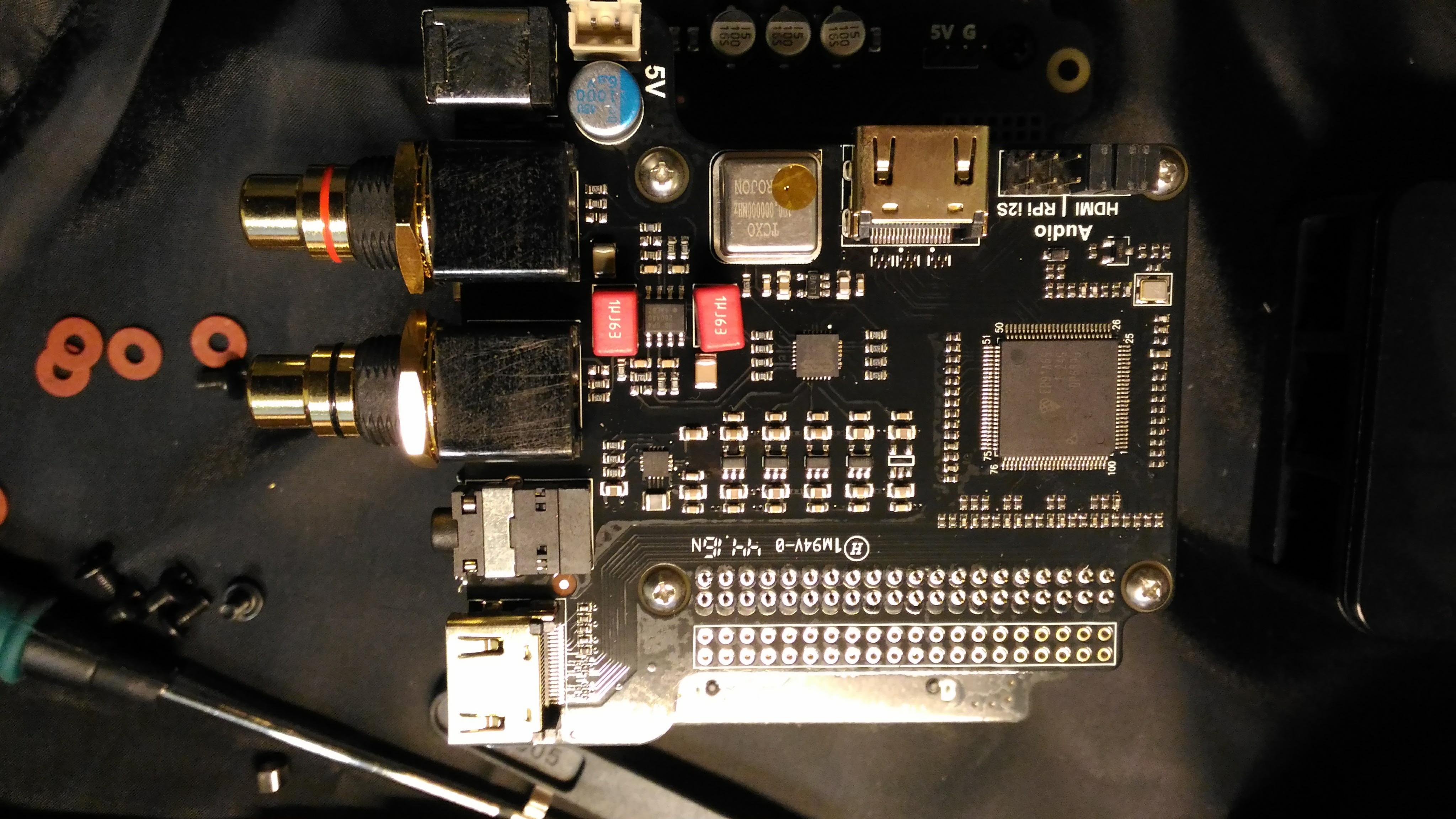

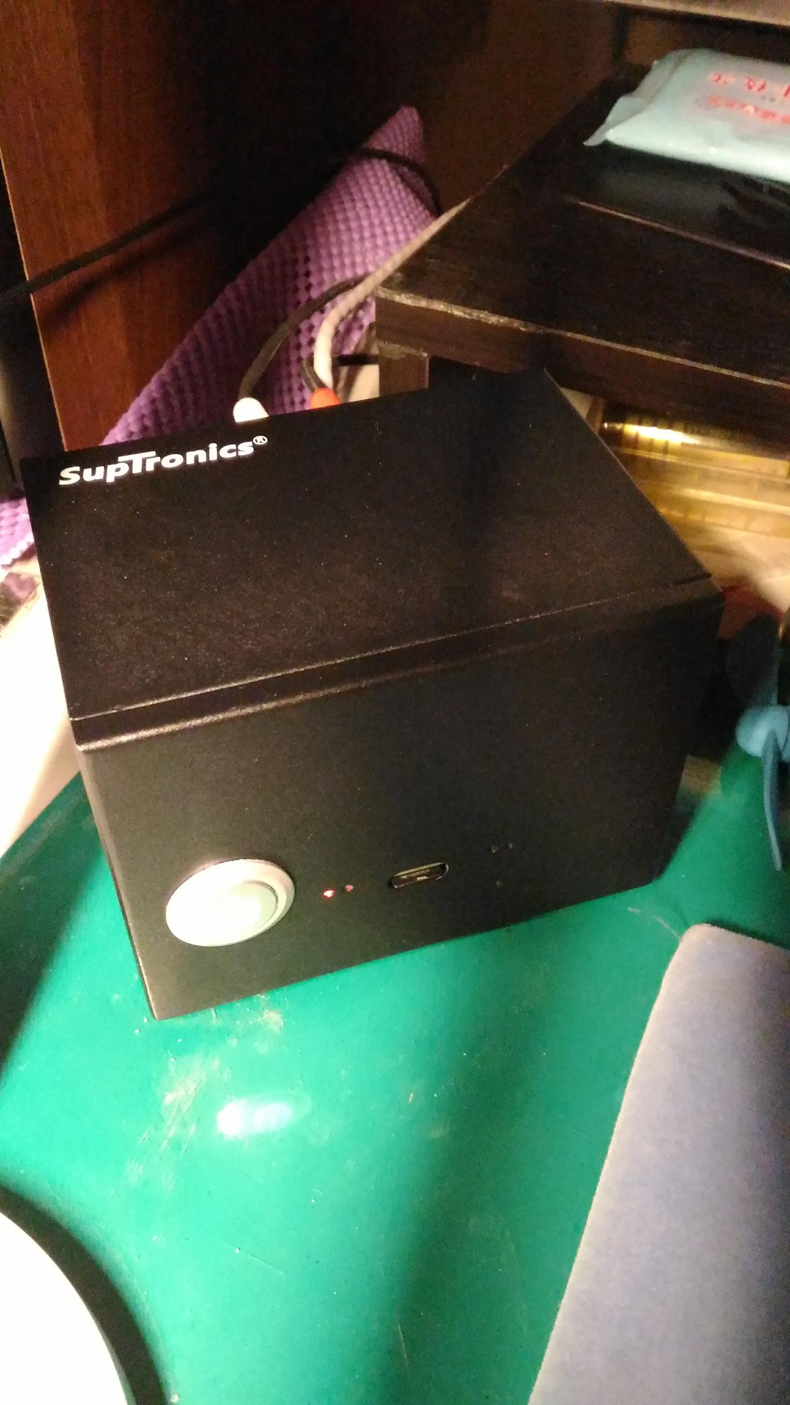

I have receive the suptronics x4000k diy kit and installed last night. Please forget my poor English....
This kit include:
1) Metal Box. It is a tiny box and almost like 3 cigarette box.
2) DAC Board. Use ES9018K2M and can connect raspberry pi by I2S or HDMI I2S. I think the I2S of HDMI is much better than the ones of raspberry pi.
3) 2.5 HD Board. That board use USB port.
4) Power Supple. DC 5V 4A adapter for all kit.
5) Tools. A screwdriver & a tweezers.
That is a useful kit. I have try ES9023/PCM5102/PCM5122, and I do not like the sound. I think that is due to the quality of pi's I2S. Then I try to use to CS8421 with PCM1794 and feel better.
That kit is specially in I2S of HDMI. I am trying it....

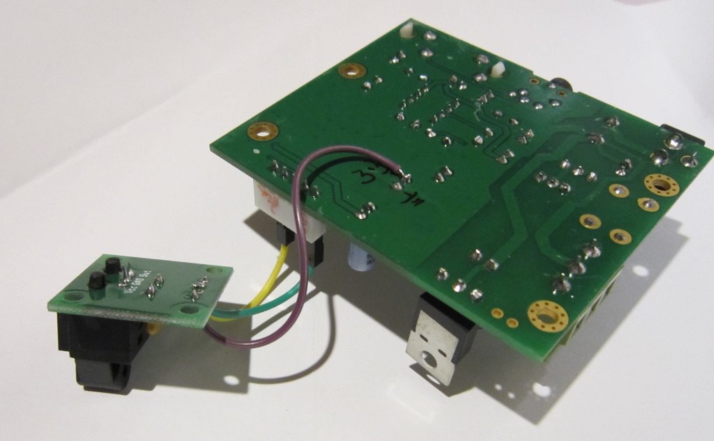

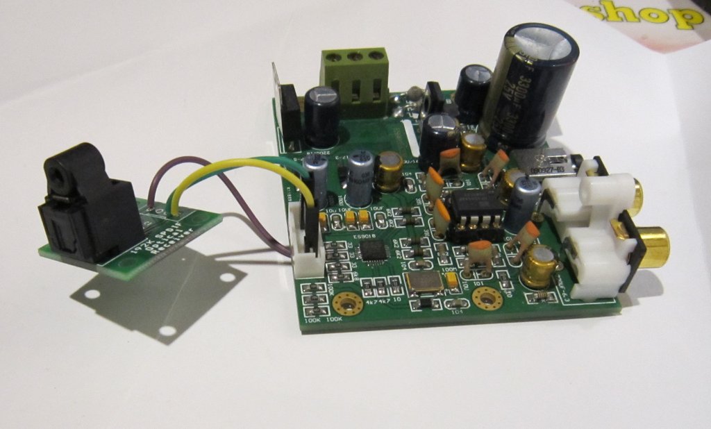

Thought this may be of interest...I bought 2 of these https://www.aliexpress.com/item/201...32727675710.html?spm=2114.13010608.0.0.wBuiAb
as a stop-gap measure while I built the diyinhk version..
ES9018K2M XMOS DSD DXD 384kHz USB DAC with Bit-perfect volume control and SPDIF input - DIYINHK.
Having finished the build I now have the diyinhk unit connected to the xmos previously on the Chinese board.
I didn't want to shell out for another xmos so wondered if the DIYINHK toslink adapter could be added so I could use the original cheapo chinese board as an external card for a laptop or upgrade for a cd transport... and it can 🙂
I followed the advice on the diyinhk page...
and used their adapter...192K Optical SPDIF receiver - DIYINHK

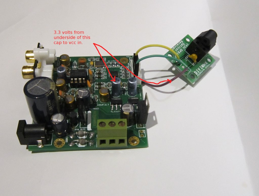

Connected output to pin 2 and ground to pin 5 of the i2s input and ran a wire from under the board from the +ve of the 22uF cap (label on board says 100uF) directly above the TLJ1117-3 3.3v regulator to vcc in of the receiver.
Powers up and works fine running from the optical out of a cd player.

This ES9018K2M DAC can also be used standalone to receive SPDIF directly, the 3.3v SPDIF should be connect to the 20pin header labelled BCK and GND)
Will test tomorrow with a laptop and see how high a sample rate it supports. Diyinhk claim 192/24.

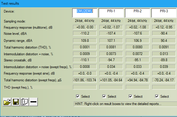

I got a couple of units last night to shake down and see what they can do. The V-I converter uses unusually large resistor values, pointing to a DAC starved of current , as expected for a mobile part. There is quite a bit of variation between the two units in terms of subjective performance, though I might measure them at some point.
The sound is above average for a unit of this price range. I have it running off a Pi in a $11 case, and two separate wall warts for the DAC and Pi. No idle noise and no other overall issues, though as expected it performs better at the top of its range, the soundstage and timbre collapse at the usual -20 to -15dB level. When in a properly gain-staged system, I guess it can easily satisfy any casual user. I did noitce large transients when switching tracks if resampling was enabled in Moode. I assume the buffer size needs to go up a few notches, though there will be a resultant delay in playback. I may yet experiment with that later.

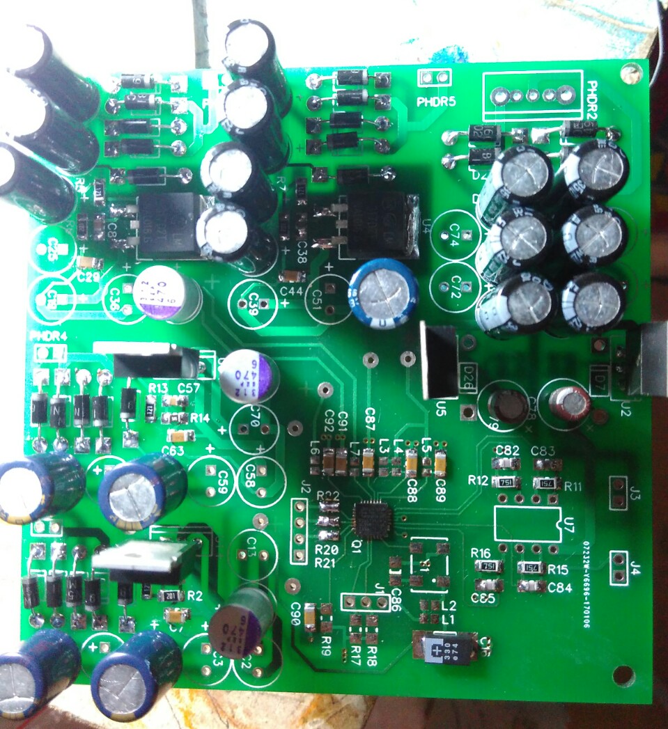

If you could post some high resolution close-ups, it might help us figure it out. The ones on eBay are too small for any meaningful conclusion, which is probably deliberate.

That one?
Yes - that one. The extra component spaces are down at the bottom right of the picture - leds, resistors, and also some switch pads and connector pins.
Forget it.
I have ask the seller and they say these design is for other project, need firmware to enable these function. They do NOT promise these function.
