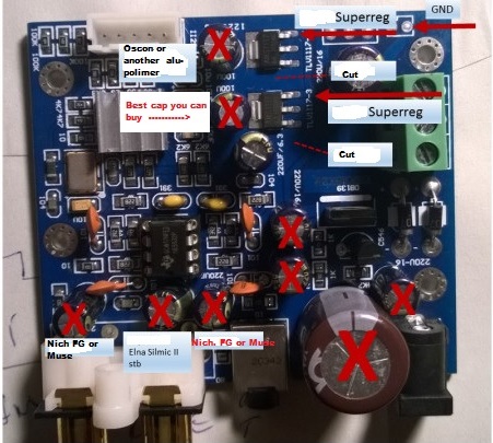

I'm not expert in electronics, but I read a hungarian forum about ES9018 K2M DAC panel, where wrote: The main problem is the common power supply, both for analog and digital stage, if we making a separate supply for analog and two digital stage, the sound will very well. Furthermore need replace few caps, primarily the output caps to Nichicon FG or Muse type, and two 100 uF capacitors in 3,3 V supply, after TL117. One is Oscon or Aluminium-polimer cap, the another is the best cap, what you can buy (Blackgate, Nichicon Muse, Elna Cerafine, etc.)
If the board has potential it would be beneficial to change XO for better (eg. NDK NZ2520SDA). Also maybe change the few cheapest ceramic caps on board for better depending on their purpose in the circuit (film caps or C0G)... And don't bo for Blackgate, nowdays there is more fakes than NOS. Audionote makes Kasei line as most near replacement

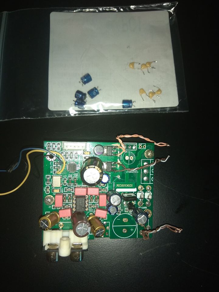

Changed caps.
Sorry, but that's not really what it needs most to sound better.
Changed caps.
After opamp: Nichicon Fine Gold, after 3,3 V stabs Oscon SEPC and Nichicon Muse, opamp's power supply: Elna Silmic II, around opamp: WIMA.
You will get much more obvious sound quality improvement with changing that generic JRC op-amp. Usually, people solder the op socket for an easy opamp rolling.

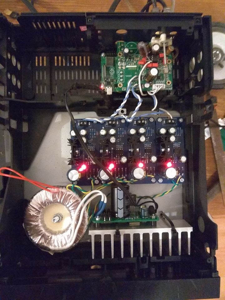

Do you mean 4 extra power supplies (Salas' boards)?

The 4 extra board is based on Walt Jung's Superreg (2x12V for opamp and 2x7 volt for 3,3 V regulators).

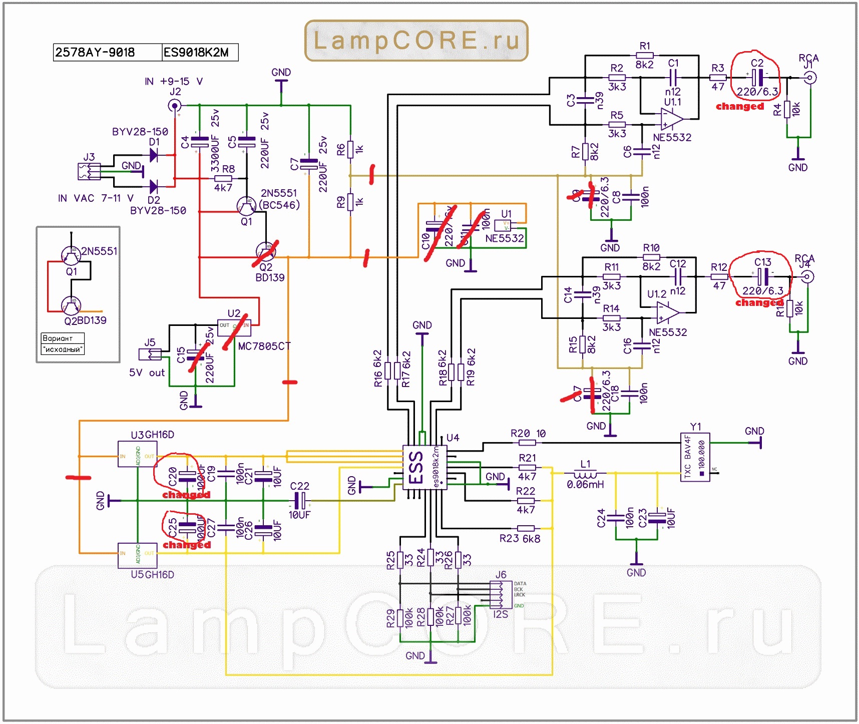

Changed components in DAC panel:
Changed caps.
few unnecessary capacitor and the BD139 removed, the 220 uF/6,3 volt caps in opamp's power supply jumpered.
Opamp's 4. leg: -12V with Silmic 220uf/25V and Wima 100n caps
Opamp's 8. leg:+12V with Silmic 220uf/25V and Wima 100n caps

Currently I spend for complete DAC a little bit more of 1/4 price of Buffalo without transformer and analog stage.

On the hungaryan diy audio forum tried this, but the DAC's output have 1,65 volts, need a servo disable this.
The dac's output is supposed to be centered around +1.65v. The DC offset can be removed in various ways, a servo is not required. ESS has a paper on recommended output stages, and on AVCC voltage regulation at: http://www.esstech.com/files/4514/4095/4306/Application_Note_Component_Selection_and_PCB_Layout.pdf
One way to remove the DC offset ESS doesn't describe but that works is to lower Vref for I/V opamps to less than AVCC/2 volts until the I/V output is centered around 0v.
