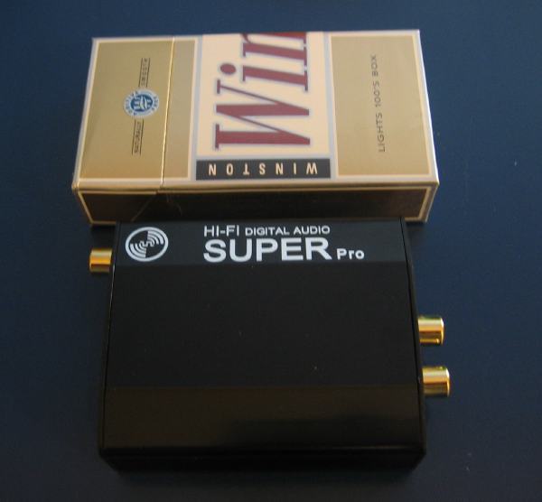

I picked up one of these from Mr. Wu as well. I must say that I was impressed that I got so much for my money - and quickly too! The size appears to be a little larger than the green box that everyone here has - see attached pic.
After a few days of deciding wether I should buy an SLA battery or build a 12V supply, I decided that the battery was too expensive.
I built a little supply using parts that I sitting around (though I had to buy an LM7812). Here are some noise measurements with the switching wall-wart:
12.6V no load
Outputs muted .127mv (switching noise was clearly visible on the scope)
Outputs enabled 7.5mv
With the 12V supply:
11.8V no load & loaded
Outputs muted .026mv
Outputs enabled 3.3mv
I measured 6mv DC offset, .04% THD @ 1kHz 0dBFS. Full scale output was around 1.8V @ 1kHz with either supply. These cannot be regarded a perfect measurements because my Boonton 1120 was a basket case and has not been calibrated since 1996. I also used iTunes to do this via an Apple Airport Express w/ toslink.

Mine is as small as the previous have shown 2.5" x 1.75" x .75"
On mine, the 1364 OPAMP came unsoldered to the PCB - it is removable - so now just wondering what would be a good drop in replacement for the 1364?
I plan on trying another power supply the existing 12VDC 1A wallwart was a bit harsh on the high frequencies. Still liked it tho...
