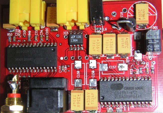

Hello Everybody
After first positive feedbacks in here about this little DAC I thought I’ll give it a try.
It arrived (in Switzerland) two days after ordering.
First listening impression were very positive, my “Noxon” (network audio player / Terratec) sounded much better with this green little box than through its original analogue outputs.
Anyway, I turned the volume a little over normal listening levels without any digital input signal, just to see whether this DAC really operates quiet or there may be any noise or hiss.
Then, the disaster happened: Both the ribbon tweeters went up in smoke. As you can imagine I really feel more than fooled.
The problem seems to be an oscillating opamp. The multimeter shows around 4 volts AC from analogue output to ground, on both left and right channel. I don’t have an oscilloscope so that’s all I can say right now.
What’s next: I think I’ll try to reverse engineer the DAC or at least its output stage, hopefully this will bring some more insights.
I wonder if other people’s DACs have similar problems or work flawless.

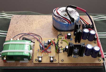

Stripboard and HT.
Hi Franz,
Stripboard with copper can't hold up much voltage. My very beautiful AM transmitter with sub.min. tubes died that way. If you use a board without copper it will be fine. So my guess is that the stripboard is the culpit.
Also I used a selenrectifier, guess what happend when the RF amp tube shorted out...
Got rid of that hum?
Yes, now I did get rid of it 🙂
The reason was some oscillation. I removed the filter caps C1 and C2 I inserted according to the last schematic in John Broskies blog 75 (Balanced DAC & Filtered Broskie Cathode Follower).
John Broskies Blog 75
Actually I am driving the DAC without filtering. It sounds great but I still miss some dynamics and I have the impression, to have some lowpass "filter" somewhere in the circuit.

It took a while to get my AC-voltage problem fixed - but it’s finally done.
Removing the four small SMD Caps in the output stage located on the bottom side of the board solved the problem.
I’ve e-mailed Eddie Wu about this issue. He told me it was the first time something like that happened and my purchase wouldn’t be charged.
Yesterday I’ve added an external output stage (a simple op amp based differential amplifier, +/- 12V supply). Although I first intended to keep everything inside the tiny little box I thought it might be better to redesign the analog section to get rid of the coupling capacitors. Well, first listening impressions confirmed that it’s been a worthwhile modification. 🙂
I'll do some serious listening tests next days ...
Regards, Mario

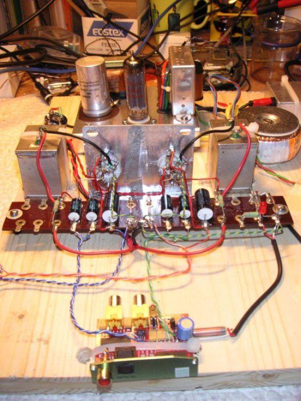

Hi Mario
Very good news! We should compare our two breadboards in a listening test, as we don't live to far from together!
My broskie cathode follower version is working now perfectly!
I made a silly mistake and inverted the right channel, resulting in some cancellation effects.
Here I attach the corrected view.
Franz
/Edit: I used for the picture the same filename as in post #15, replacing the wrong picture.
