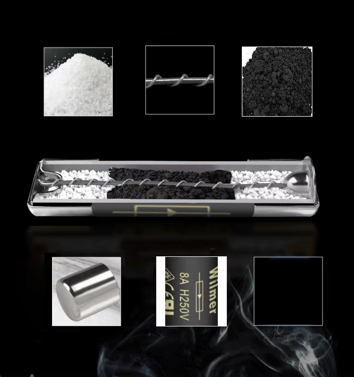

It used to cost only 2 cents for an opinion, and now it's 5 cents??? Damm inflation.just a quick 5 cents from me....
tried the red ones from China (can't remember the name)....
