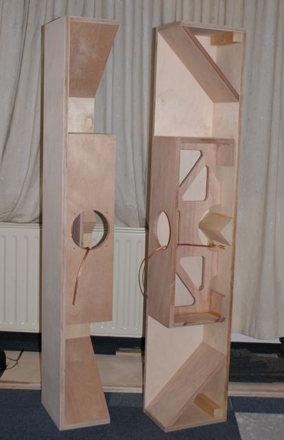

some questions about the chili changs build
Phil, I hope you're ok with me posting some questions in your thread, if not let me know and I will move it to a new thread.
Your Chili's look great!! I realy like the green, same color as my amplifier.

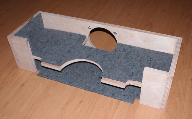

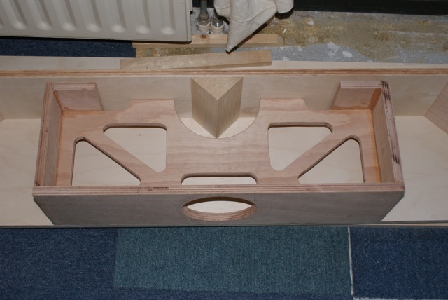

I am also building a the moment the chili's for the fe167e and am a bit uncertain about the triangle in the back and the damping.
- The triangle in the back is approx the size of the triangle in the pdf plan from the frugal-horn site. But ...... now it looks so big. Will it not take too much volume? I could just cut it in half.
- I tried to read as much as possible in a lot of threads about the damping but could not find a conclusive answer (perhaps there is none...) I read somewhere that I should put wool felt on the back, top and one side in the driver-box and on both sides of the brace, and make sure I leave the vents clear. But also for instance in this thread that damping was removed because it did not sound ok. Any advice on a stating point for the damping? How can I tell if it sounds ok, should I use samples of a specific frequency or... help!!
I attached a small photo so you can see the triangle. (the speaker-box and triangle are not yet attached, just lied them in for the photo.
Thanks a lot in advance.
Jeroen

Re: some questions about the chili changs build
JeroenR said:
Phil, I hope you're ok with me posting some questions in your thread - Jeroen
Hi Jeroen - keep posting, the more the merrier and yes please add more pics. Dave's answered your questions.
As you can see in my constructions pics - http://www.greenie512.net/greenie512/html/wip.html I didn't bother with a triangle but put a flat piece in instead. Also this link has comments on my experience with dampening.
Cheers - Phil
JC951t said:
Hi Jereon
Glueing the felt might make the speaker sound dry.
No full range experience but from previous speaker
tweaks, this is what I'd observed.
Hmmm, I was planning to use glue... :xeye:
I could use just a few blobs but am afraid it might start "flapping" when playing music.
What method would be best to attch the cotton felt (=in my case cheap undercarpet that is only partly cotton)
Thanks,
Jeroen
planet10 said:
We use dabs of hot glue to attach the damping...
Also, there was no meed to cut away the half circle at the back, buit it should be non-critical.
dave
I will buy a glue gun tomorrow.
The half circle at the back will partly have the triangle. Cutting it along the circle just looked neat. 🙂
Jeroen
