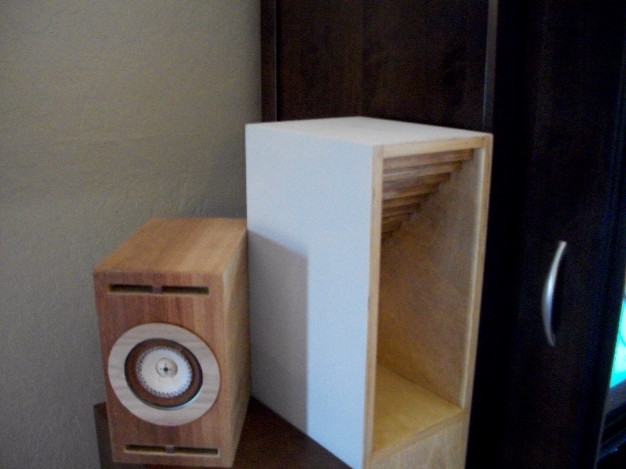

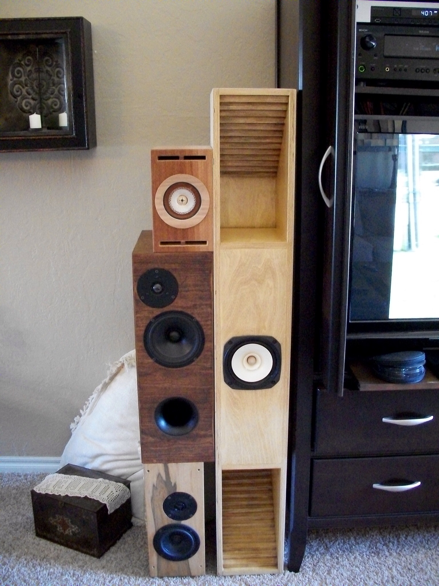

Pictures
Here are a couple of pics I have readily available.
The speakers to the left are, from top to bottom:
A Mini Fonken type using some vintage Fostex 10F3 drivers...will likely sell these soon too.
A pair of custom Vifa P17WJ / Morel MDT33 monitors tuned to 40hZ, XO's designed by Dave Thomas (thanks Dave!)
A pair of Madisound RB1 first edition in custom enclosures.
jeff
