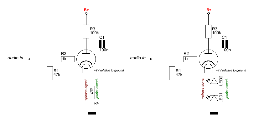

Biasing with a LED is setting the voltage between cathode and grid to the Vf of the LED.
The quiescent anode/cathode current results from the B+ volts and anode load resistance, at the grid volts set by the LED.
The Cathode resistor isn't needed with LED, the resistance of the cathode may well change some with LED bias, I dont know

Your LEFT drawing, won't work, period.
Your RIGHT drawing, is … curious … and presents a 24 kΩ load to the source. IF that is what you want, then its fine.

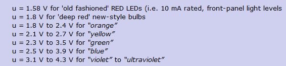

The 'point' of an LED bias (in series with cathode) is that it raises the cathode voltage by a surprisingly-near-constant amount regardless of the input signal. From the cathode-grid-anode perspective of a valve, it “feels like” the grid has been dropped (made more negative) compared to the cathode. The VA-K voltage is diminished a little bit by the string of LEDs in the cathode series arrangement.

And as A3sUMMER sez… you can use a string of ordinary diodes, rectifiers, an appropriately sized Zener, … etc …
However, do note that the use of a chain-of-ordinary-diodes has the distinct disadvantage of summing all of their temperature-variation dependencies. Turns out not to be very much in practice for cathode-string bias situations, but for more demanding service, only modestly-low voltage Zeners are tuned to have “zero tempco”¹;

Not so fast Goat 😉
The interesting part here might be in the explication why the left drawing won't work. I see a network with low impedance to ground, forming a high loss for the audio signal. But what exactly happens to the audio signal? Does it get rectified by the LED, so positive phase runs through LED3+4 to ground and negative phase through LED1+2 plus bat1?
The reason I try to understand the exact working is with the existance of negative feedback in the unbypassed cathode circuit. If we consider the audio signal here, a form of rectification* would occur with LEDs. From the bigger power supply example we know that interelectrode capacitance plays a role. How would that translate to the fidelity of the signal taken from the anode? As you set me straight Rk is in series with ra for output impedance, the added difference being u+1 times Rk.
