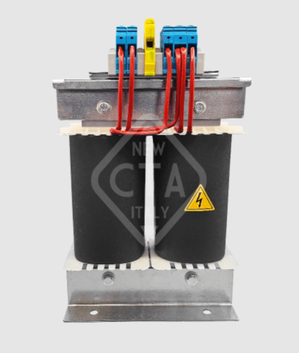

I have some about 50 years old amps in the garage Nothing special at all I got them for little money
Speaking of restoration i would replace all smaller caps with new ones, check transistors for short circuits and remove and check the big ones caps in the power supply But 50 years are half a century I am not a collectionist so for me performance is more important than original parts for sure
To save some money i am very interested in understanding of to check industrail caps The big ones of course
I remember at least a very nice amp called Unison Research Unico using industrial caps with great results At least on the basis of the review
I believe in industrial parts also for mains transformers for instance I love things like this one here depicted immensely
