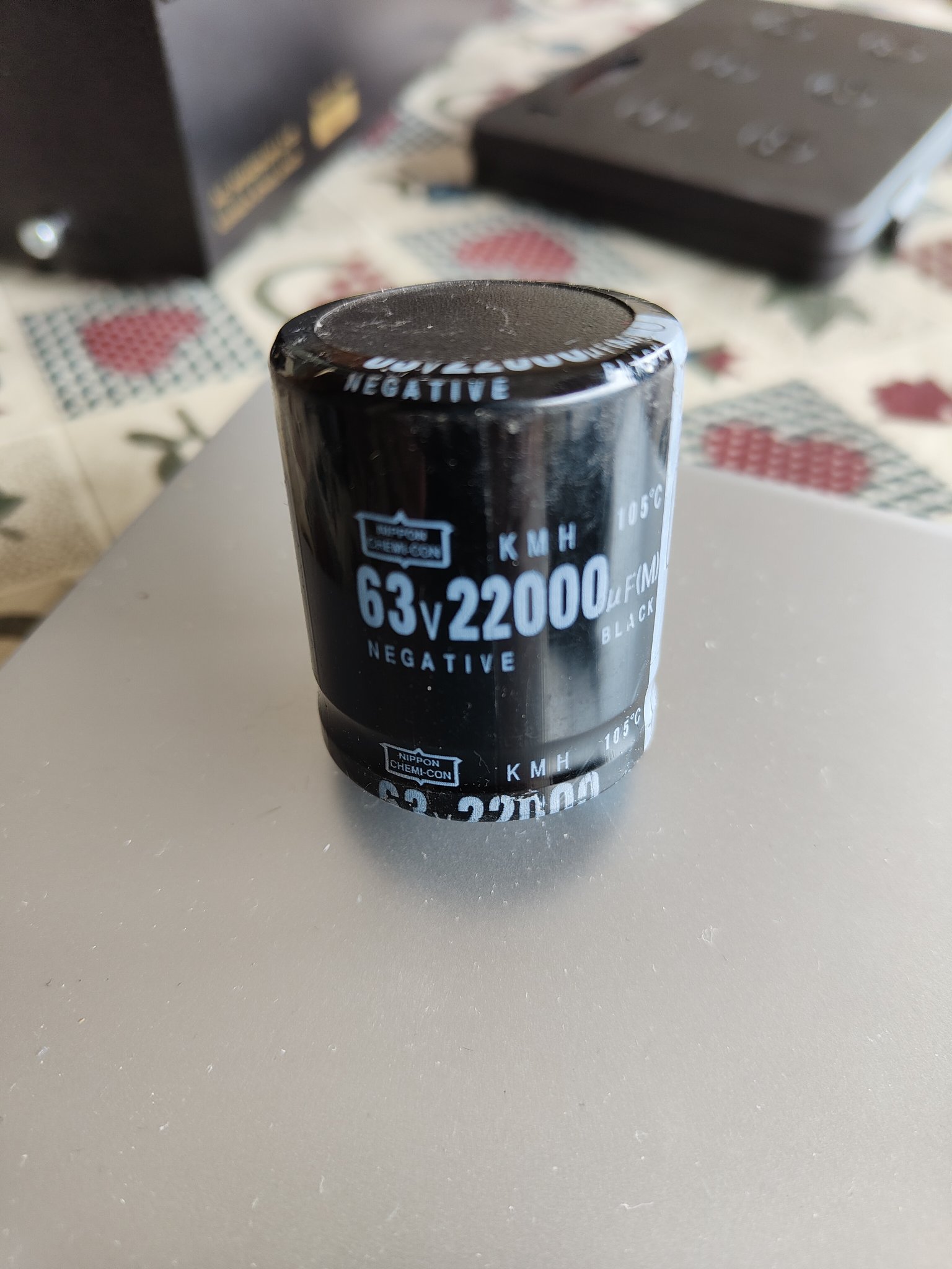

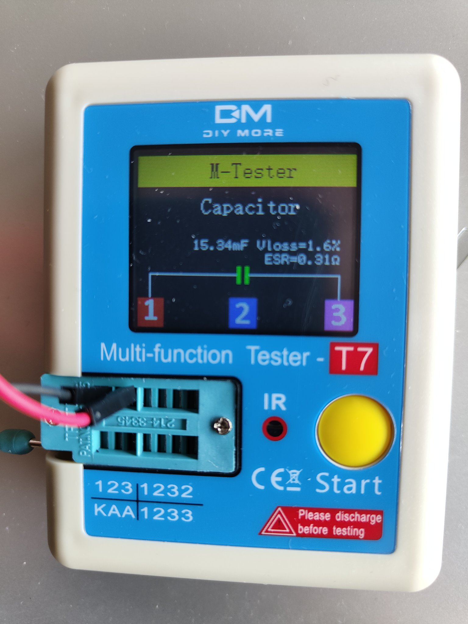

Hi ! i am testing caps i have at hand with this meter
some caps rated 22mF measure around 17mF
i wonder if i can still use them without issues
Other NOS caps instead measure accordingly with their rating

I think you should avoid those caps which are reading less than the value written on them. Specially if you are working on an Amplifier.
Hi thank you very much I will look for a esr meter thenReduction in capacitance from original value is not a good sign.
Wet electrolyte capacitors are subject to slow deterioration caused by gradual evaporation of the electrolyte inside.
The result is that capacitance decreases over time, while ESR increases over time.

Keep in mind: Most manufacturers specify for +/- 20% in capacity when new. Try a bit of reforming, the minimum nominal value is not that far off. Also keep in mind - these 10,- meters are great, but very small and very large value are not accurately measured...

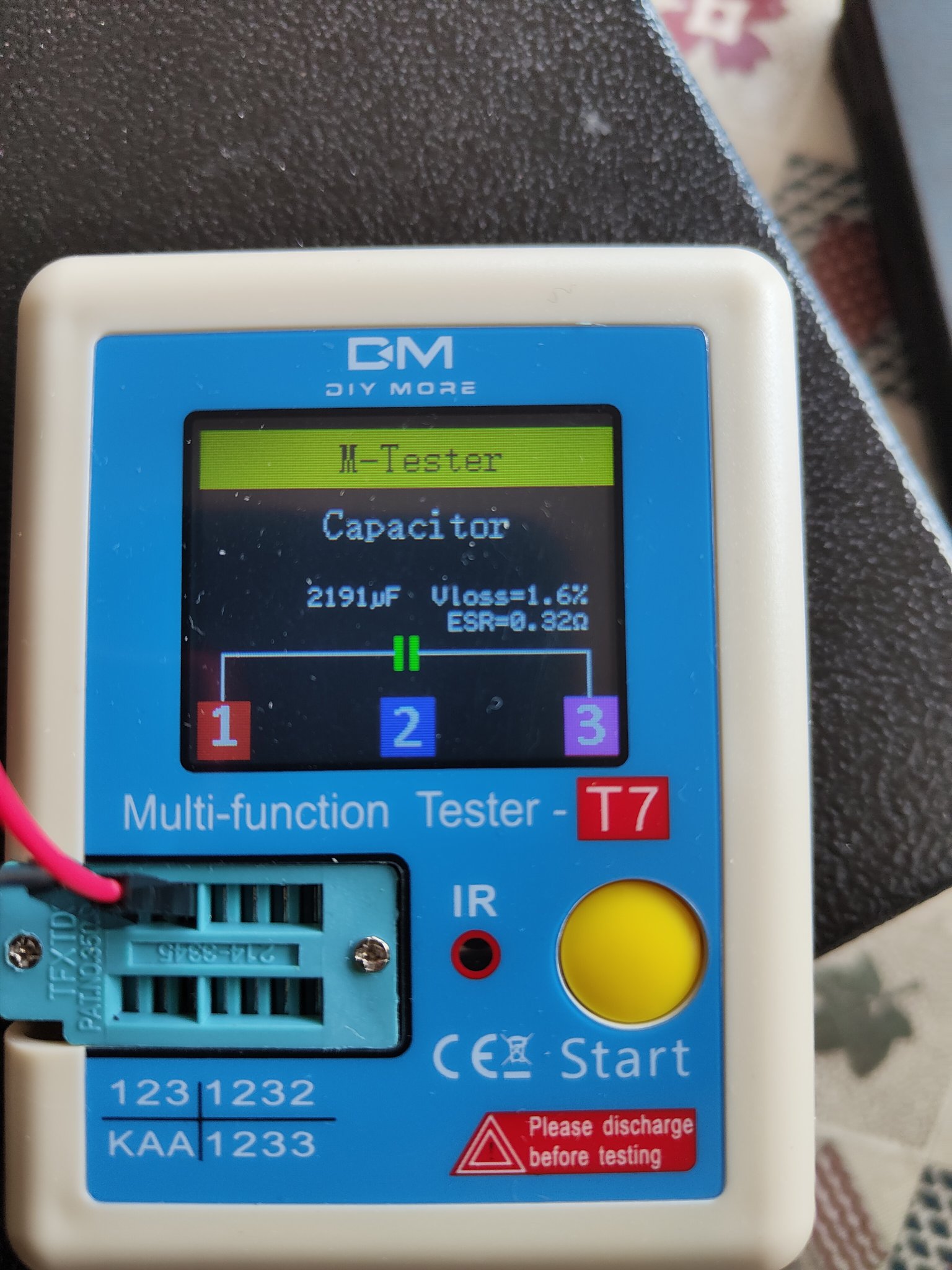

Everything reads above 0.3 Ohm ESR. I think you are reading the test lead resistance or the tester doesn't measure ESR accurately. What test frequency does the meter apply to the capacitor?
Regarding measuring 15000 on the 22000 capacitor, verify the tester is accurate before discarding the capacitor. It isn't easy to measure very large capacitance with these cheap digital meters.
Hi thank you for your very valuable advice I have no clue really I bought this thing after seeing a video on Youtube and read some reviewsEverything reads above 0.3 Ohm ESR. I think you are reading the test lead resistance or the tester doesn't measure ESR accurately. What test frequency does the meter apply to the capacitor?

The measured capacitance is more or less the same that i read using the meter at the beginning of this thread Not much of a difference
