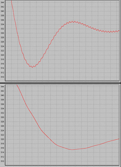

Poo. Thanks for the advice, but the power supply I ended up with above simulates very, very well, and I will be using it. I am using Solen for the 100 uF values, and two in parallel for the 200uF value. Power supply w/o caps is costing me around $550.. Not bad.
Anyway, what I am really wondering is if the Tango NC-14 is suitable for this circuit? It has an Rp=5K and handles 30 mA.
Thanks,
Aaron

aaron,
I'm not suggesting you skimp, or build a "cheap" amplifier, or compromise in any way. That would be absurd. I'm merely suggesting you use the right tool for the job. There is no prize for building the most expensive amp, and money does not gaurantee good sound - although you seem to be equating the two.
I was just trying to help offer a viable alternative. And I think $550 for a SET power supply is a lot of money. Sorry if pointing that out annoyed you. :no:
Finally, I would just add that I have PSUD installed on my computer - and it does not perfectly model reality.

Well, this whole tube amp DIY thing for me started out with the Baby Ongaku, and it was Gordon Rankin who sent me the initial power supply schematic with two chokes, and I trust his ears 🙂
The total is costing far too much, but I think it's worth it..
Power supply $550 (Tango MX-175, LC-10-200, LC-15-150)
Interstages $264 (Tango NC-14)
Capacitors $180 (all Solen)
Resistors $50 (Audio Note)
Tubes $200 (6900 pr, Sovtek 2A3, Mullard 5AR4)
Output Trannys $600 (Tribute amorphous)
around $2k for the project. :-( .. But alot of the cost is getting some of those components from Japan, for instance, the power supply is only really US $380.

No complaints with the Tango NC-14?
Here are the simulation of my PSU (bottom) versus Joels (top). I do believe mine is worth the extra money.
Please keep in mind the following qoute from Joel: "Finally, I would just add that I have PSUD installed on my computer - and it does not perfectly model reality." .. Obviously this is true, but the differences are large enough that even a significant margin of error on the part of the simulation can be overlooked.
Finally, Joel, I wasn't annoyed, no worries 🙂
