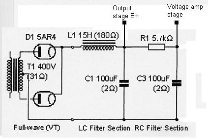

Sonically, 5AR4 or 5U4GB as the rectifier? I seem to find that 5U4 is directly heated, and 5AR is indirectly, isn't directly heated supposed to be sonically better? I can use either with the transformer..
Power supply is rectifier into 15H choke, 10uf cap into 10H choke, 200uf cap for the B+

All you will accomplish by doing this is making a less effective filter.
Maximum filtering is obtained by using identical LC or RC stages, and basically any more than two isn't going to accomplish much (or enough to justify the expense), except put additional strain on your power transformer as it tries to keep all that capacitance charged up. The math to justify that statement can be found in the Radiotron manual.
Any ringing in this circuit would be caused by the transformers, and motorboating is a non issue with only a single voltage amplifier per stage.
You only get motorboating when three or more stages couple through a common supply.
I would remove everything after the second 100MF cap.

What, like the circuit?Joel said:I would remove everything after the second 100MF cap.

Just a bit, more tongue in cheek than anything. As you posted, after the second cap there is really only the circuit in the first PSU layout
With a good shunt reg, I would say the second stage is unneccessary, but in an unregulated SE amp, the second LC stage would be of benefit sonically. I can hear the improvement in a good PP diff amp, so in a SE, which is about two orders of magnitude more sensitive to PSU irregularities I would expect it to be even more audible. Providing the capacitors are of good quality, and the PSU can charge them quickly enough, why would it be overkill?Joel said:Sorry, I should have been more clear.
To spite my "identical filters" statement above, I think this PS would do the job. 2nd choke is overkill, as is 300MF of cap.
Brett said:Providing the capacitors are of good quality, and the PSU can charge them quickly enough, why would it be overkill?
See my comment in my 71A post to fdegrove. This is a class A single ended amp - you don't need a reulated power supply. Yes, you would hear a difference (maybe) in a PP amp.
And, last time I checked chokes and big caps cost money ($100 for a 100MF Black Gate???, etc.) - so why spend the money if he doesn't have to? A very simple PS in this amp will be quite effective.
I disagree with all of what you posted here. A SE amp is FAR more sensitive to PSU, than an equivalent Class A PP amp, especially one with a differential topology. If any sort of amp <i>needs</i> a good shunt reg, it's a SET.Joel said:

I don't use BG caps, thay sound awful, PP in oil motor runs are far cheaper and better sounding. As to cost of chokes, good quality surplus can be found easily and cheaply on eBay.

Hi Joel,
Man, you type faster then I can read.
I must say that I still have to see a tube design that didn't benefit from separate HT rails and good regulation,be that PP,SE
or preamp.
No matter the wattage of amp and even in Class A1.
To give an example of what most people would call overkill:
I use a phono preamp where every stage has its' own transformer for B+ and heaters.
It has a very good shunt reg per stage,decoupled with 660 mF/300VDC.
(don't care about he Joule content but I'm sure the figures are impressive)
If you take the basic circuitry and just give it a textbook PSU it doesn't come close sonically.
It is still miles ahead of any competition since 1986.

Brett, I was not talking about hum filtering, only regulation. They are not the same thing. A class A power output stage does not require a high level of regulation - it does not have the current swing. It is not going to suck down your PS at full load (assuming you have enough capacitance, and can charge it) A push-pull AB stage, having a greatly varying current demand, benefits from regulation (chokes). Are you going to disagree with that statement?
Hum: yes, single-ended amps do not cancel out power supply noise like a PP amp - but, as I said before, 200MF is more than enough to drop the ripple to a couple millivolts.
Fedgrove - yes, I suppose you could put 100 punds of iron, and 20,000MF of capacitance in a powersupply also - but I don't see why you would waste your time and money. I'm not condeming you, just saying I don't choose to build that way, and I don't think my amps are sonically deficient.
