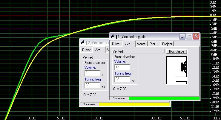

meaured (courtesy of Zaph) vs claimed parameters :
Fs=30.95 hz 26
Qms=12.2863 14
Qes=0.2365 0.22
Qts=0.2320 0.22
Vas=23.88 l 30.5
SPL=86.59 1w/1m 87
Re=3.4 3.4
Le=2.42 2.47
BL=13.15 13
Xmax=16mm P-P 16
Using measured parameters I get the following (good shape for room gain):
10L with 32Hz vent tuning looks ideal to me.
(P.S. don't worry about the 2dB down at 100Hz, only affects efficiency)
🙂/sreten.

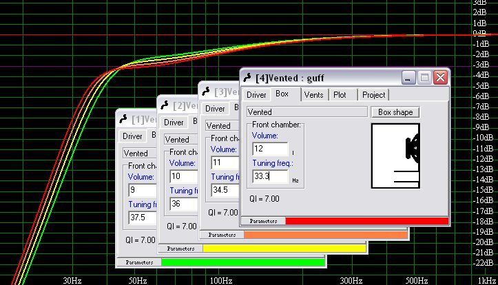

if the complications of accurate port tuning and sizing in small boxes
seems to be too complicated then I suggest the passive radiator.
(winISDPro gives 40L as the Vas of the passive radiator)
Following are my quick sims of the response, which you
should independently verify. 9/10L looks good to me.
Would be best to get someone to verify in another simulator, e.g. Unibox.
🙂/sreten.

32ft/s = ~ 10m/s.
in WinISD Pro 10L box tuned to 38Hz, 34mm O by 160mm long port :
for 150W I get max port velocity = 96m/s (320ft/s) at 34Hz.
To peak at 11m/s you need a port 10cm in diameter and 1.5m long.
🙂/sreten.
