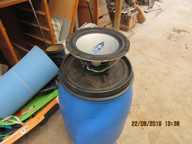

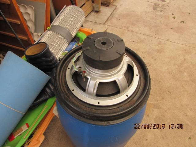

I get a kick out of low cost/zero cost projects like these.
I even cut the hole without using any tools except a scrap of wood and two nails, although I did sharpen one nail so it would cut. The box terminals I rescued from a cheap parts bin when Tandy/RadioShack closed the doors here in Oz, I probably paid a dollar. Foam was an old camping mattress destined for the tip as was the scraps of fibreglass in the old pillowcase

Pictures of the "work" so far.

I know it's been a while but yesterday I finally got around to hooking this roadkill project up to an amp.
Party set-up is now via an older Rotel multi channel amp with only 40 watts per channel but that is enough to provide a decent basement for the tops I've been using for ages.
Good enough for party use and I have to say that these blue plastic barrels actually make reasonable enclosures; I think the foam roll has helped there but I don't have any complaints about SQ even if it were inside the house.
WAF would be extremely low.
I haven't made a frame for them, I just set up the barrel facing up in the open air. I have another sub also used for parties. The old Kicker EX154 I made about 12 years ago is still going strong.
Using an old Behring CX 2310 crossover before the old Rotel RMB 1048
