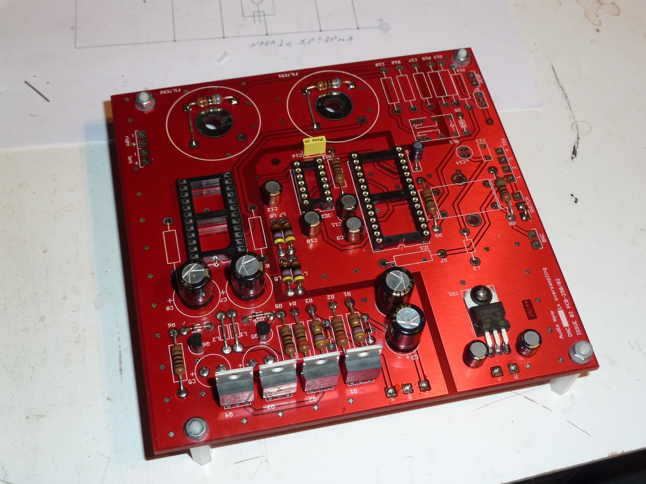

Look at this:
I don't suppose it has any better grounding than that in Audio Note DAC 1.1x.
The power supply is also very primitive, only three ugly regulators 7805/7905.
With this simple PCB I achieved very good sound with passive I/V conversion and simple tube gain stage, no analogue filtering at all. Hardly played with this PCB. The signal capacitors at the output of tube stage makes HUGE difference in sound quality. Also the resistors in I/V conversion makes big difference. The type of regulators and capacitors in power supply makes very little difference, or even no difference at all. The rectifier type makes significant difference and SBYV27 I found best.
So, in general, I dissagree the grounding issue could do so big havoc in sound of AN DAC1.1x and I persist in that the poor analogue filtering was a cause.
I stumbled across this thread and wanted to add something regarding digital grounding issues. After more than 10 years of fighting this problem in my DIY DACs (15 different DACs) I realized that digital and analog grounding is most important in these circuits. Proper layout is at the second place. Parts used are at 3rd.
Luckily I grabbed a chance and bought myself Audio Note DAC digital board as they use in DAC 4.1 and DAC 5. That is some serious PCB engineering with two ground planes (analog and digital) on each side of the board connected only with a thin piece of wire. All other things (I/V transformers, analog line stage, wires, tubes...) aside this is the best sounding DA converter board ever made. I experimented a lot and compared this one to a lots of others and any other design can't beat it.
Hope this helps in your future designs...
