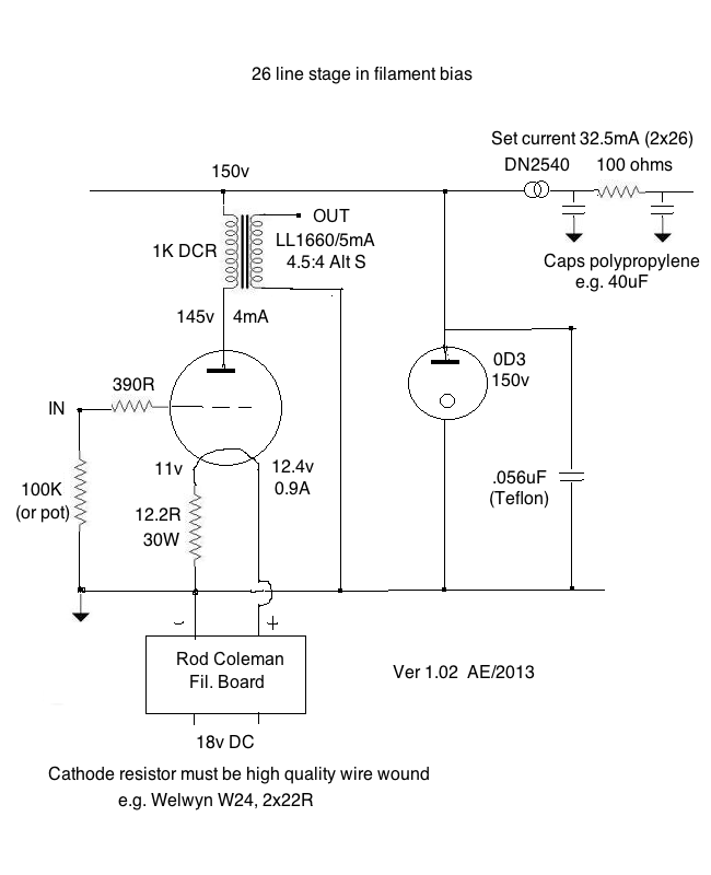

I have a RAKK DAC version 1 which uses PCM1794. I have 75 ohm resistors for the i/v and take a SE output straight into the grid of my line stage. The line stage is a 26 DHT in filament bias which is just about the best sound you can get. Less amplification factor (8) then the usual tubes like ECC88, but much better sound.
I'd be interested in any other DAC boards that could replace my RAKK ver 1. I'd like more output - I get about 0.5v out right now after the i/o resistors. I could use an ES9023 and that sounded very good in my system when I borrowed one.
That would be a solution I'd recommend.
I use USB input out of my Mac Mini.
